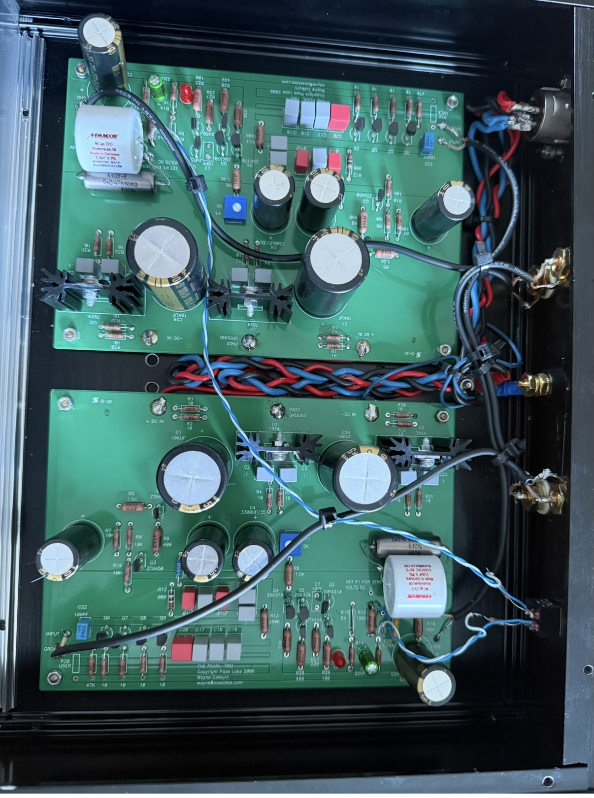

Well - to be to be honest: it’s been long time since I last had the opportunity to listen to records. So I haven’t a comparison clear to my mind.how do you like the sound?
The amplifier might be over it’s best years (a Denon POA 1500 from around 1985).
But all that said I think the sound is good - and it is opening more as time goes on. I have listened to only 3 sides of records when I am writing this.
It’s like there is some slight distortion, but I blame the old amplifier for that😄
It’s playing through a B1 and the logical next step will be starting building the Aleph J. I have the boards and most of the components as well as Modushop enclosure - so what am I waiting for😄
Get building! Everyone should have an Aleph. Also a Square Law amp. That will make your putter flutter!

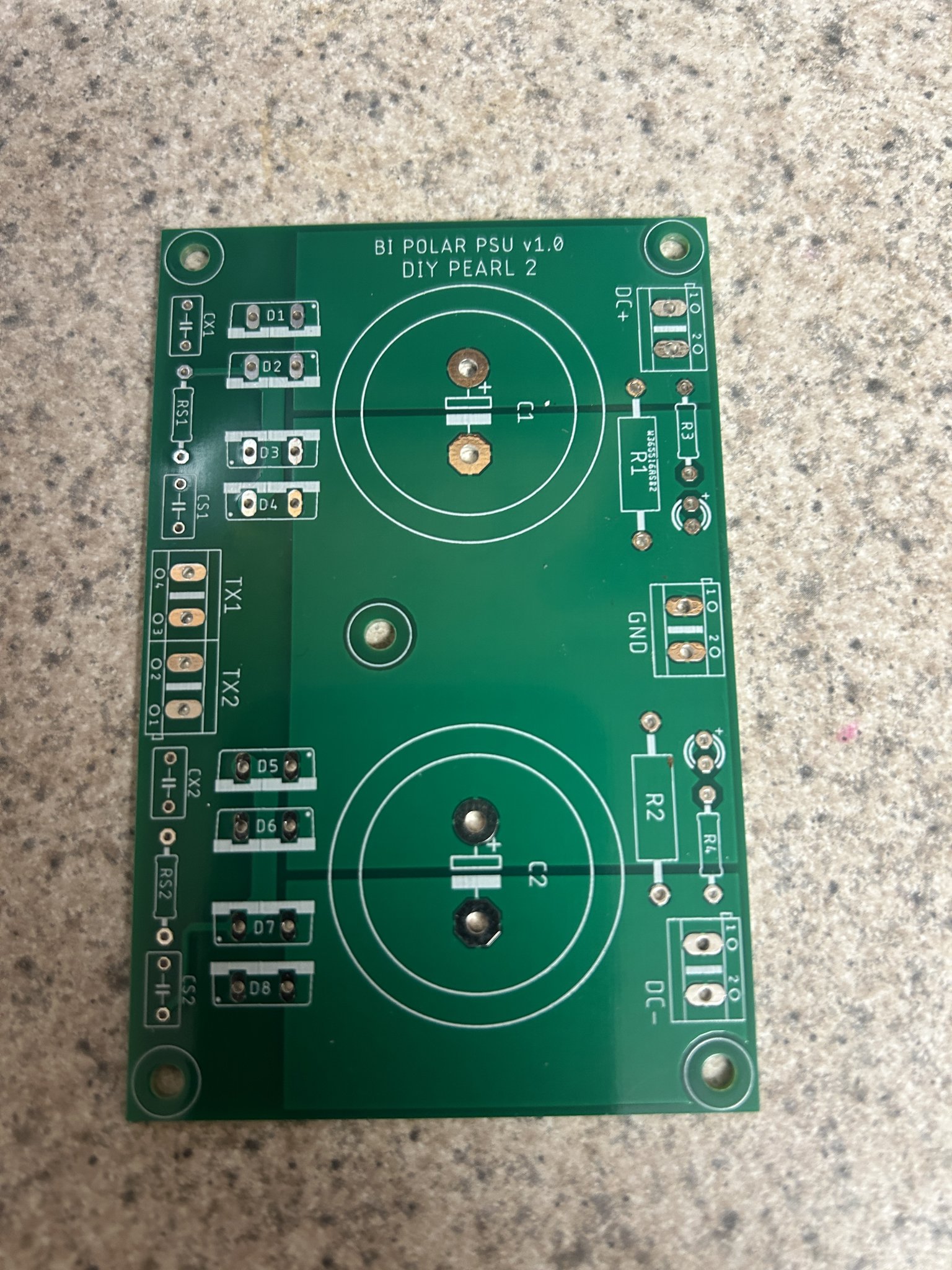

Hi all
I recently stumbled into a listing for Pearl 2 boards with what looks like all the parts to populate them in the swap meet…couldn’t resist since I always wanted to try one.
They even came with a pair of Antek AS0522 transformers for a dual mono PSU.
I looked over the documentation and the recommended power supply doesn’t look too hard to build with some monolithic bridges.
However, I saw the recent inquiry for these PSU boards…
I already reached out to Randy and he’s out of stock.
Does anybody else have a pair they’d let go of?
Let me know via PM if you could.

I’m still really enjoying the Pearl 2, especially in combination with my Dynavector MC cartridge.
What I truly appreciate about this phono stage is how easy it is to tune and modify the sound to my liking.
Over the years I’ve tried quite a few different mods—some subtle, some more dramatic—and it’s been a joy to experiment.
The only real downside is when switching between different cartridge types, but with a bit of effort, that can be worked around.
All in all, the Pearl 2 remains one of my favorite RIAA stages. That said… I have to admit I’m getting a bit curious about the Pearl 3! 😊
