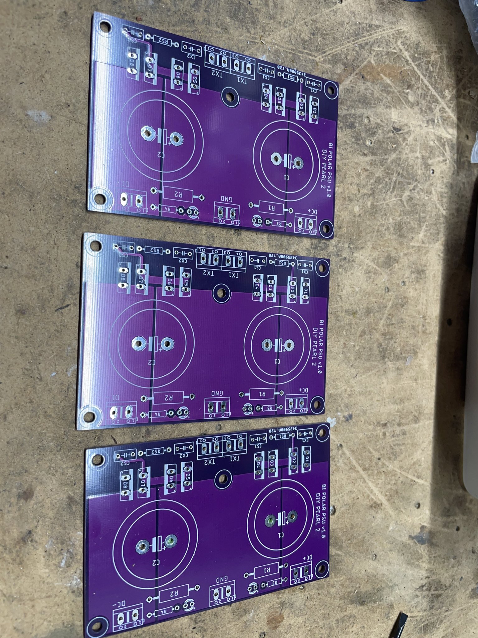

I found two of these in the “hoarding drawer”. Who did I get these from? I’m happy to let one go if there’s a need.
Edit:
Looks like I purchased them from @itsikhefez. I found the order from 3 years ago.

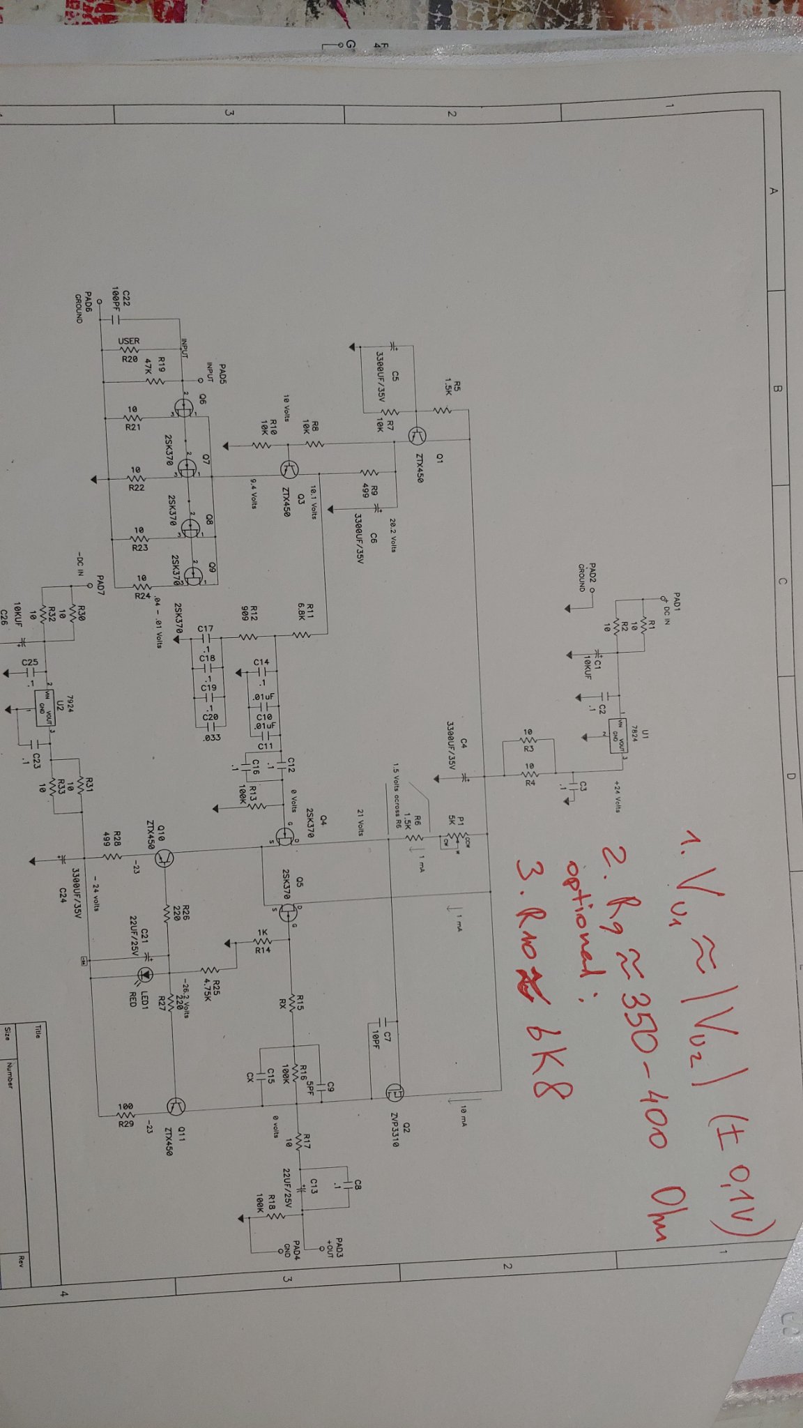

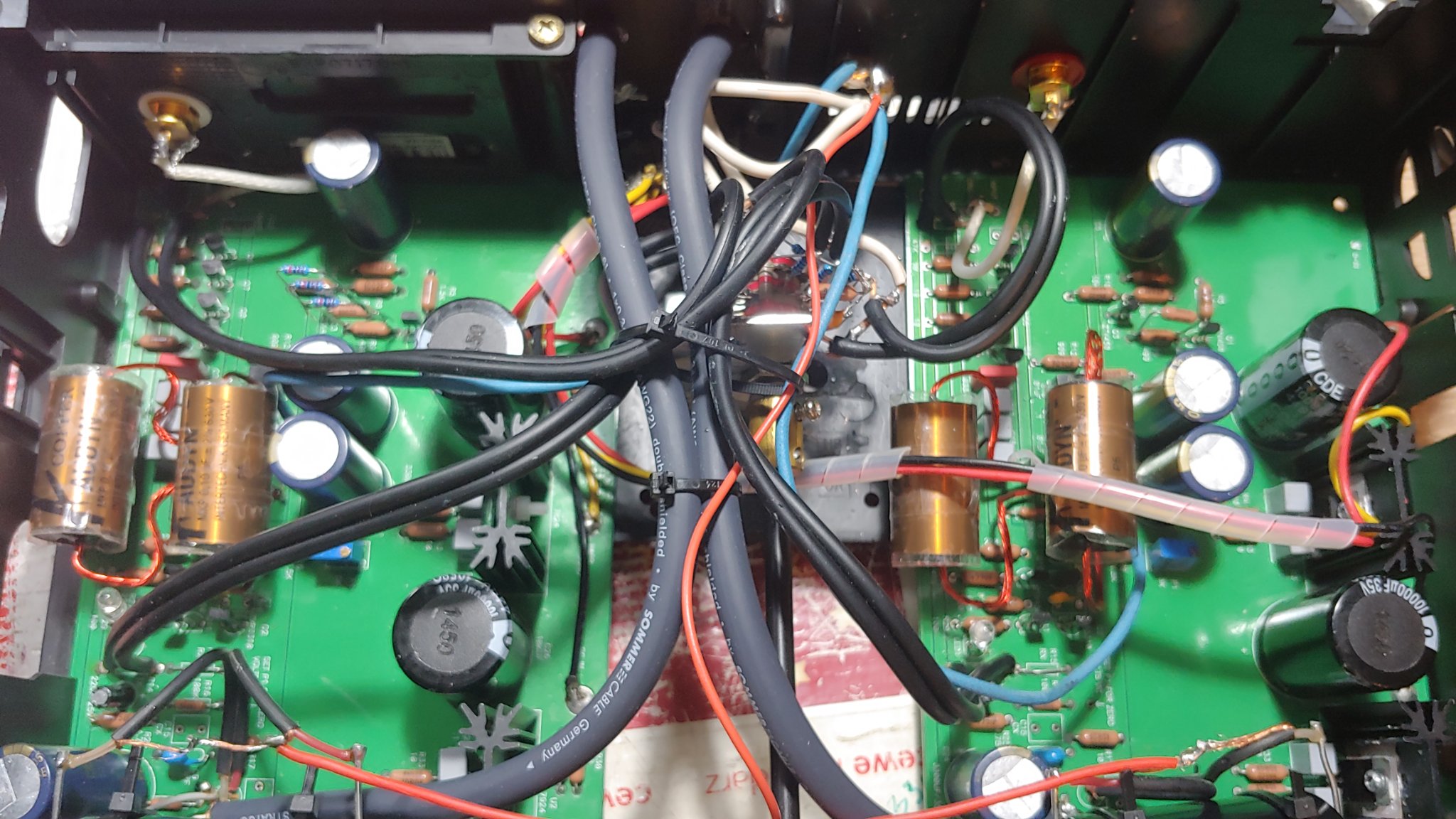

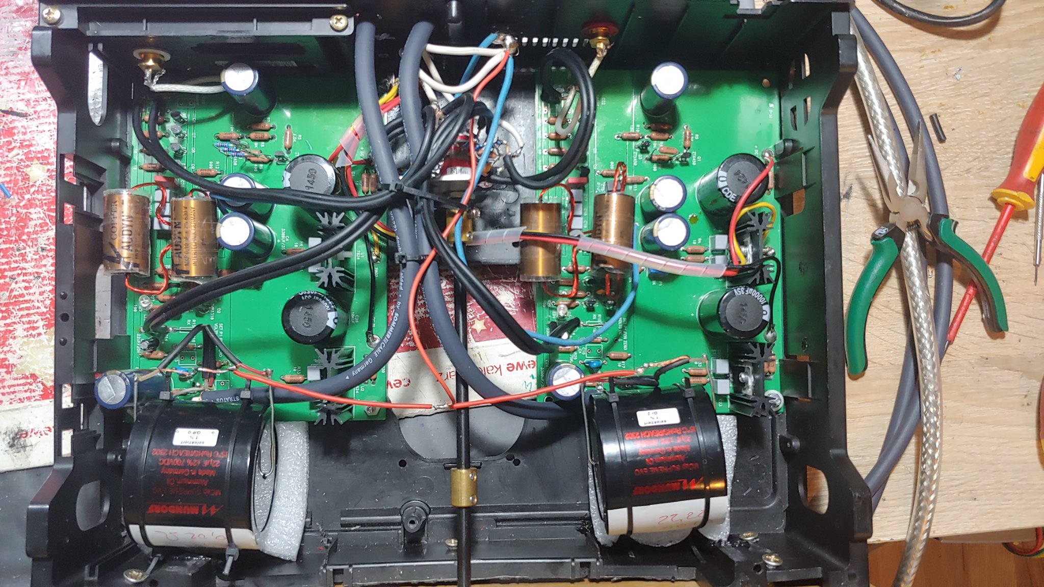

Hello everyone, I understand that our community is busy with Pearl3 now, but I would like to simplify the DIY activities of those like me who admire Pearl2 a bit:
1. Setting the voltage drop/current on R6 to around 1.65V helped to select U1 and U2 (Vu1=IVu2I+-0.1V).
2. To reduce the voltage on collector Q3 to 400-350 ohms, slightly more than on the base of the sluggish R9. Left channel 400, right channel 350.
3. Optionally, as already described here - sorry, I had to look for someone for a long time - reduce R10 to 6K8.
I hope that this saves someone a couple of hours.
I will post the photos in a separate report.
The motto when building the Pearl was: "It doesn't have to be pretty, but it doesn't have to be a compromise in terms of sound", at least that's what I can imagine.
And that's what it sounds like!
Thanks and greetings to everyone.

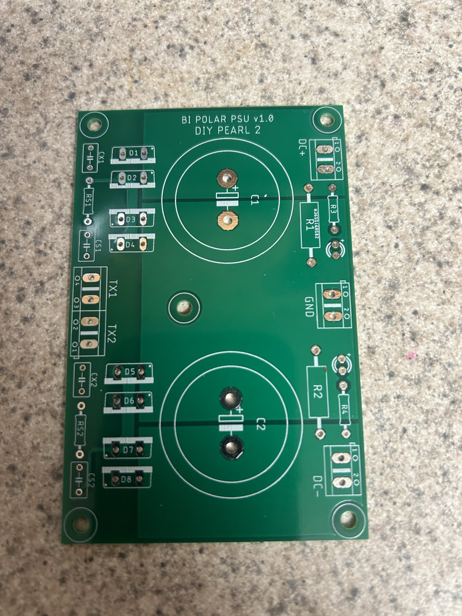

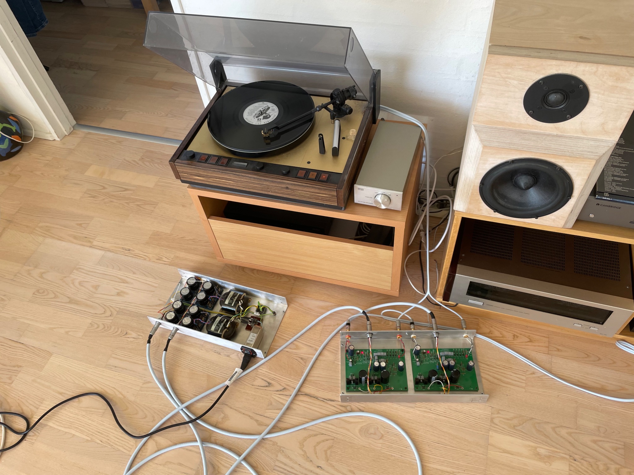

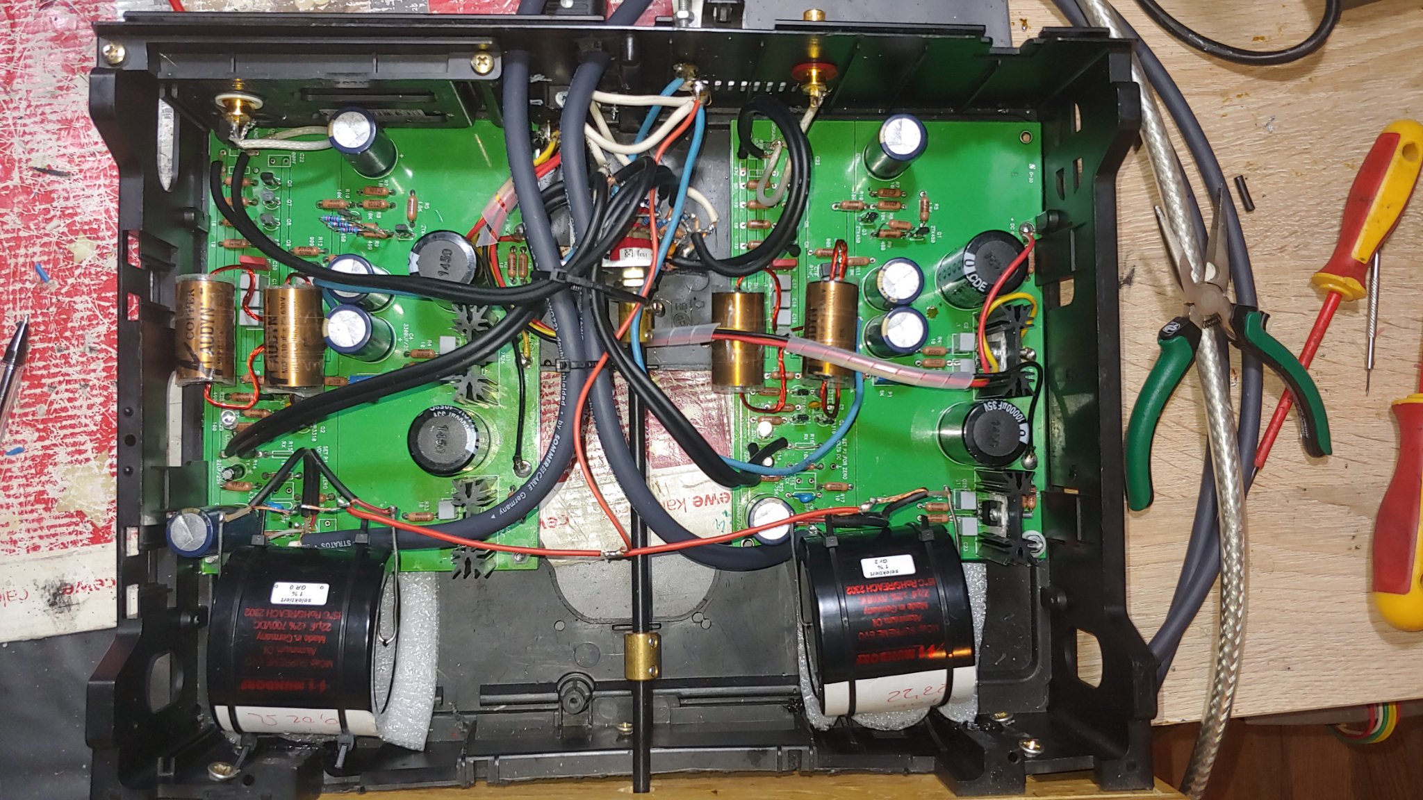

Just finished boards and PSU and was trying to connect it to the stereo.
One channel played - the other did not.
I would start to suspect the ZVP3310 as I have read it is causing problems for many.
How Can I know that Q2 (ZVP3310) is working?
Will a Voltage drop across R29 (100 ohm) at 1.14V indicate that when about 11 mA flows through this resistor - then Q2 is working?
Sorry for my last post.
The problem was the wiring 🤯
I had switched ground and signal for one channel.
In Denmark we have a saying that translates to something like” the eyes are where you first get blind” - and right now I feel rather blind that I didn’t see that before starting all the voltage measuring.
