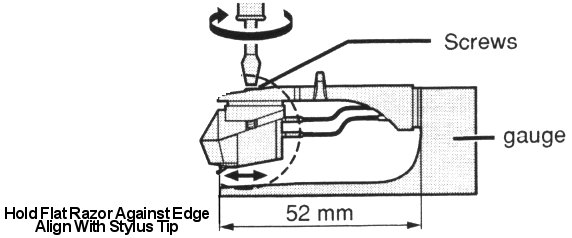

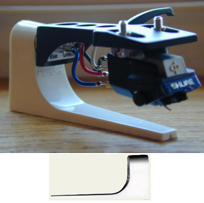

Ok …. I just set it to 52mm . I did it by eye originally ,but measured ,and made an adjustment .
Where did you get the gauge ? They are ideal for storage -better than kicking around on the shelf …. £ 500 to re-tip the shelter
Rich
Just download and print an alignment protractor:
Free Cartridge Alignment Protractors - Vinyl Engine
Won't solve your storage issues, but at least you can get the cartridge set up properly.

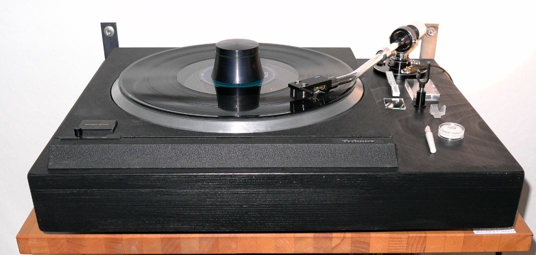

Hi Johnny,
sorry, a little late, but coming back to your question about the Denon 103 - yes, I am using the Pearl2 with a Denon DL 103 on a 12 inch Audio Technica (ATP 16) arm on a Technics SP 20, with some DIY backloaded horn speakers - the sound is really good!
No hiss at all with the DL 103.

poli - the ATP-16 and DL-103 must be a match made in heaven! I can only imagine that it's wonderful!
Mate, they really perform well!
I built a plinth for the Technics SP 20 and the ATP 16 (see picture) and I am really satisfied!
That's fantastic! I am in the process of restoring two SP-10 http://www.diyaudio.com/forums/analogue-source/261735-technics-sp-10-mk2a-project-6l6.html
I love your plinth, I want to make one of about that scale, and just add lead for increased mass. I'm planning on using my Graham 2.2, although the tables came with ATP-12T, perhaps I'll keep one. (The other is on eBay right now) If it was the ATP-16T, I would not sell it.

Hi 6L6,
Thanks man, it was good fun to build. Well, it has its flaws, since it was my first plinth that i built, but it sounds good.
Wow, two SP 10! These are hard to find these days! Prices have gone up for them, so you are a lucky man, congratulations!
They look really cool and I wish you all the best for overhauling them!
Yeah, the ATP-16 are a really good match for the DL 103!
Looking forward to reading about your sound impressions.
