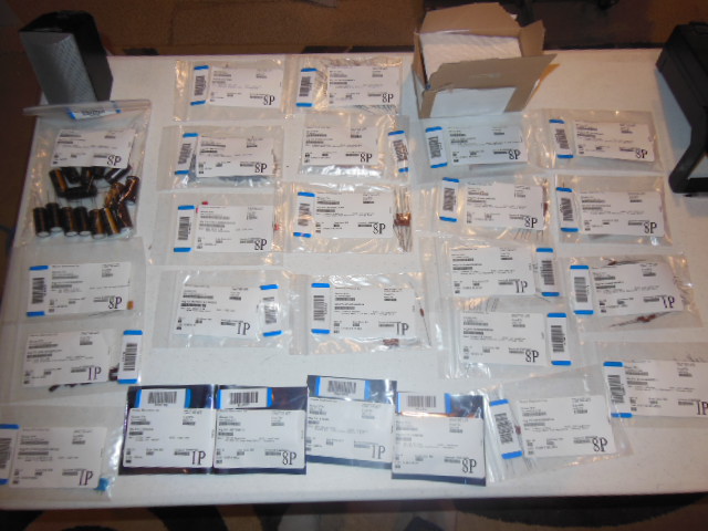

I got all my parts in from Mouser today. (Merry Christmas to me).

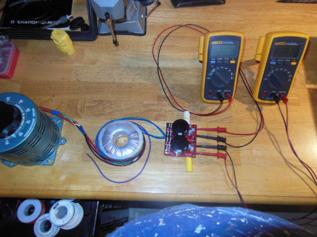

I received my power supply kit from ChipAmp.com and transformer from Antek (AS0522). I assembled them and am getting a little over +-30V.

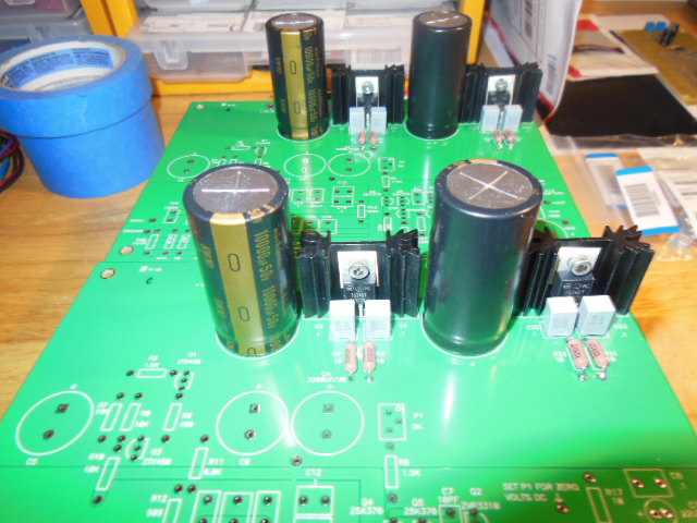

Today I assembled the power/regulation area on the P2 board. Tomorrow I'll connect it to the ChipAmp supply board and see what I get.
testing power

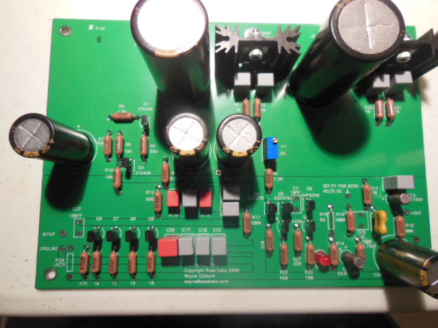

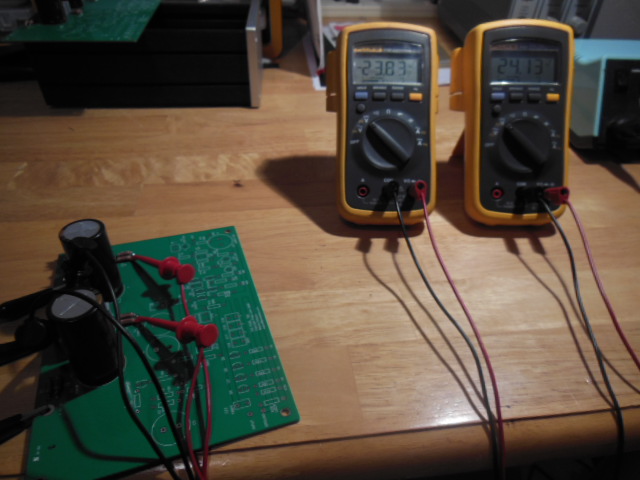

Tested the regulation section of the board this morning.
First picture shows unregulated supply hook up.
Second picture shows regulated voltage.
Third picture just shows board and meters.
Fourth picture is unregulated voltage.

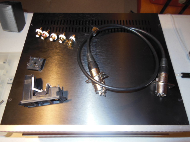

Getting Close

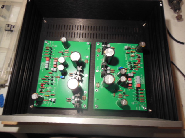

My Galaxy 388 chassis came in (very nice).
The boards are populated:
I left R20, C7, C15, and C22 out.
I jumped R15
I have all the parts needed to finish: AC entry/fuse module, RCAs, umbilical cord, and TT grounding post.
I've mounted the PCBs in the main chassis.
I just need to find someone to machine the back panel.
And then wire it up.
