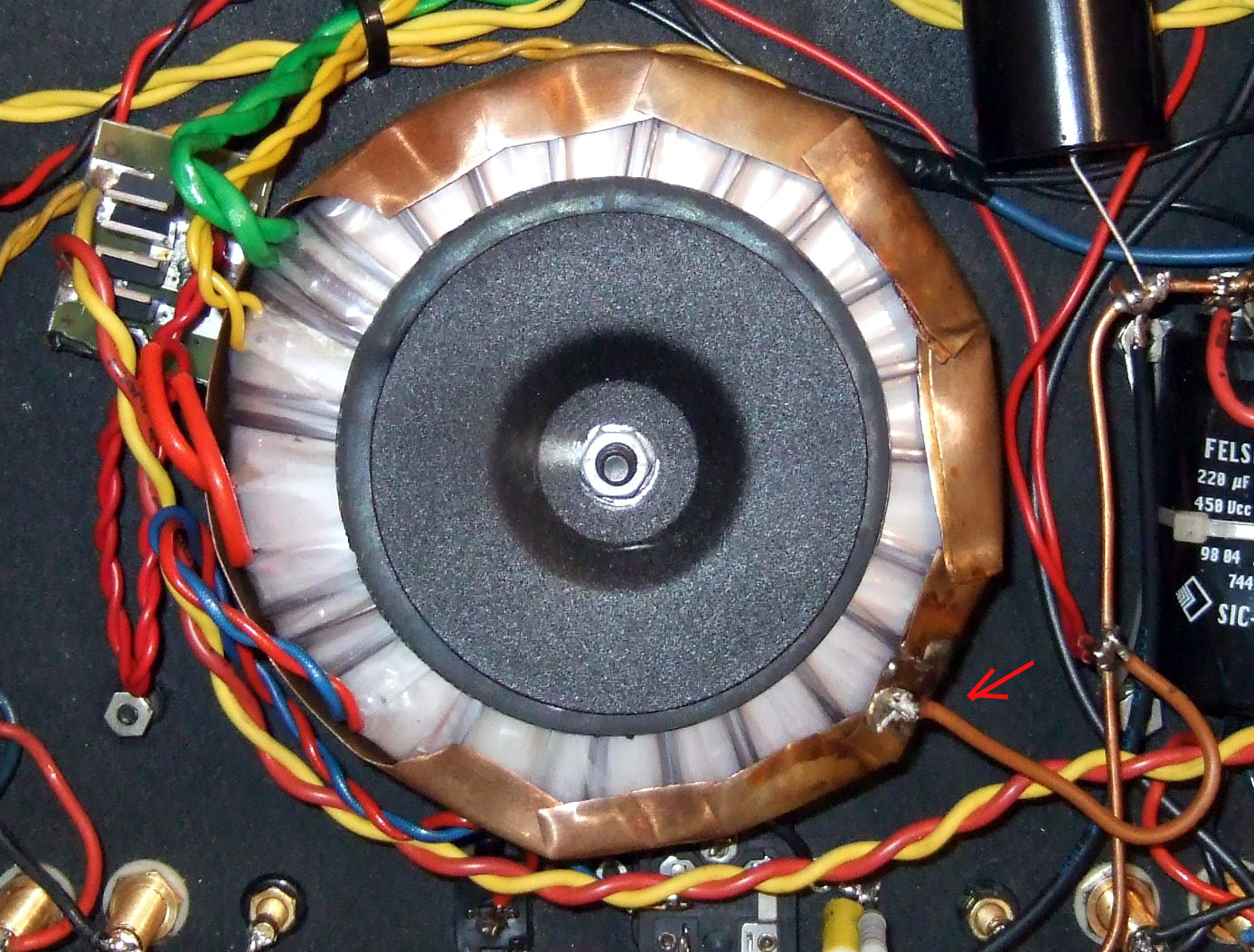

Electrostatic screen in the form of copper foil or thin wounded wire is more often used with toroid than EI or C core transformers , since toroids have high capacitance between primary and secondary. Split bobbin and UI core transformers have very low capacitance and are better for audio.I remember that my transformer manufacturer did not charge extra for electrostatic screen with toroids I had ordered.
Now I am using only low profile UI transformers.
But is the screen between the Primary/Secondary windings?
Or just a mu-metal or other soft steel band around the circumference of the entire toroid?
If I was to build another phono I would likely use a EI or UI transformer, with screen and encapsulated. I would also use dual bridges as in the Pearl 2.
And then do the most important thing - place the PSU in an unattractive box so you place it out of sight, and a meter or more away from the RIAA amp - guaranteeing that there is no issue from radiated hum! 🙂 🙂
Transformer electrostatic screen is a copper foil or thin wire between primary and secondary on which usually green/yellow drain wire is soldered. Drain wire is then bolted down on mains safety earth terminal, never on signal earth.
In this way mains noise and transients are reduced, rerouted to mains earth.
So the circumference band is not electrically connected? I didn't know that! The internal shield being taken to chassis earth does make more sense...
I learn something everyday. 🙂 This forum is awesome. 😀 😀 😀
OK then. But I remember hum went best in a tube amp of mine that I dressed its toroid peripherally with a copper band when I grounded it too.
