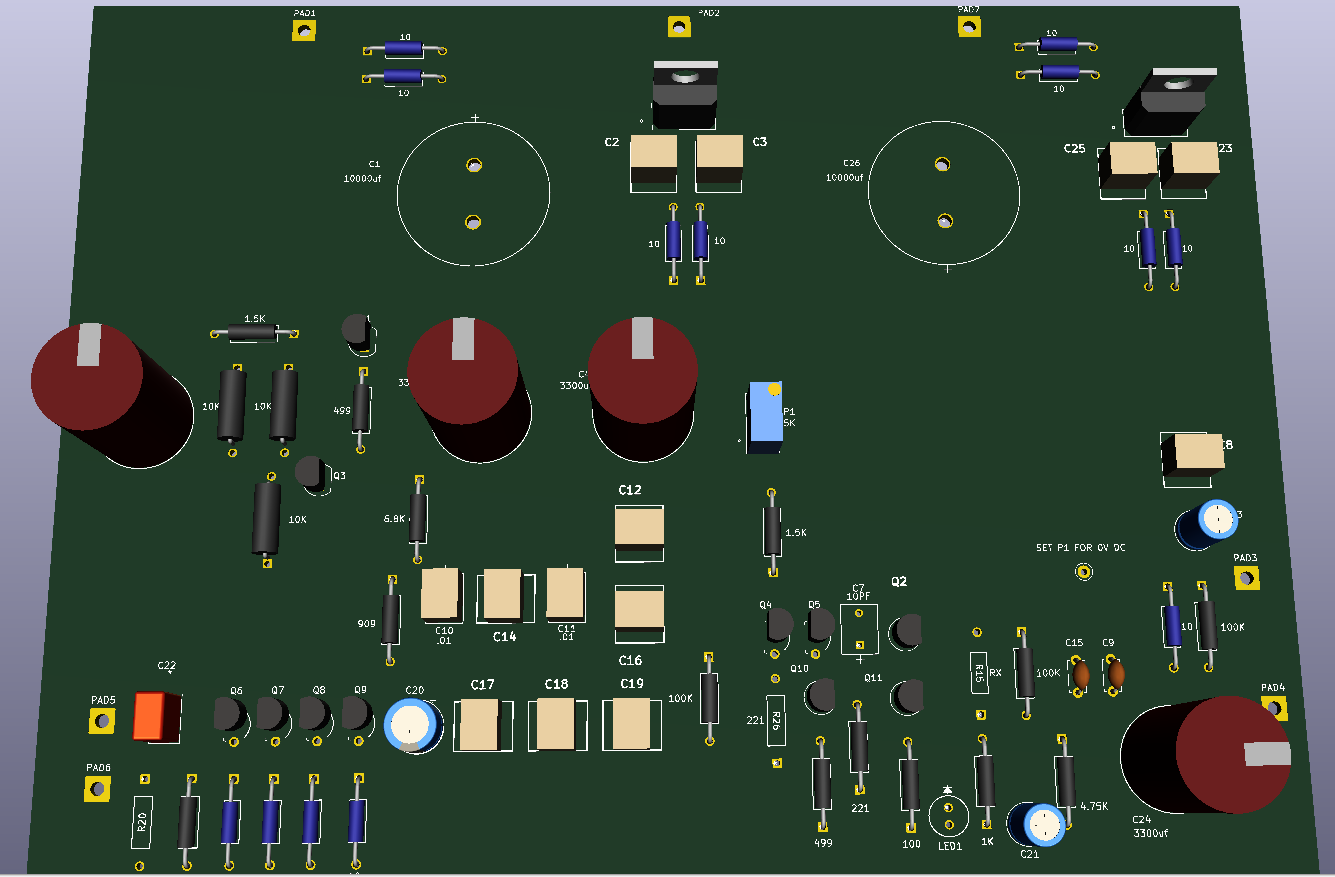

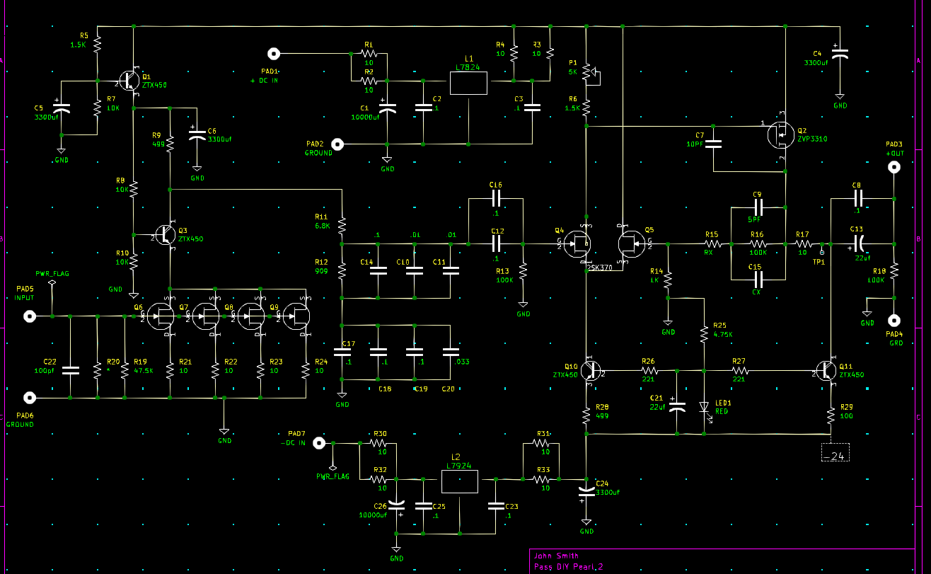

Working on designing boards to accommodate some capacitor changes on it. I needed to do this since the caps I want to use are too different in physical dimensions to work on my boards I picked up when they first hit the streets.

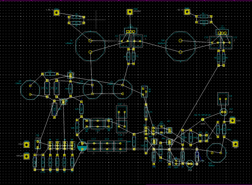

I have never used any schematic software before, so I am still getting used to it, but I do like this KiCad program. Furthermore, I have attached a few screenshots of where I am now. I still have some things to do as can be seen. I also need to see where TP1 ties in. I believe it is from the output of R17 to the wiper of P1, but I need to verify that.

Get the power supply components off the board.Working on designing boards to accommodate some capacitor changes on it.
Tighten the layout to keep ground connections compact.
Thank you for your thoughts.
There are no power supply parts in there; basically I have Wayne's schematic and layout open in another window and laying out everything as he had them; so no PS parts.

Ahh, could be. Just keep in mind I am just redoing the original design except for some cap changes. And those screenshots I posted are not of the finished version.
After going through everything again it does not seem to hard to take those regulator section’s off the Pearl board and place them on their own board. Include them on a PS board so all of those components are together. Has anyone done this before?

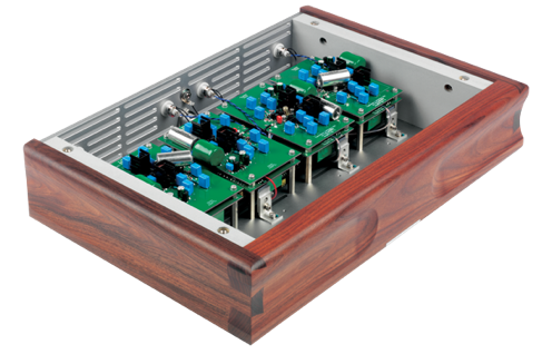

As an exercise (so far) I've taken a couple of circuits (not this one) and made layouts that separated signal circuitry from PSU distribution circuitry. The intent was to get a compact and straightforward signal layout without having to use unnecessarily-long traces to accommodate components. I did the layouts for stacked boards interconnected with short wire links or resistor links. Indeed, with one phono circuit I separated the passive components from the active ones from the PSU distribution.
I haven't implemented these yet... I'm trying to work up the courage to use a computer layout programme.
It wasn't the inspiration, but after the fact I realized that the Lyra Connoisseur Phono preamp was executed in a similar vein.

Download KiCad and have some fun!
I had never used a PCB program myself until a few weeks ago. I wanted to change up a few things on the Pearl, so I said what the hell. It is a free program that works on Windows and Linux. Documentation is very good, active forum and lots of YouTube videos to help.
I only have about 10 hours on it, and I was able to put what I posted above together. Now with the suggestions from the gentleman above I am removing the voltage regulators and associated parts and making another board. The new board will hold those parts along with a power supply section. It is fun if you enjoy this type of stuff.
