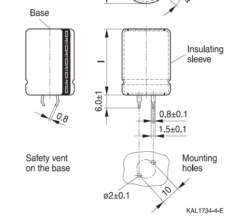

the 10,000uF and 3300uF caps, does anyone know the lead spacing?

I went back to my Mouser project from several years ago. It looks like the 3300uF is 7.5mm and the 10,000uF is 12.5mm.

It looks like the 10,000uF is 10mm unless I am reading this wrong. I have the PN from 6L6's spreadsheet.

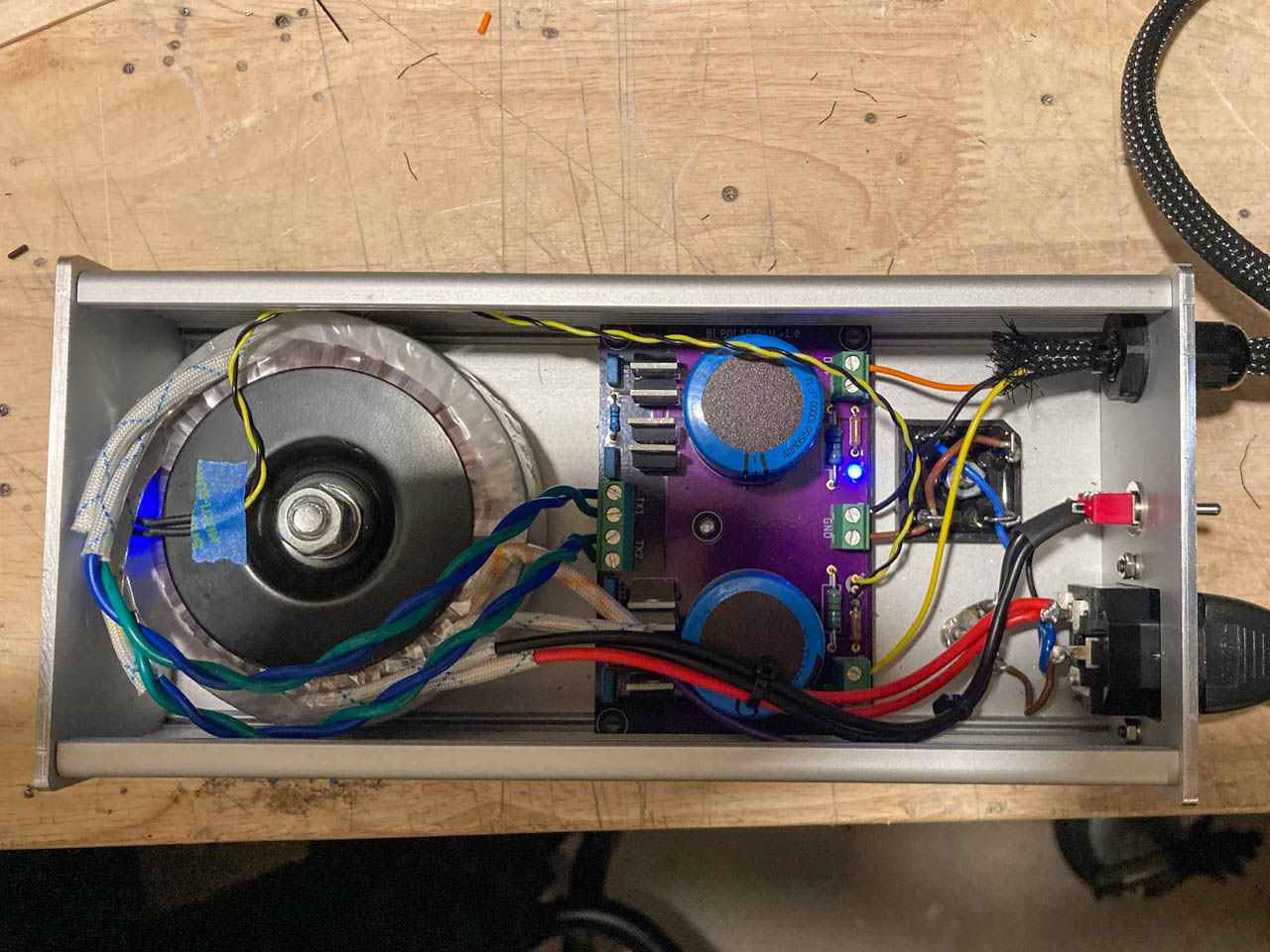

...7. What does everyone like in terms of a PSU PCB? I want something small so I can build the PSU in a small chassis. Was originally going to use the stores UPS PCB but it is on the larger side.
I didn't bother with a PS board, just wired it P2P. As you can see from the picture, it was a little tight, but I fit it all in a small chassis from Modushop.

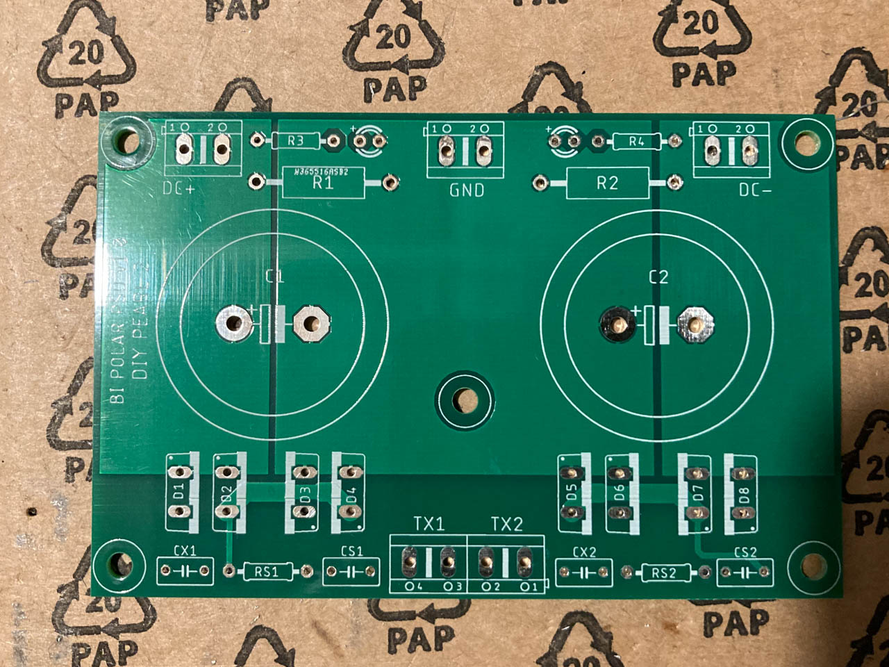

Yes the store board is a bit big. I made a custom board thats much smaller and fits directly in a Hammond 1455 chassis. I have a few left.
PCB for bi-polar caps/bridge rectifier (for Pass Pearl 2)
itsikhefez,
Are your boards based off of Carlos Filipe's LM3886 snubberized kit boards?
If so; do you have any to sell or by chance know if the ones in the DIY store are based on the ones I mentioned above?
Thanks, James
James,
I'm not familiar with Carlos Filipe's board and don't know if the ones in the store are based on them.
Mine is a fairly simple board that allows for 8x TO-220 diodes, 2x snap in caps, bleeder resistors, LEDs, and CRC (Quasimodo) snubbers
