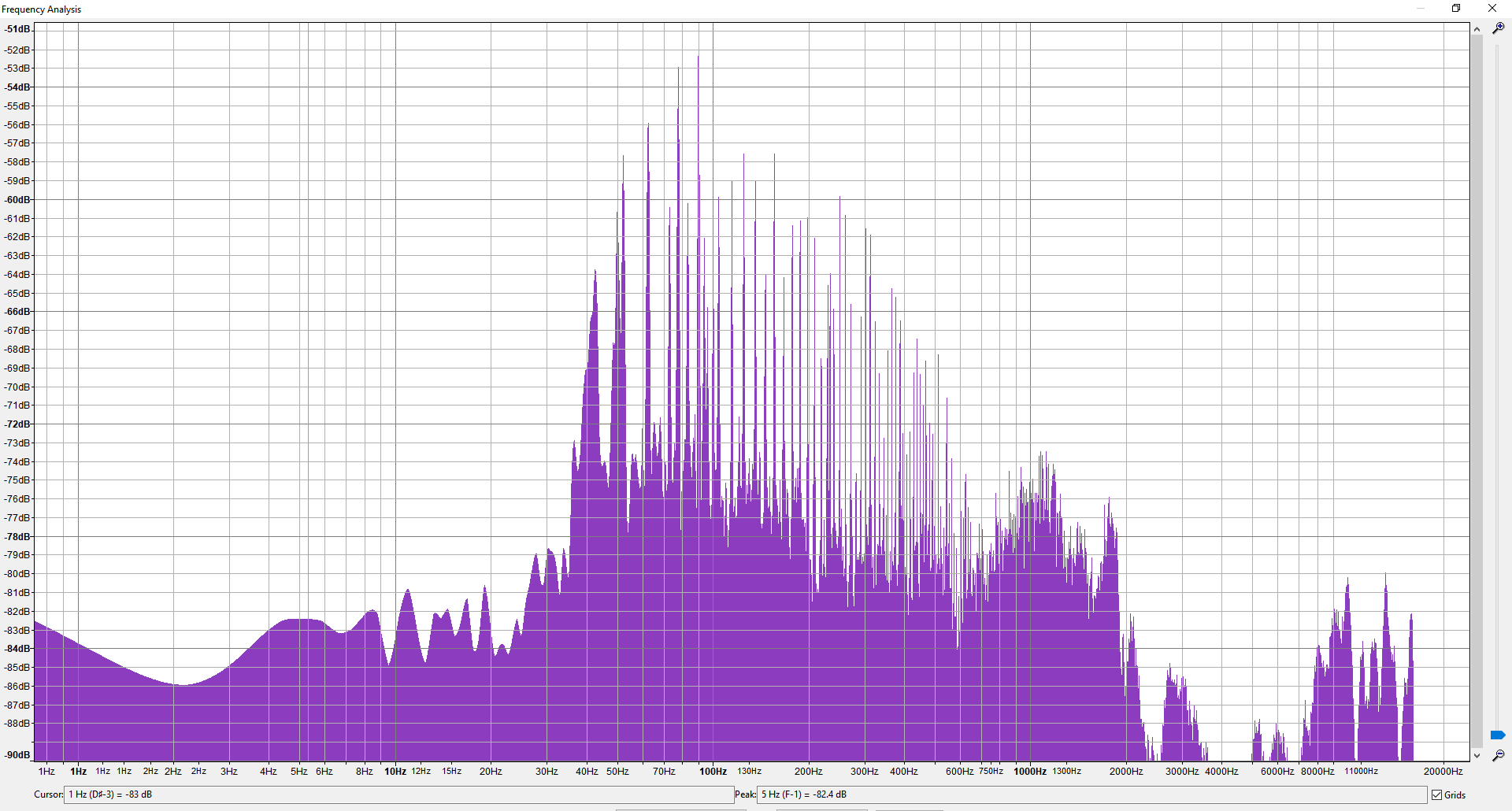

Downloaded and listened to it.... definitely audible.
Not sure if helpful or not but this is the frequency histogram of that MP4 file

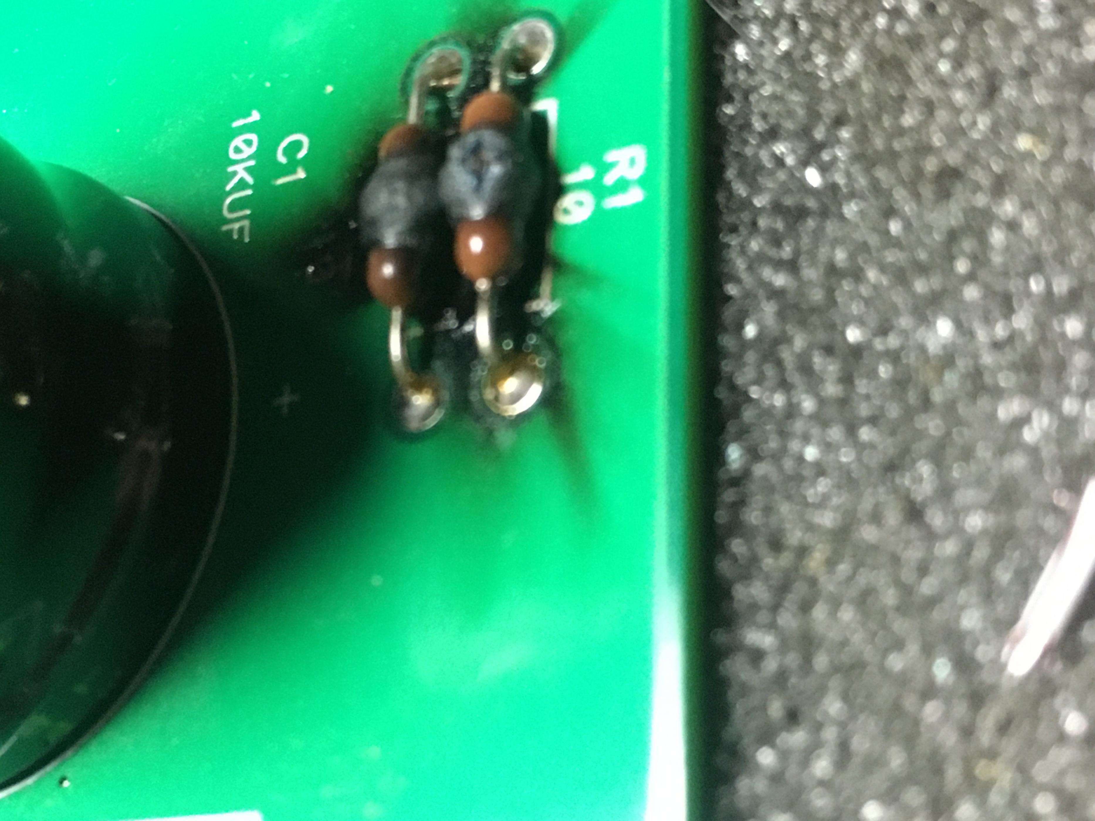

Had a little accident with my Pearl boards the other day.
Im using a MM cartridge that puts out a massive 6mv signal which seems to result in what i think is a lot of surface noise so I've been tinkering with the second stage gain settings and the resistors next to the first stage jets. After a few iterations of the gain being lowered i still have this quiet whoosh whoosh noise (its not in time with the revolutions of the platter) that appears between tracks which i thought could of been oscillation as i had not installed C7. After installing C7 I mistakenly wired the power up the wrong way (+ to - and vice versa) which produced no pearlescent music what so ever but rather a noise akin to a very fast rattle (brrrrrrrrrrrrrrrr)

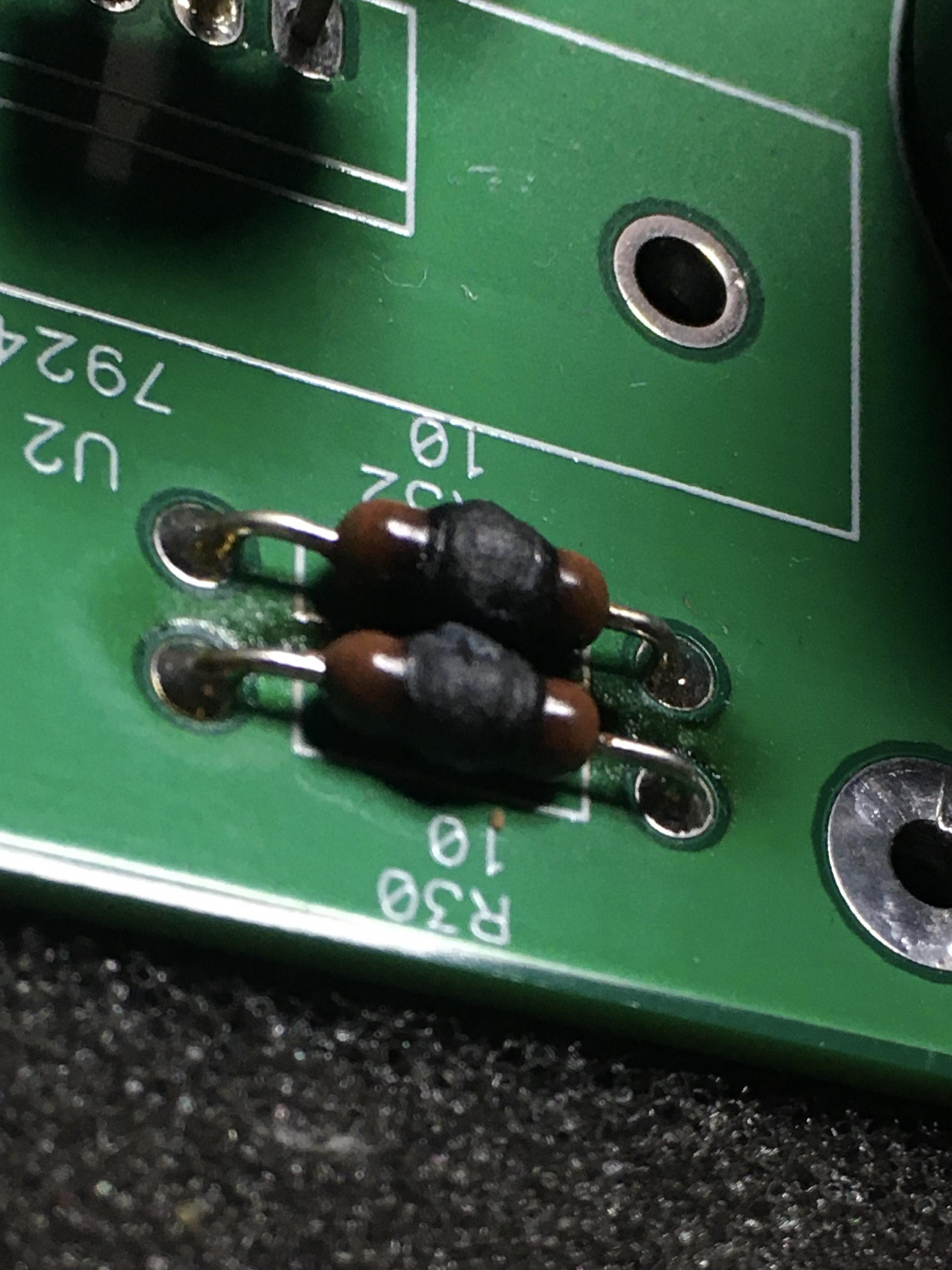

I soon noticed i had the power wired up backwards so in my idiocy i switched it off then re wired it the correct way and turned it on. The led lit up which was pleasing but then the first pair of resistors R1, R2, R30, R32 made a fizzing noise then made this huge puff of magic smoke and i quickly turned it off at the wall.
One board seems to have burnt a load more than the other and the less burnt board now plays music once i had removed the burnt resistors and bypassed the regulators and injecting power at C4 + C24 but the more burnt board just plays a loud buzz.
I switched the jets around between boards and the ones from both seem to work fine in the less burnt board which was pleasing.
My question is now which components are likely to have suffered and will need switching out ?

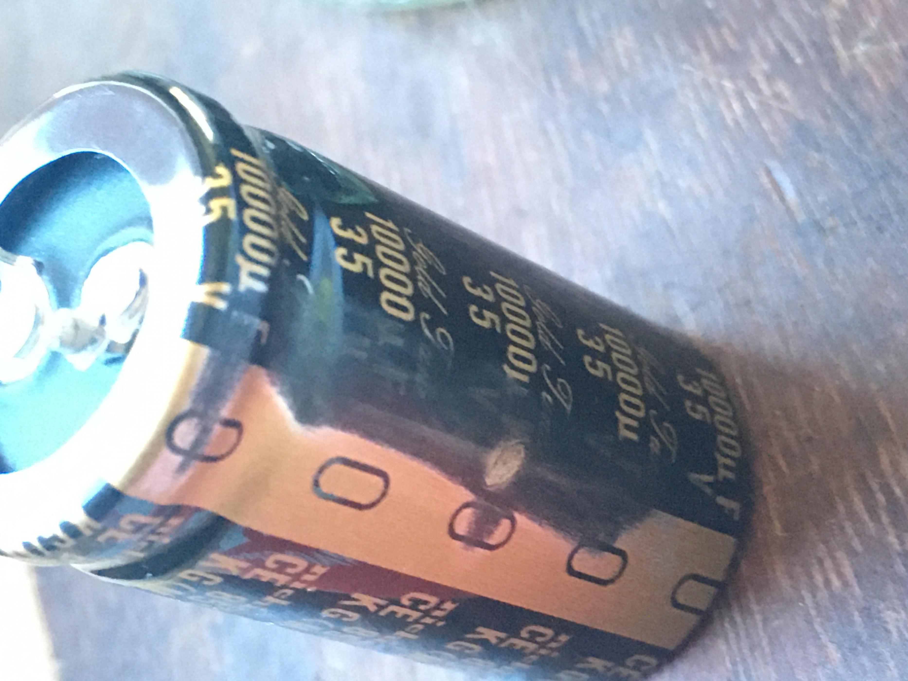

I was thinking the electrolytic caps at least and and maybe the zvp3310s, the ztx450, the wee elna .....

Oh no!! I did something similar on my first amp build - an A40 about 20 years ago. I mixed up my N and P ch output devices and let a bit of magic smoke escape..
I don't have very much experience troubleshooting boards, though I would start by replacing your regulators - they are most likely to be cooked. Sounds like you got lucky with your jFets! I would then move on to replacing all of the remaining 3-legged devices. With the transistors out of the circuit, you can verify resistor values. Aside from those in the regulator, the rest of the caps are no-polar, so they should be fine.
Go slowly and methodically. Since one board works, you can make some comparisons across the boards. You'll make it work again!
During some of my resistor experiments I somehow fried the negative regulator, so half the board seemed dead but it was actually fine.
I would initially only start by replacing the regulators and any resistors that are visibly damaged.
Then start it up and take voltage measurements, most of the circuit may be fine.
