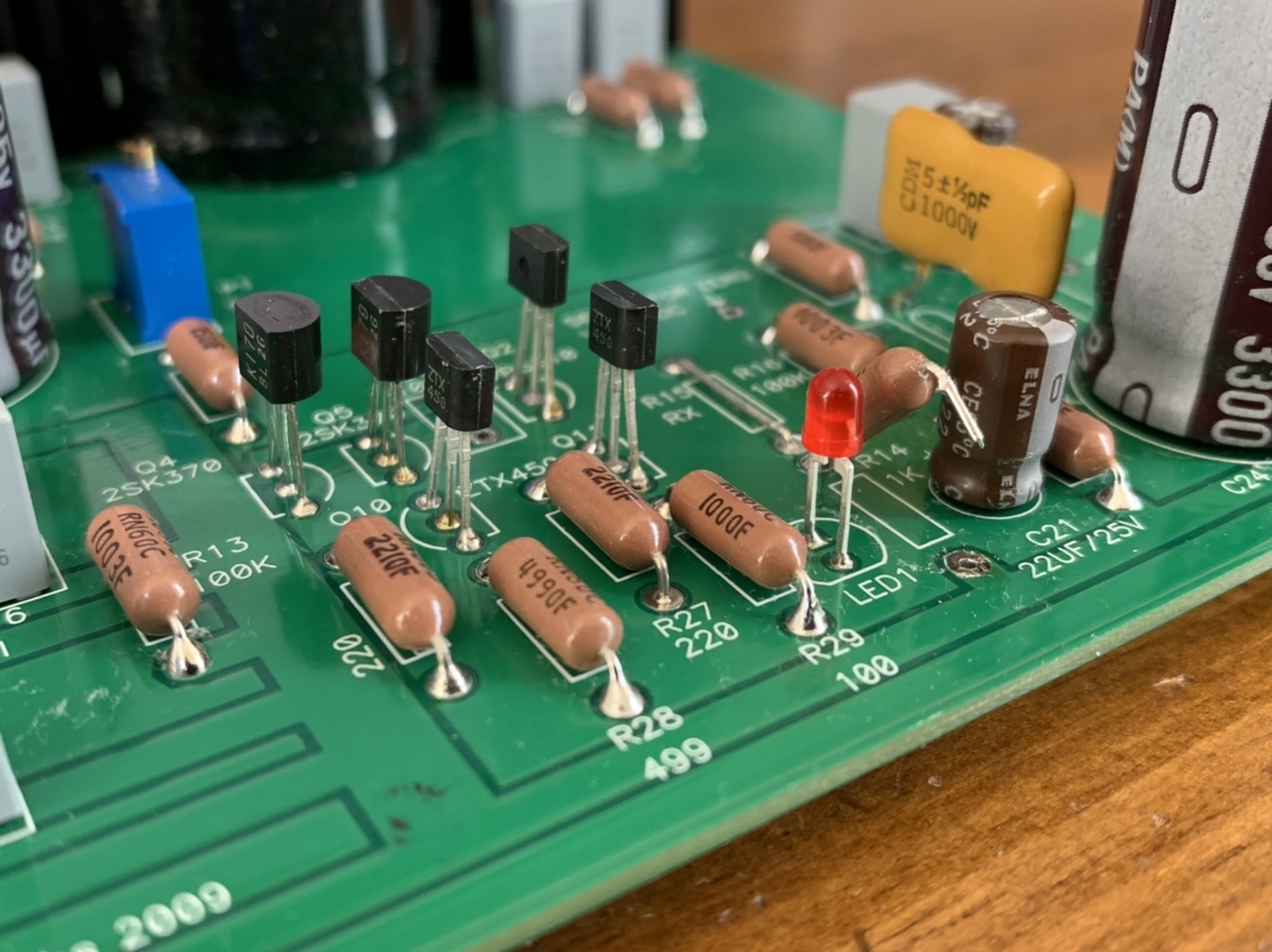

I'm looking for some advice on capacitor selection. I read in an earlier post that to help stabilize the output to place a 220uF electrolytic capacitor between R14 and ground. My question is... is the value critical? I have the following in my box of parts and was wondering if any of these would suffice:
220uF 10V Nichicon Muse it's a bit bid (physically), but not sure on the voltage rating.
22uF 25V Nichicon Muse
22uF 25V Elna Silmic II
10uF 35V Elna Silmic II
I don't want to screw anything up, so if it needs to be 220uF then it'll be off to Mouser once more. I just hate having to pay the postage for a few capacitors, so I'd end up buying lots of other stuff just to justify the postage, and that would be yet another project piling up in the corner.
Many thanks,
Gary

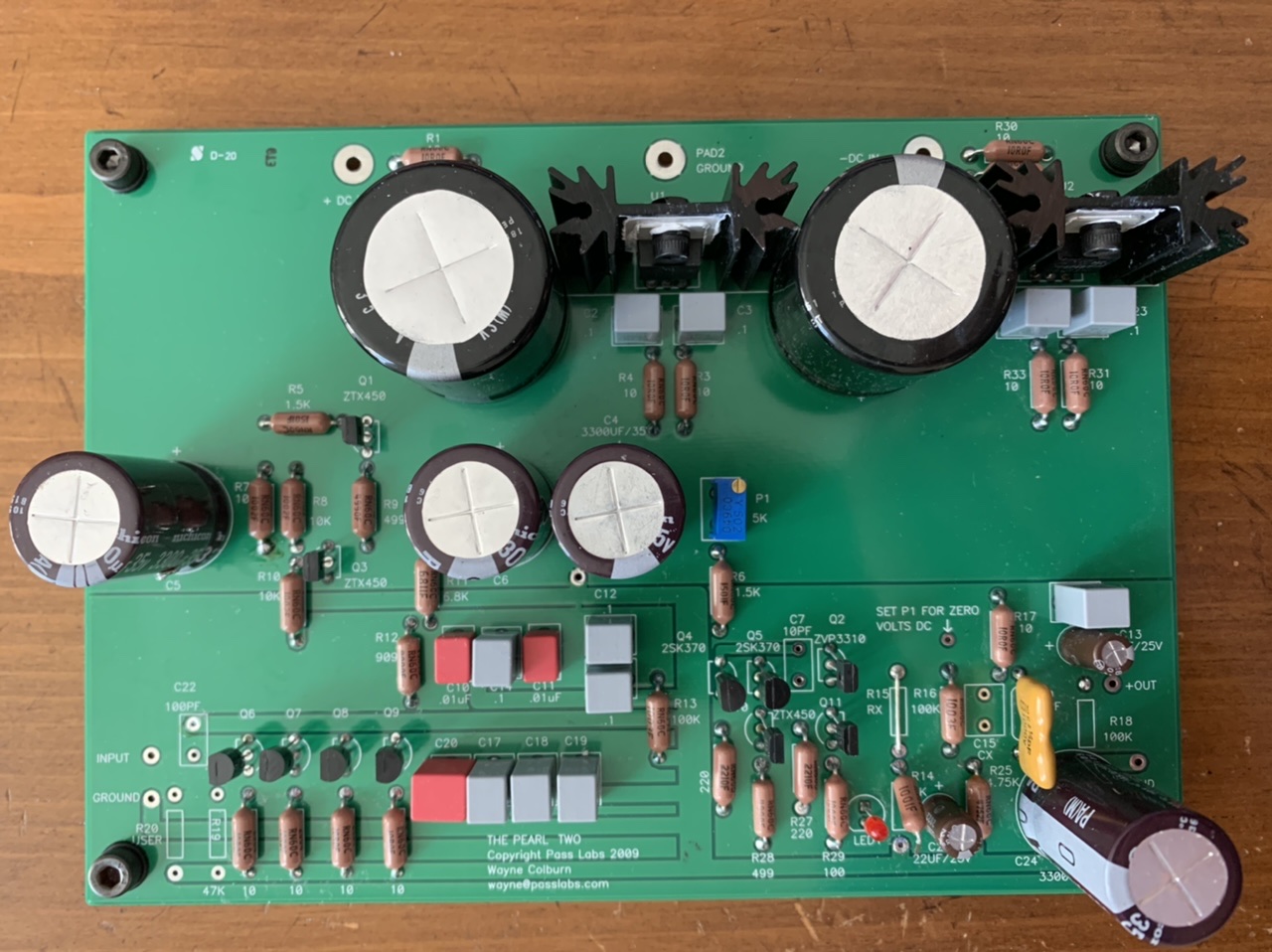

Boards all built up with just one resistor R19 (in the mail somewhere) to fit and left a gap for the capacitor between R14 and ground. Photos were taken before washing all the flux residue off.

There is a post somewhere here by Wayne. Copying from my notes, he wrote:
Use a nice (Silmic) electrolytic 47uF - 470uF works fine, 25v or more and use a film bypass if you want.
I used a 100uF 35V Elna Silmic II that I had in my stash

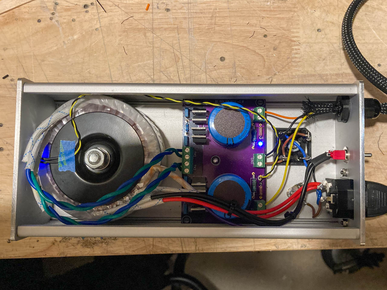

Ok, before anyone else says it.... yes, it probably is way too much just to power the Pearl II. I admit I may have gotten a little carried away and gone over the top with this. But, hey it was fun. And after all that’s what it’s all about.
So, that said, here’s my almost complete power supply for my Pearl II. I still need to install the earth wiring from the input power connector, replace the temporary front and rear panels (hope to have the new ones in a couple of weeks or so) and install the OLED display in the front panel. But for the most part it’s done and working. I just need to get on with the Pearl II now.

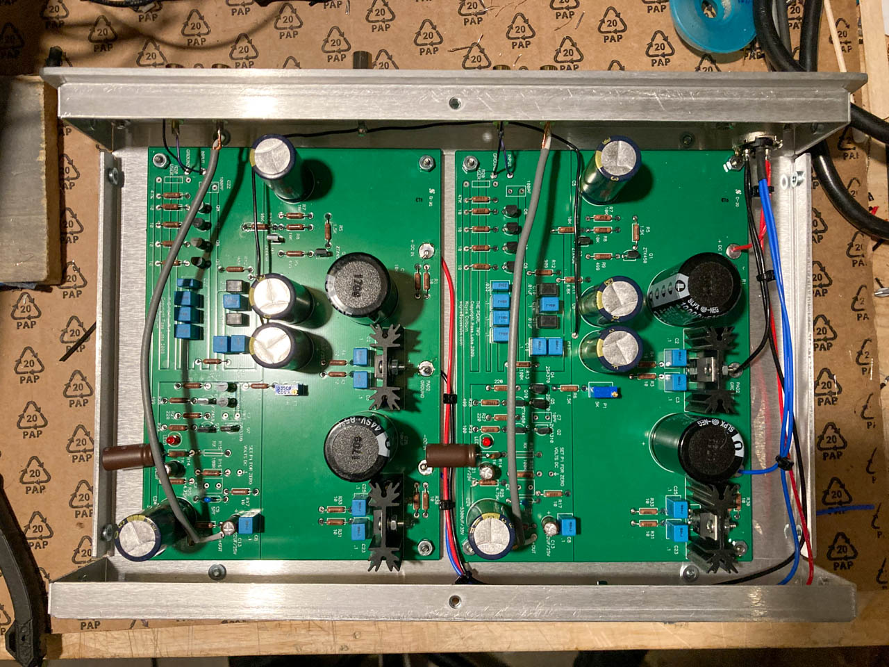

I finally finished my second build, I regretted selling my first Pearl 2 almost immediately...
The PSU uses a small PCB that holds the rectifiers, CRC snubbers, bleeder resistors and LED's. It all fits in a Hammond 1455 case neatly for a compact PSU.
The Pearl boards are in a Par-metal 12x8x2 case, nothing fancy in terms of parts.
I want to point out some small circuit tweaks. I am using 2SK170-BL JFET's with around 8mA Idss and the voltages I observed differ from Wayne's quite a bit. There are scattered posts about this in this and the other Pearl thread.
Jack posted a few pages back simulations with the lower Idss ("A") JFET's and the "B" grade. The "B" grade result match my voltages exactly, while the "A" grade Wayne's.
I am fairly certain anyone acquiring "B" grade JFET's from the DIY audio store, or from Pass labs, will likely benefit from these minor changes.

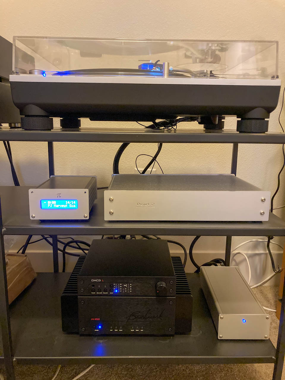

P.S -- in my rack, the PSU is on the lower shelf next to the AHB2 amp
P.S.2 -- I have extra PSU boards ... if you're interested check out the Swap Meet section
