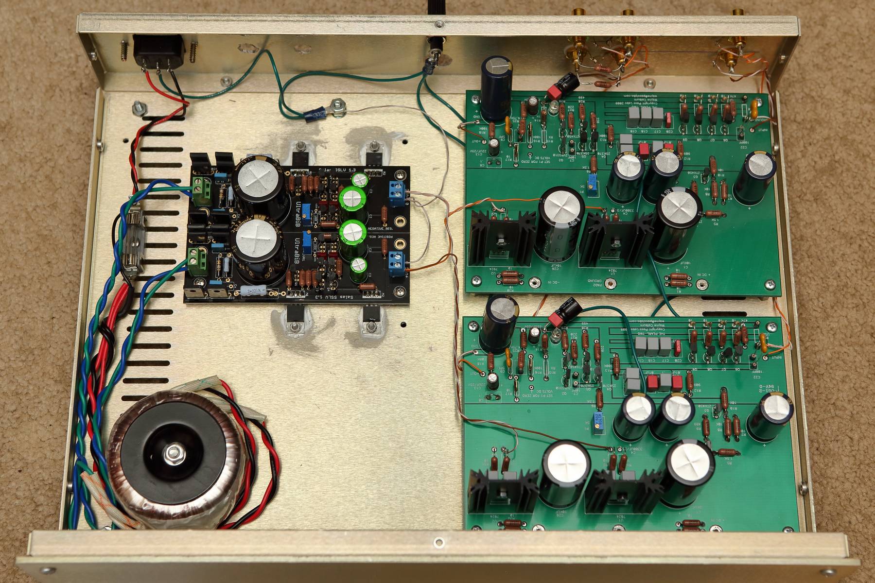

Maybe I got lucky, but my Pearl II is a single chassis build with the transformer and PCBs all in one place. It used to be in two boxes and I put it all together into one as an experiment. I can't tell the difference. Link is in my signature.
I'll have to look at your build. Like 6l6, I couldn't get my power supply box within 3 feet of the Pearl 2 chassis.

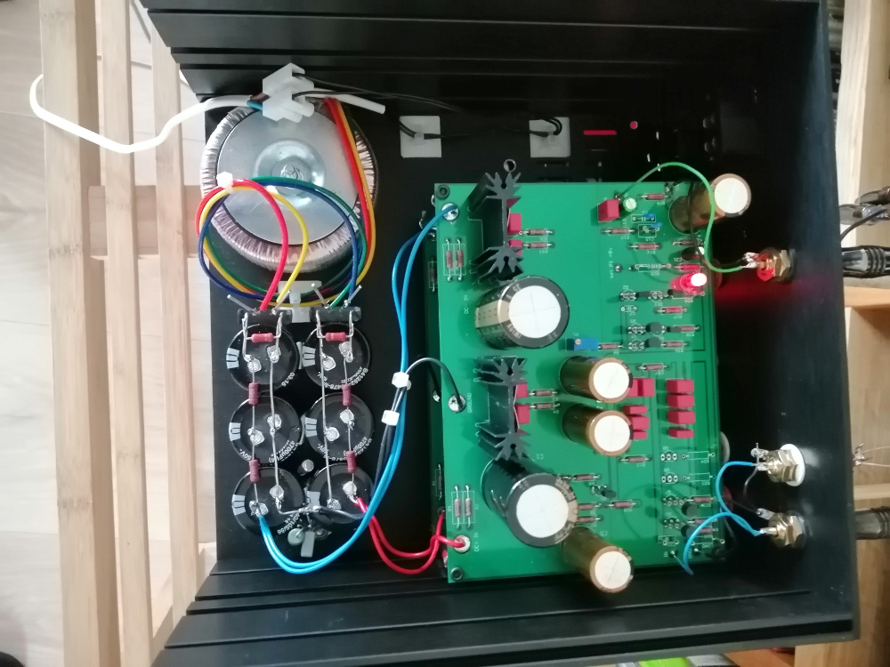

Russellc - here is an image of my all-in-one build of the Pearl II.
763012d1560563702-pearl-pearl2-jpg
I didn't think it was necessary, but I later added a copper band/shield to the transformer with some copper sheeting scraps I had laying around. I don't hear any noise at all from this arrangement.

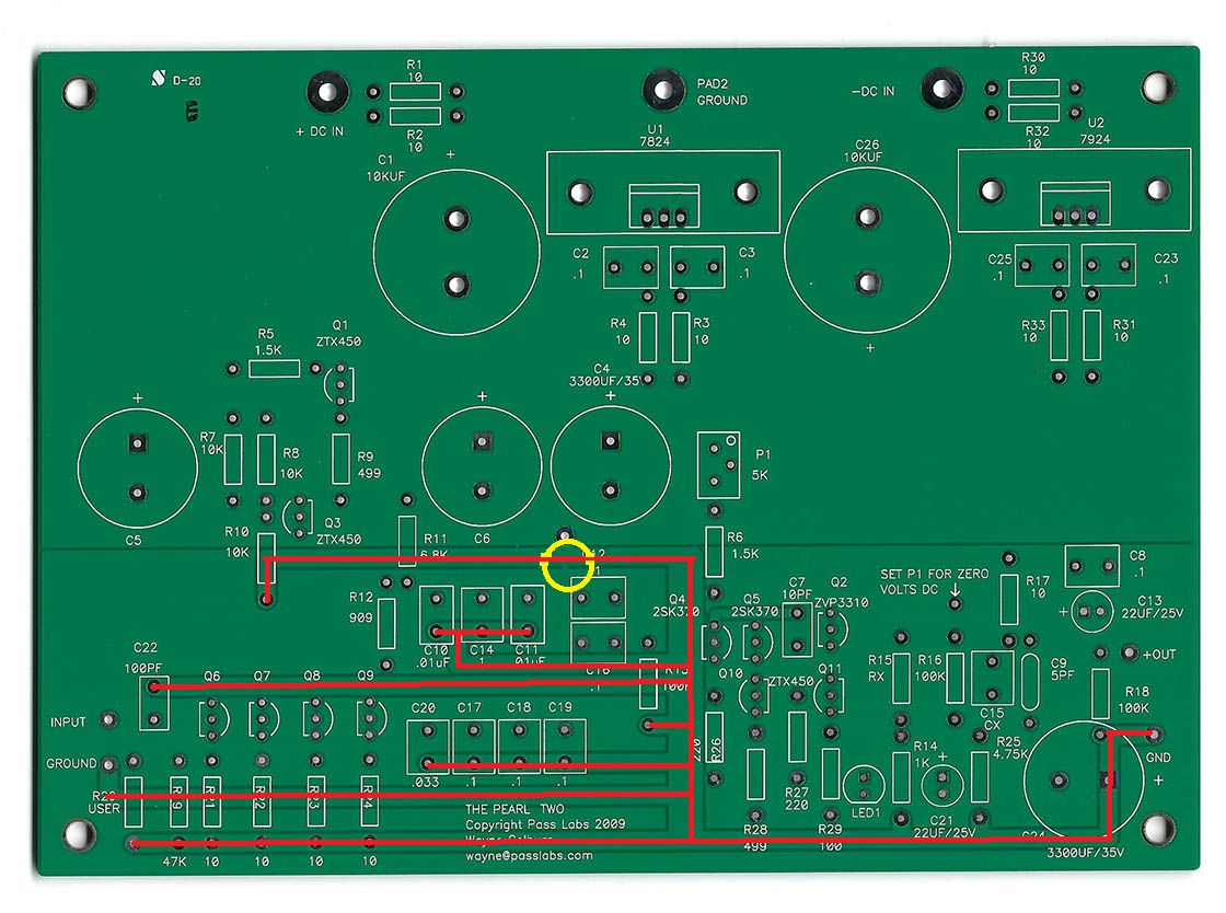

Here's the top side Ground regimen on the topside of the PASSDIY boards -- note that within the yellow circle is a somewhat high impedance connection between the copper "pour" and the preamplifier's grounded components.
If you flip the board over, the power supply components are all connected to a ground plane and this is again connected with a high impedance trace to the signal side of the board and grounding regimen.

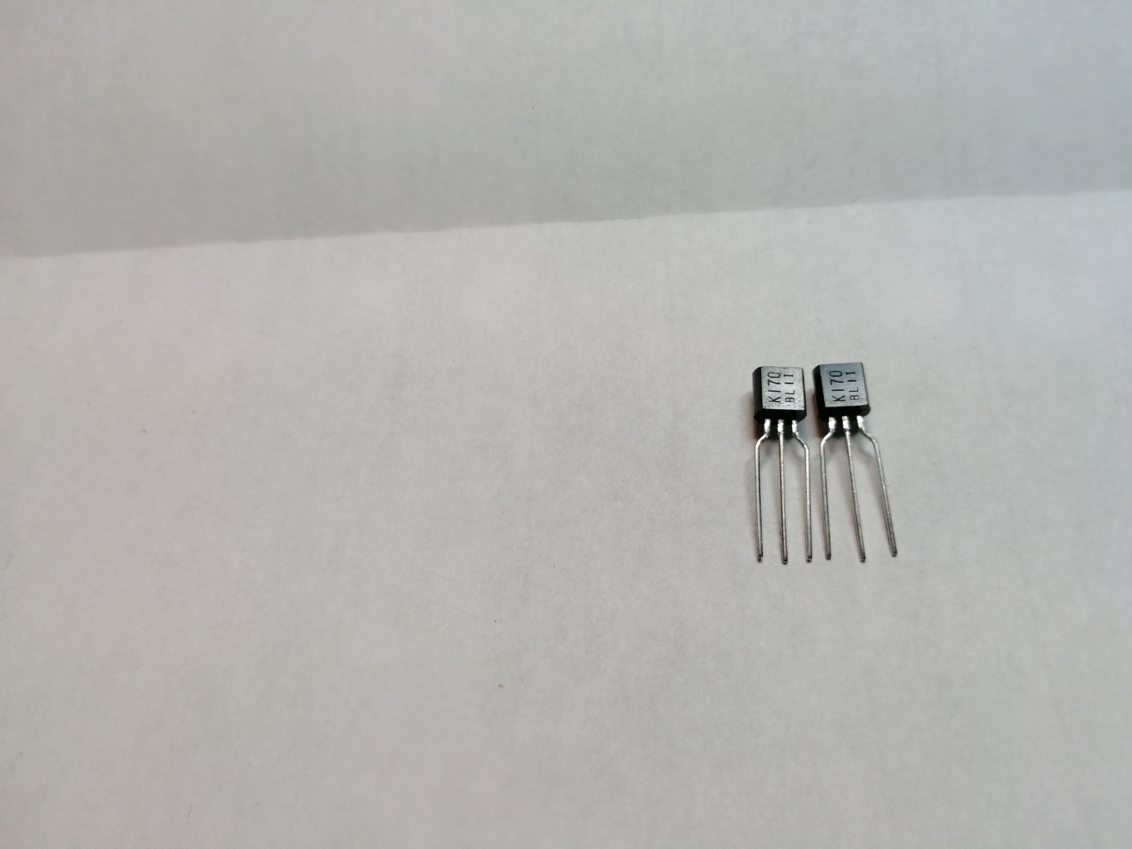

Can these be used, found in my parts bin

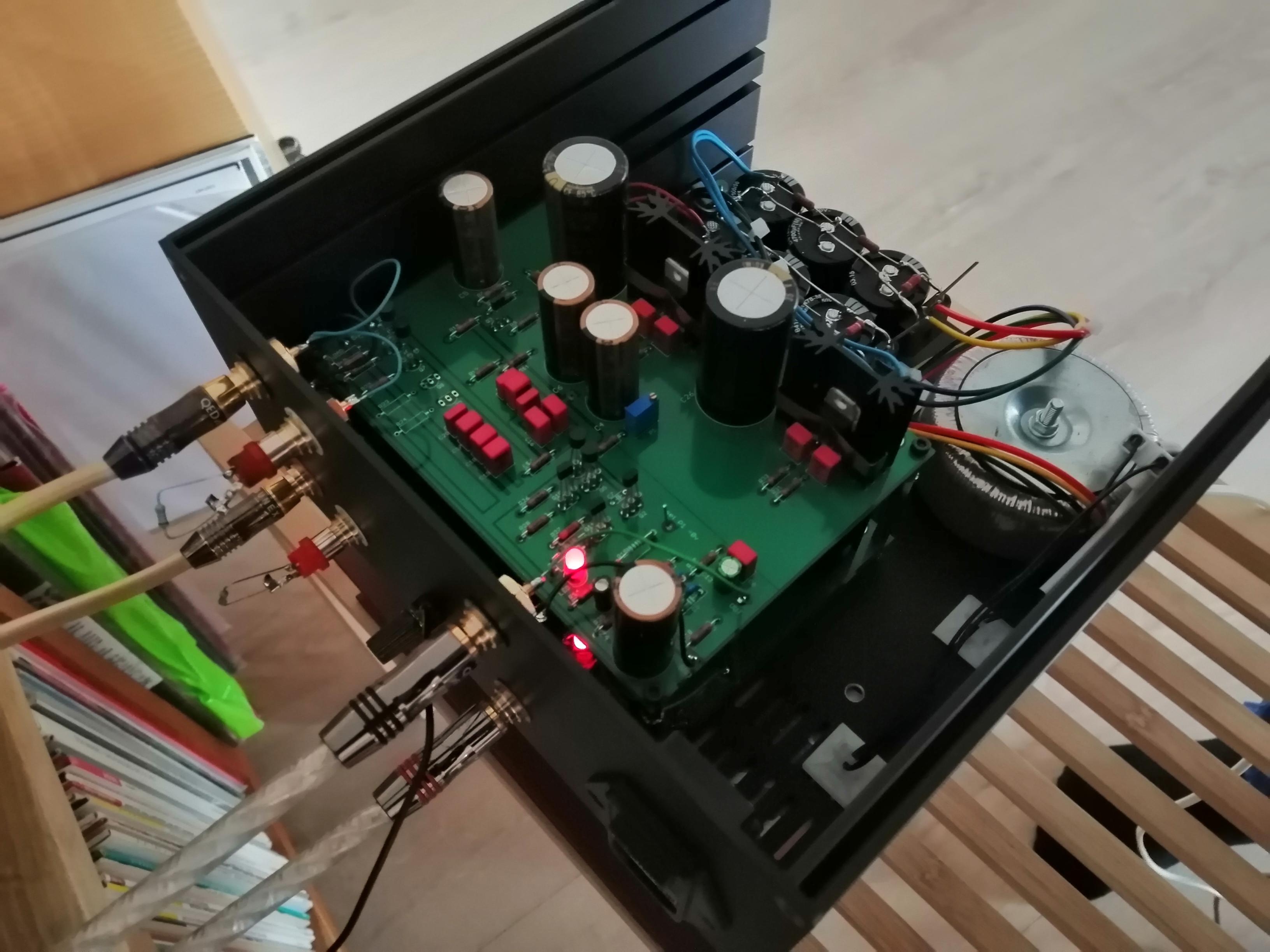

First test run of of my Pearl 2:
- I've used 2 pcs. matched k369 as inputs and k117 for the LTP in second stage.
- Not completely hum dead quite at "full throttle", but nearly (whatever that means), i.e. power transformer and PCB in same casing get surprisingly well along. I need to do a little work at rectifier bridge probably. Either "Quasimodo" approach or just head under arm capacitors across diodes approach.
- I run slightly less current (around 7 mA) in the FET at the output. I think it got a bit hot at 10mA, and output offset adjustment became sensitive to temperature.
- Omitting of C7 is a must. That took some time (Note to self: Read entire build thread next time).
- I'm embarrassed using boards from an Ebay "PCB copycat pusher" . At least, they are not from Wayne's gerber files I can tell, because then there would be no error in the layout :yes: (but it it could be fixed). I was tempted because they were inside EU. Long story short: I will use the original stuff and close my eyes for ridiculous customs handling fee next time.
- From fist impression sound is very good. I'm surprised about the firmness of bass. I've had to cheat in the RIAA compensation with design like Le'Pacific to get enough bass, but the Pearl2 is very good in that respect without "cheating". Maybe due to cojones of the MOSFET at the output. At least I think it sounds great.
