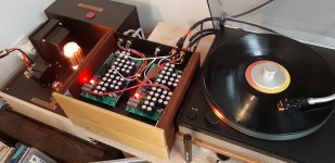

Building a Pearl 2

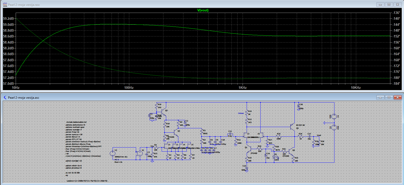

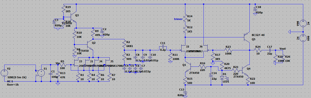

I had Pearl 2 with some problems, buzzing, humming and distorsions. Since I had no ZVP3310A at hand I decided to try to adapt to BJT.
After this mod, I works and sounds excellent. I still isn't finished, need to adjust offset a bit, but it works.
P.S.
Sorry if this isn't OK, since it isn't original design anymore. Just trying to help.
Regards
