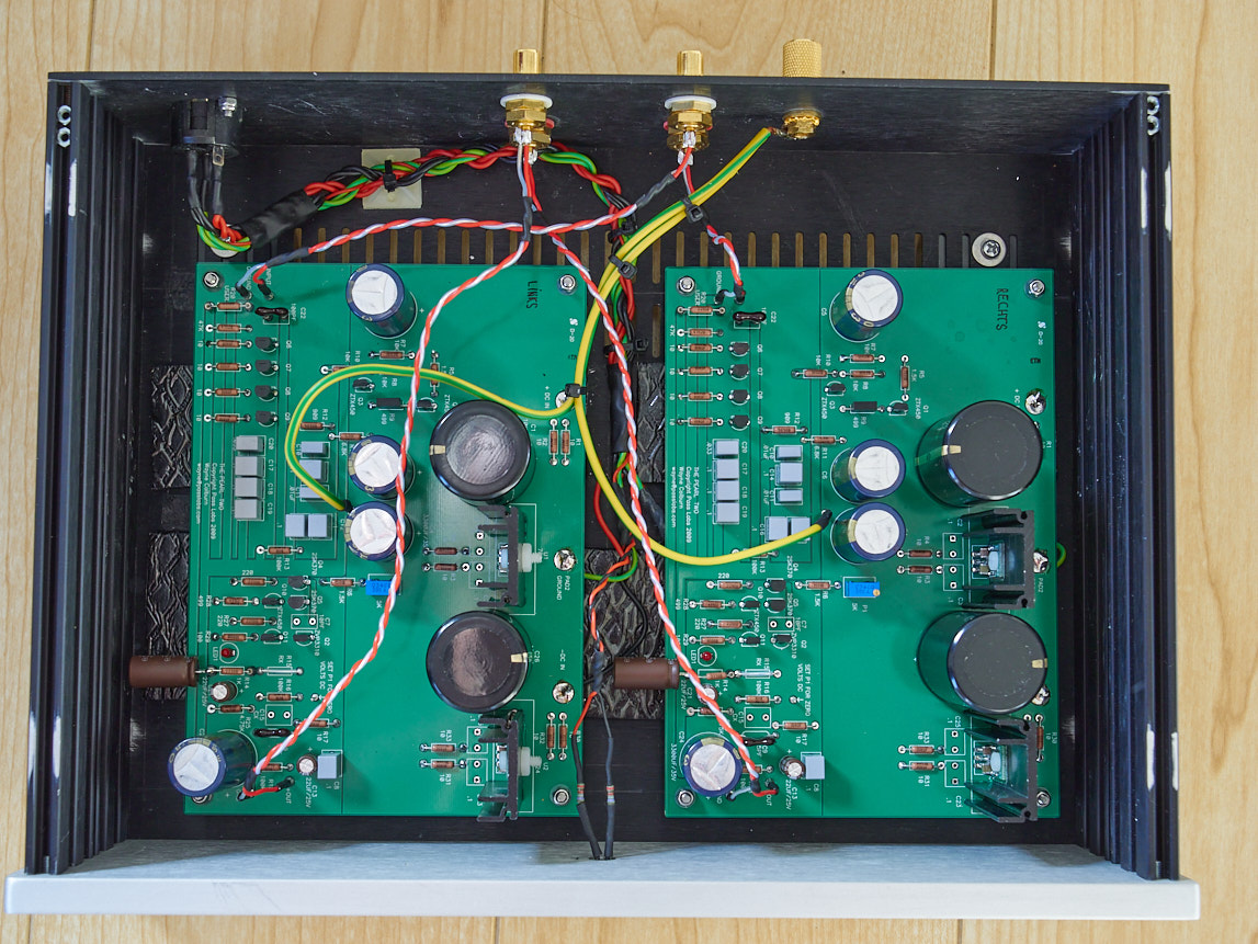

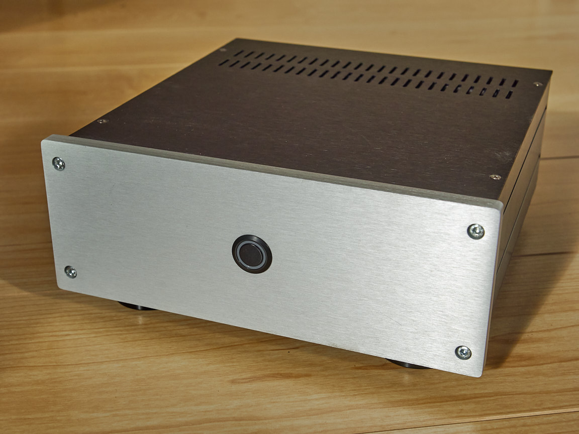

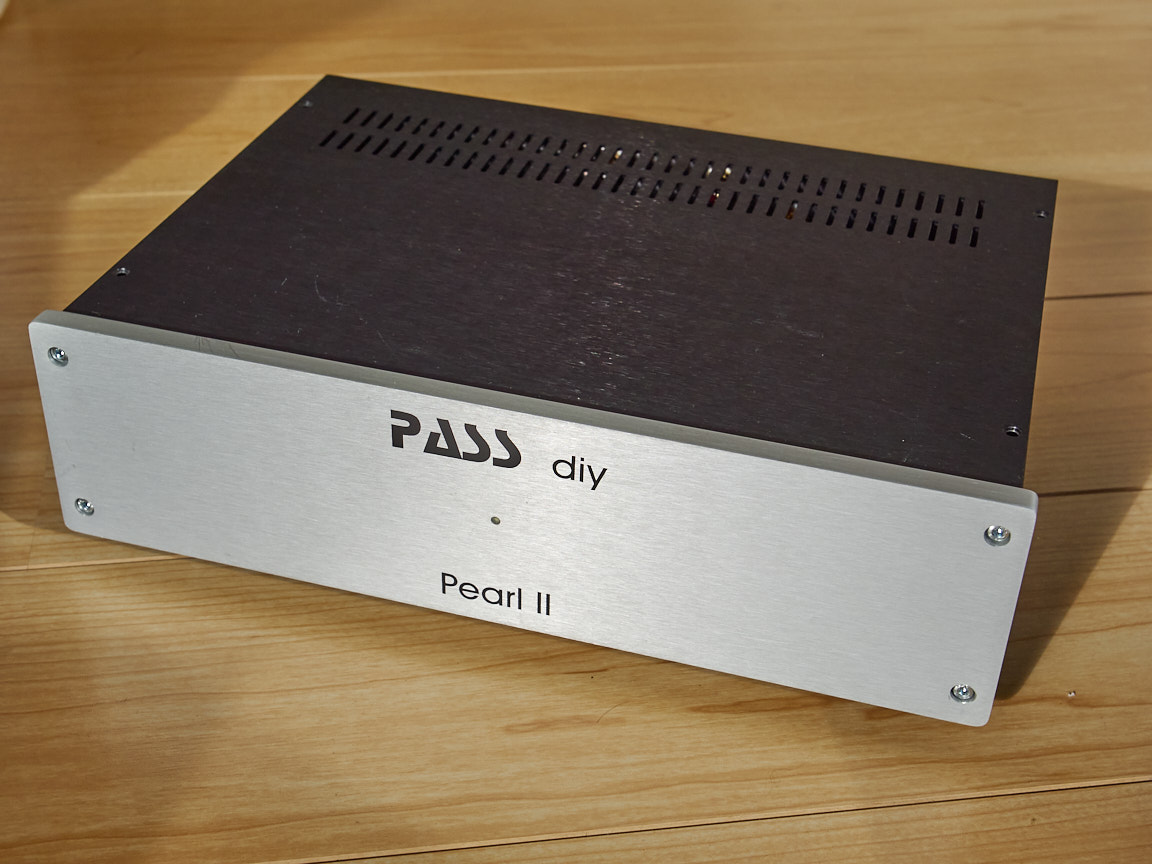

I’ve been involved with the Pearl 2 since 2011, and finished my first build in 2013. This was a version on perfboard. Since then I have done many tweaks to the PSU, voltage regulators, RIAA section and loading options. In 2019 I finally decided to do a rebuild on the official boards. I had held this off for a long time due to cost (almost 300 euro for the boards including shipping and taxes). Hiss was slightly less in this build (small point of criticism on my perfboard version). Recently I did a small modification which will probably be the last (never say never ). I changed the values of the RIAA correction back to stock. I always had the impression that the modified RIAA values made it sound a bit too lean in my system. I prefer a slightly fuller sound, so I went back to the original values. The difference should be pretty small and I can’t a-b the two, so I might just be fooling myself I also added the capacitor to R14 to stabilize DC offset (which indeed is now 0.000V). See pictures below of how it looks now.

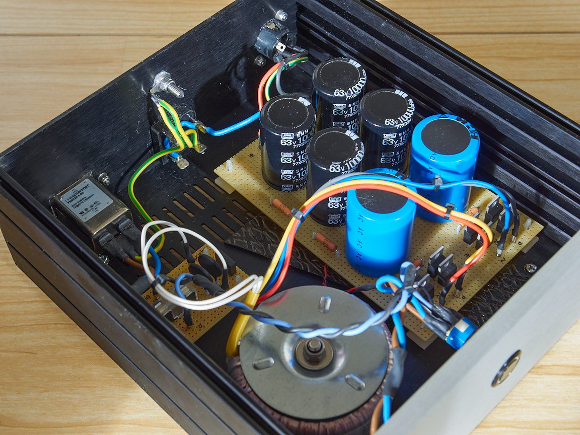

PSU is pretty standard. 2x22V Amplimo transformer 50VA with CRCRC. Rectifier diodes are Power Integrations LQA (fast/soft). The Pearl itself is set for about 57.5 dB gain, this works great with my cartridge (Benz Wood SL). 10k uF caps in the amp are Mundorfs, voltage regulators are Sigma 78 and 79 from AMB audio (soldering smd resistors is a real pain in the a**).
Oh, and just in case you wonder: I enjoyed listening to it in every incarnation. The Pearl will see use for many years to come! I will keep reading this thread, hopefully it will not infect me with the tweaking-bug again ;-)
PSU outside:
PSU inside:
Amp outside:
Amp inside:

PSU outside:
PSU inside:
Amp outside:
Amp inside:
@Wellerman, how are you switching power for the PS? I can't quite make out what's going on with that small perf board or the wiring at the switch.
Wiring is hidden away a bit in the left side panel. You can see the blue and brown wire that come out of the mains filter/IEC inlet appear again at the front panel going to the power switch. From the switch a blue and black wire go to the small perfboard. On the small board are a fuse, 2 NTC's in series for inrush current limiting and a small 0.0033 line rated capacitor. After that, white wires go to the transformer.
