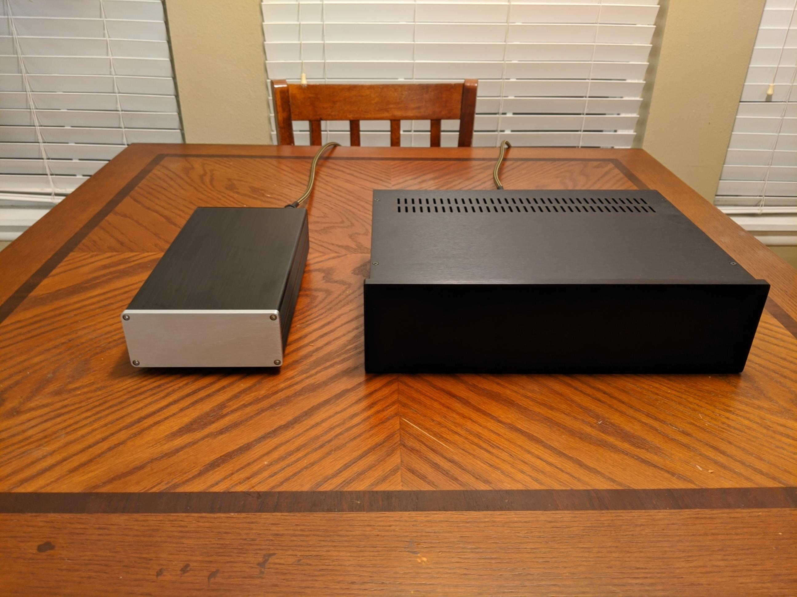

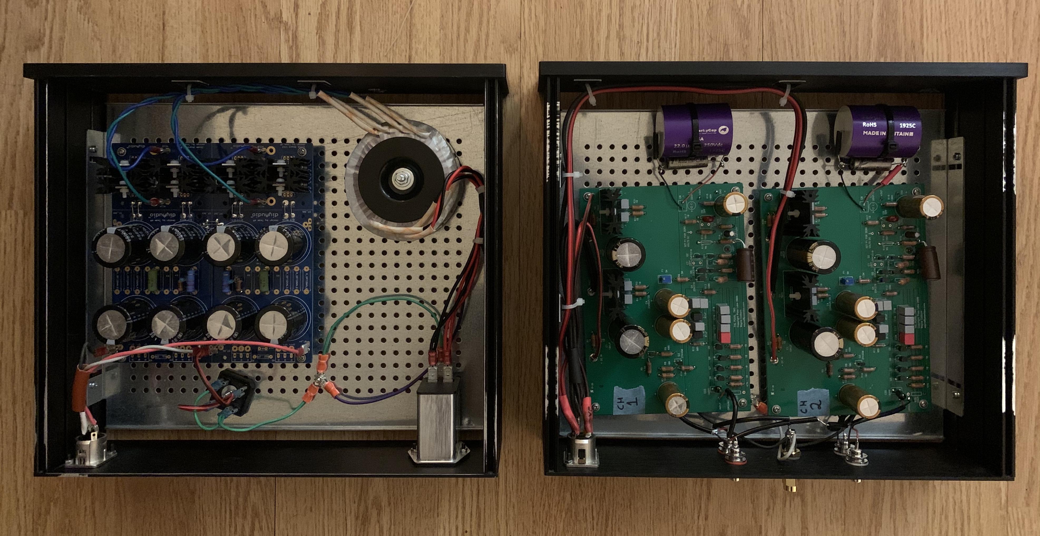

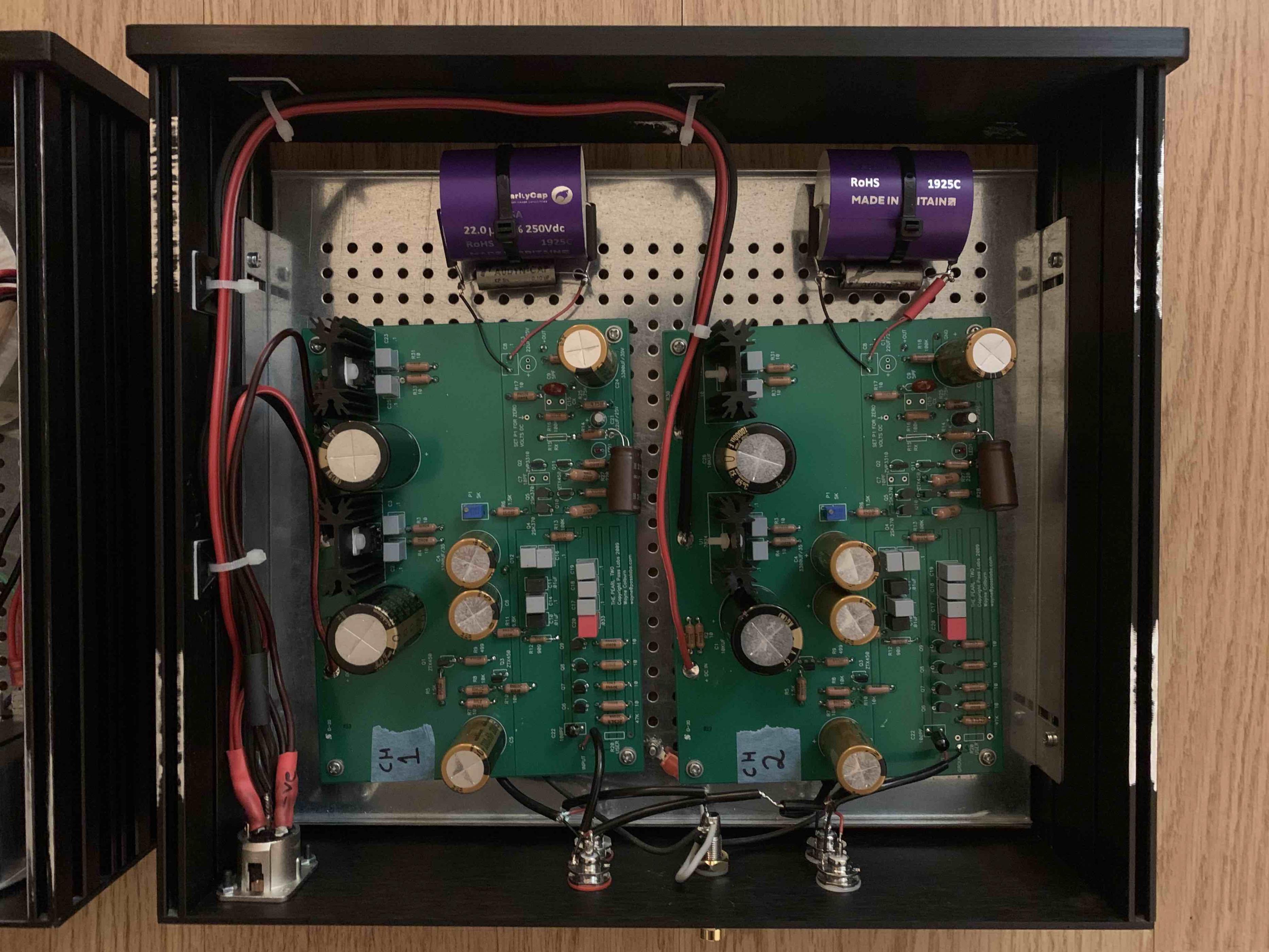

I tested my build yesterday and it seems to be working fine. I did add the capacitor in series with R14 and that made zeroing the DC offset quite simple.
I built it stock with Dale resistors and Wima / Vishay FKP caps, but used some claritycap / Audyn caps as the output capacitors.
Last bit was to make the umbilical cable - used 4Pin XLRs and some Canare 4s6 cable which came in the mail today - spent the afternoon listening and it is glorious! Thanks to Wayne, 6L6, and the numerous others here whose advice is to thank for music, rather than smoke, coming from the system today!

Regarding the big output caps 2 posts up: has anyone noticed an improvment in sound with regular caps in stead of electroytics (Silmic II or similar)? I don't see those in commercial Pass products (then again, I don't know if they have output caps). Or is this more one of those highly debated topics?
Official Court Jester
Joined 2003
if there is big (value) cap needed, Silmic is one of the best options, thinking of sound and price and availability
I have a habit to bypass them with polycarbonate (Philips MKC) and then I'm happy, that being decided level of effort I'm putting in that
if I'm going to DC coupling, it's more because of intellectual challenge than because of sound benefits
yeah, like all, I was obsessed with caps not being in signal path, before...... but in a meantime I did learn to see some of them actually being in signal path, even if not directly, so - after that, I simply changed my intentions - making nice and simple and enjoyable, instead of trying (unsuccessfully) to make another Halcro
in short - try what bothers you, but be practical - it's much more rewarding chasing some vinyl, instead of chasing just another set of caps
Welllerman, ZM has sound advice as always. Everything makes a difference, whether it is worth it is another matter altogether (and physically larger / more expensive does not always mean better sound).
For what it's worth, Wayne voiced the circuit with the Silmics and recommends them in his BOM.

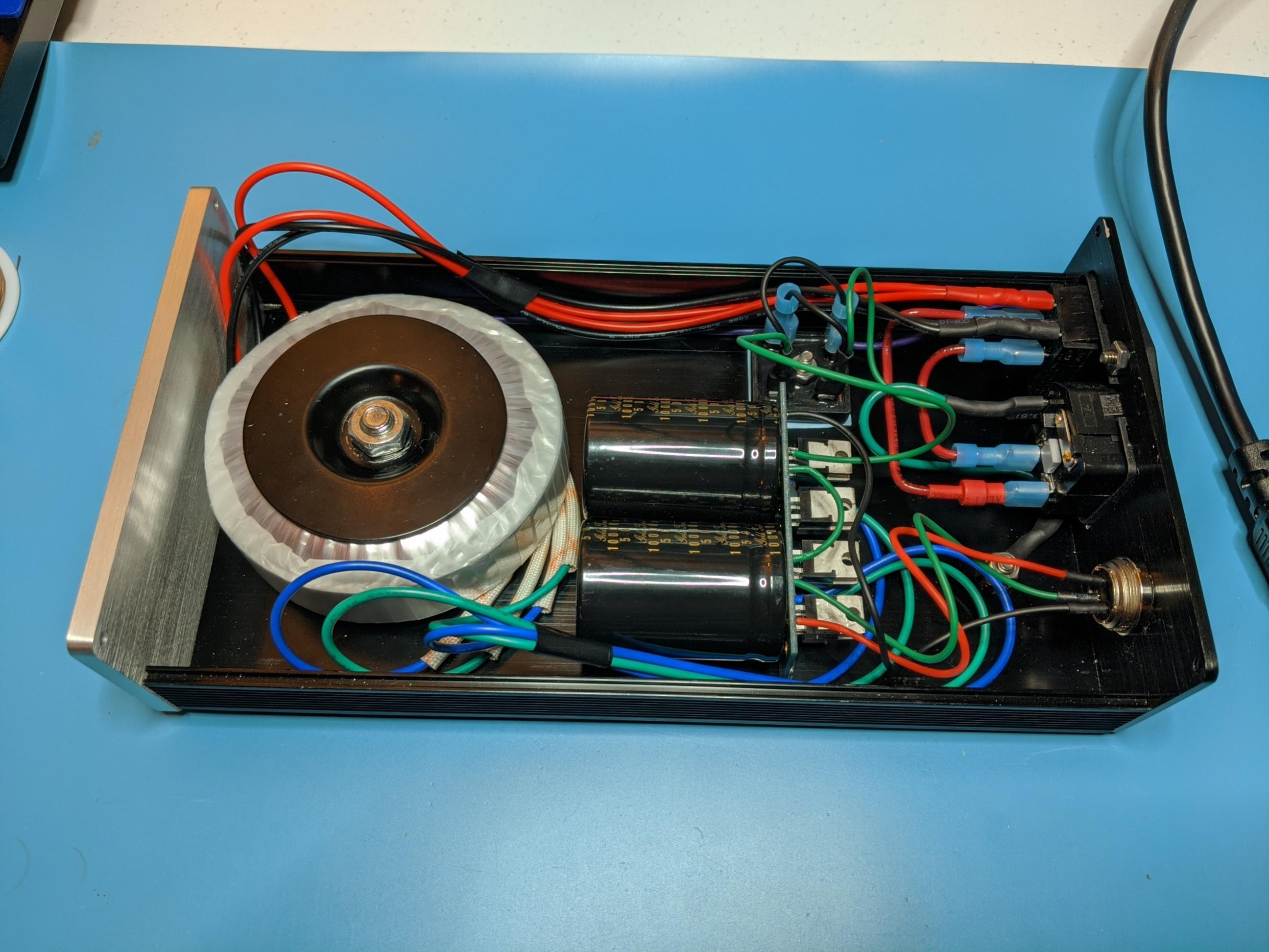

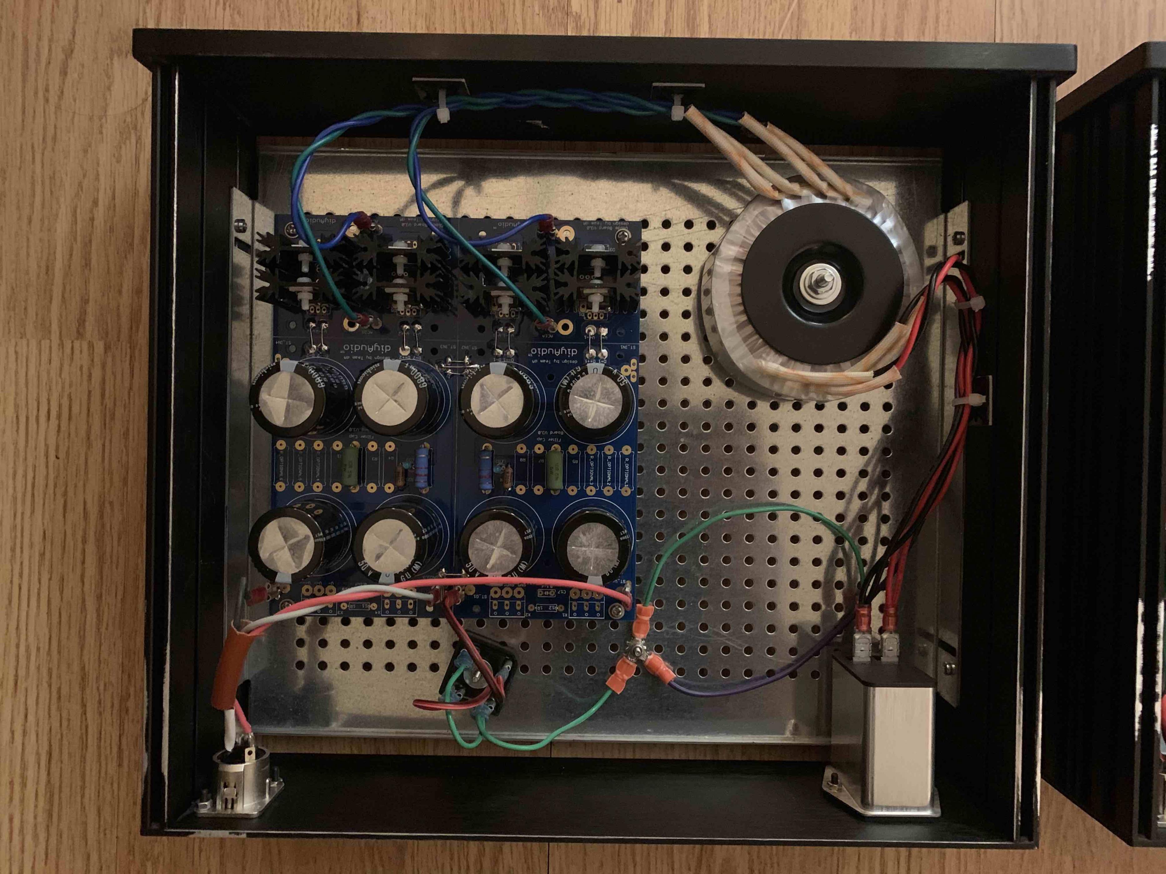

Since my last post, I've tried both Pearl 2s with my cartridge on a Sota table and heard the same thing--severely rolled-off highs. It's still a mystery why my Ortofon Blue doesn't play well with the Pearl 2, but I prettied up my PSU so I thought I'd post it. I hot-glued the caps down to the chassis, but I might try to come up with a sturdier solution for peace-of-mind.
