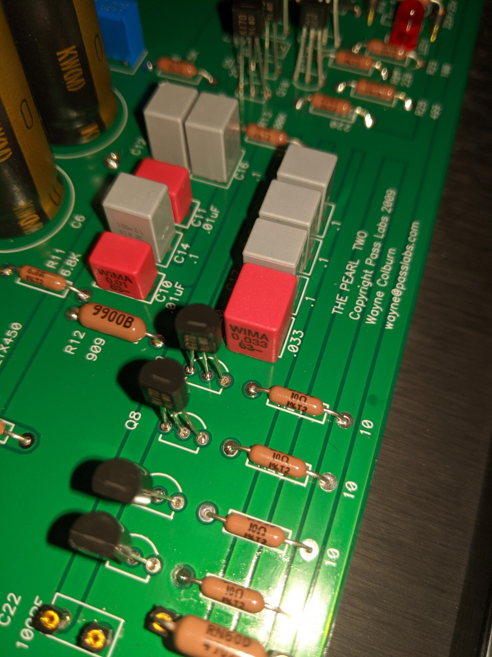

Are the RIAA caps the proper value?
R12 is 10% high, that may be worth getting the proper value, as it's an EQ resistor...
Pretty sure all my RIAA caps are to spec.

I don't have any 909 ohm resistors on hand to give that a try. I might have to place an order and pick up a few more 3310s while I'm at it just in case.
No, that's the right value. 909 is incorrect as I have demonstrated on numerous occasions.

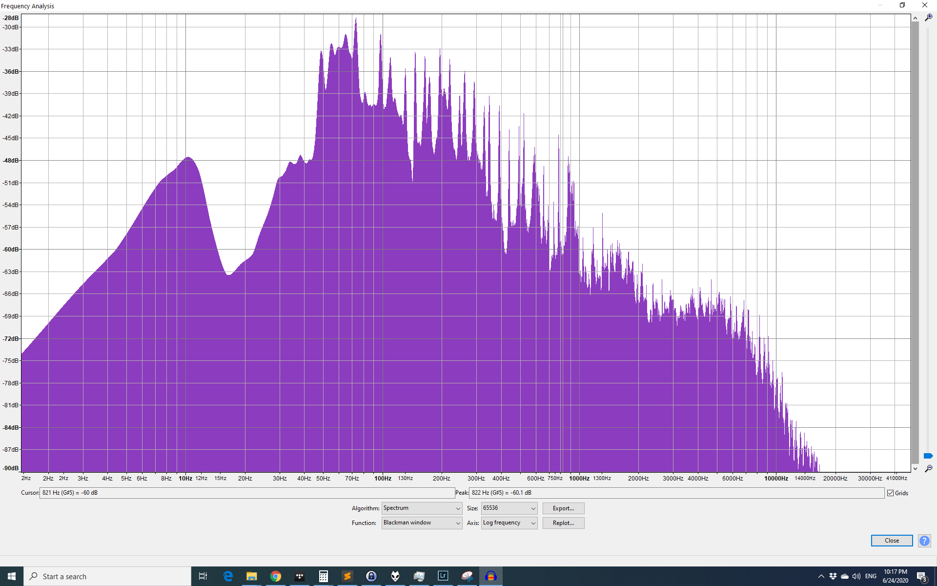

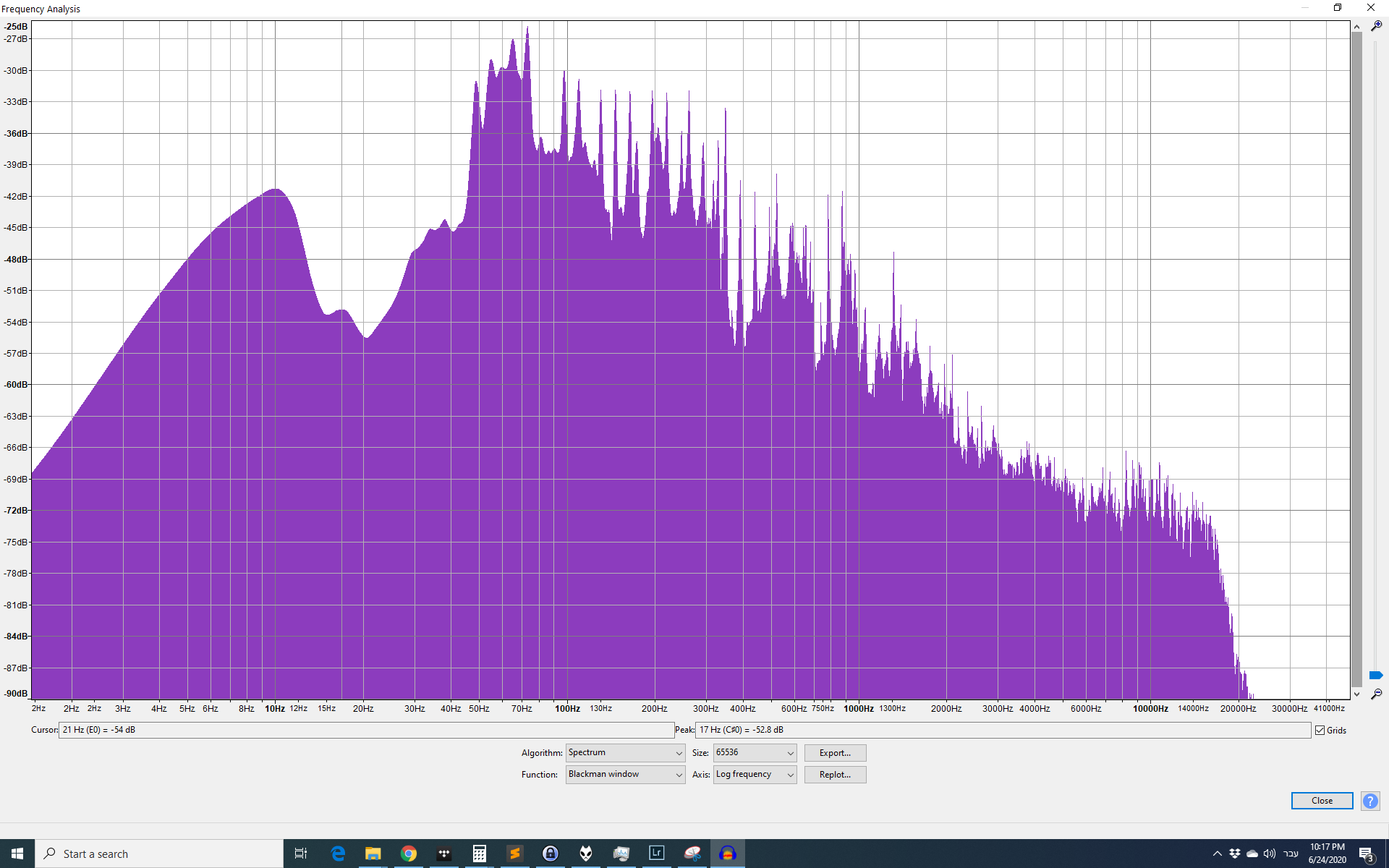

I've recorded a sample of my table playing through an NAD pre-amp and my Pearl 2. Due to recording limitations with my audio-interface, I could only record the right channel. However, the issue is still easy to hear. I'm terrible at describing what I'm hearing, so hopefully this helps narrow down the problem.

I took a listen to both samples, at first try the issue wasn't clear to me which is further proof of how much of a horrible "audiophile" I am.
After 2-3 listens it was apparent that the Pearl2 sounded a bit "muffled" which is the best I can describe it.
One additional thing to note is that the NAD is a few dB louder than the Pearl2, which is surprising as the Pearl2 has more gain than the typical MM preamp.
I plugged in both WAV files into Audacity, and it indeed shows an issue.
The Pearl2 looks to be rolling off from 10kHz (or even slightly earlier).
I'll leave it to the experts to understand what may be causing this.
On the bright side, looks like your resonant frequency is around 10hz which is good, and it is a bit more dampened on the Pearl2 (likely due to Waynes subsonic filter).

It looks more to me like the Pearl has an flatter roll off and the NAD has a slight bump up at 5K.
I don't think I'm seeing (or hearing) what you are. The Pearl 2 spectrum is on the right. What I hear and see there is that starting at 5kHz, the Pearl 2 starts to roll off. Beyond 14.5-15 kHz, there's just nothing at all. It kinda makes it sound like it's playing in another room or I'm underwater.
Well, oops. My bad. You might consider buying or building an inverse RIAA filter and comparing their frequency responses using REW or some other analysis software:
