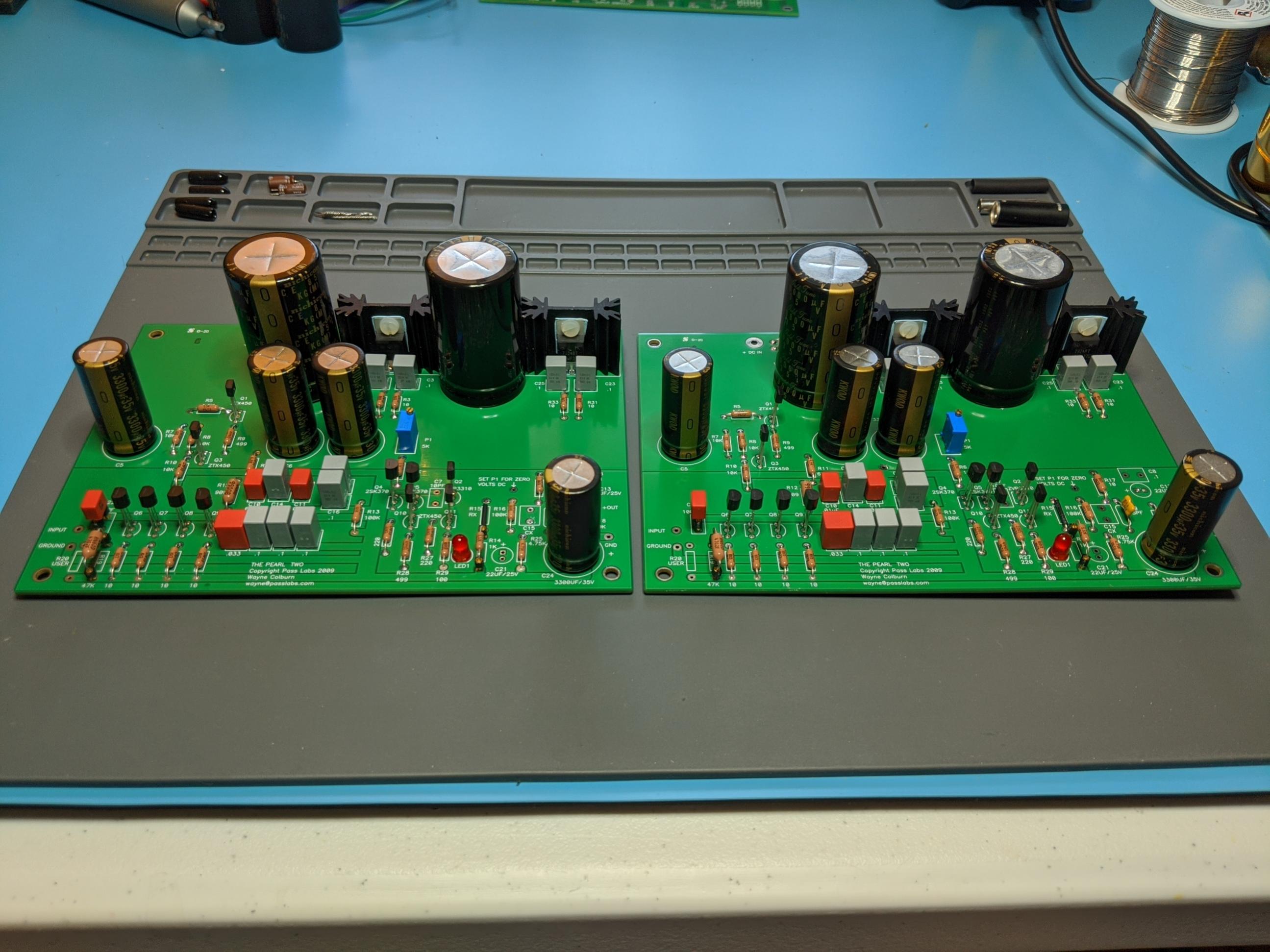

Got mine together last night, but it doesn't sound right. The symptoms sound similar to what others have diagnosed as a bad Q2--distortion and clipping. How can I test to confirm that this is the problem before I break out the solder sucker and replace those MOSFETs?

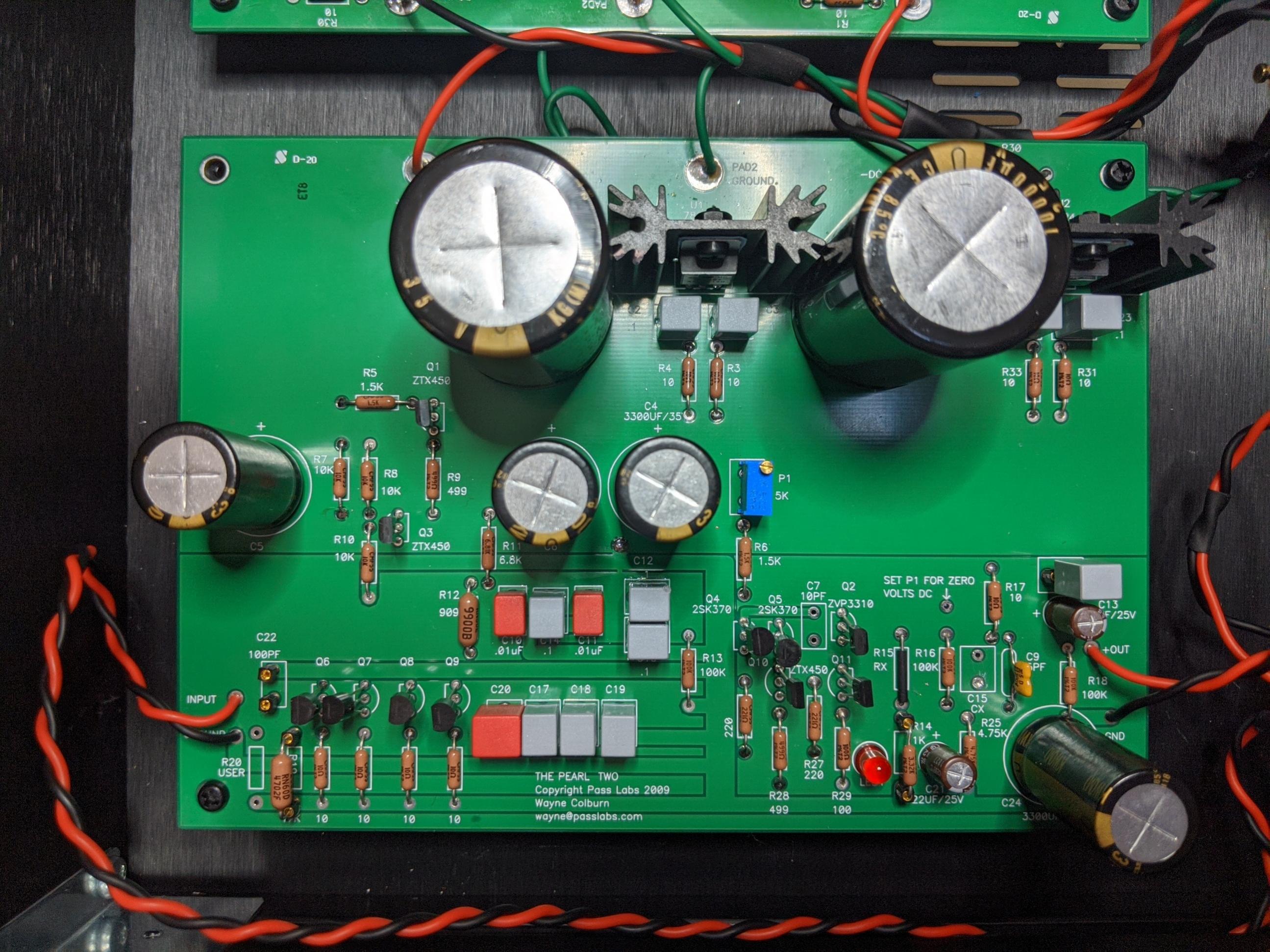

check that you didn't put the caps in the wrong positions.

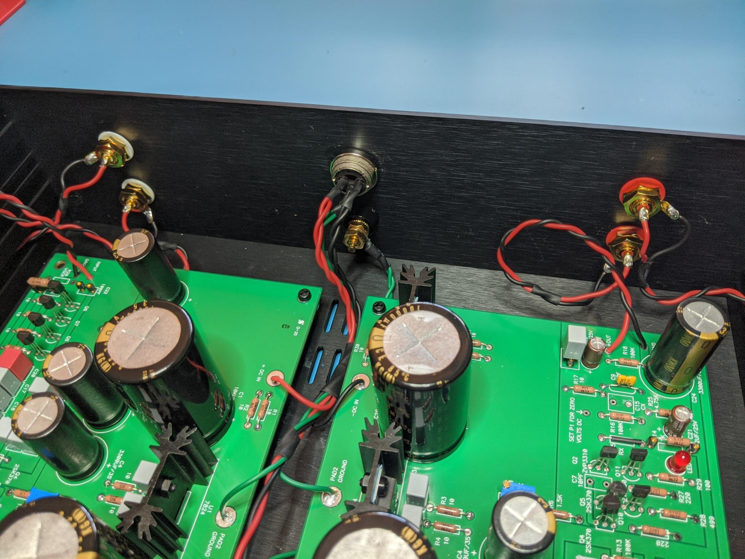

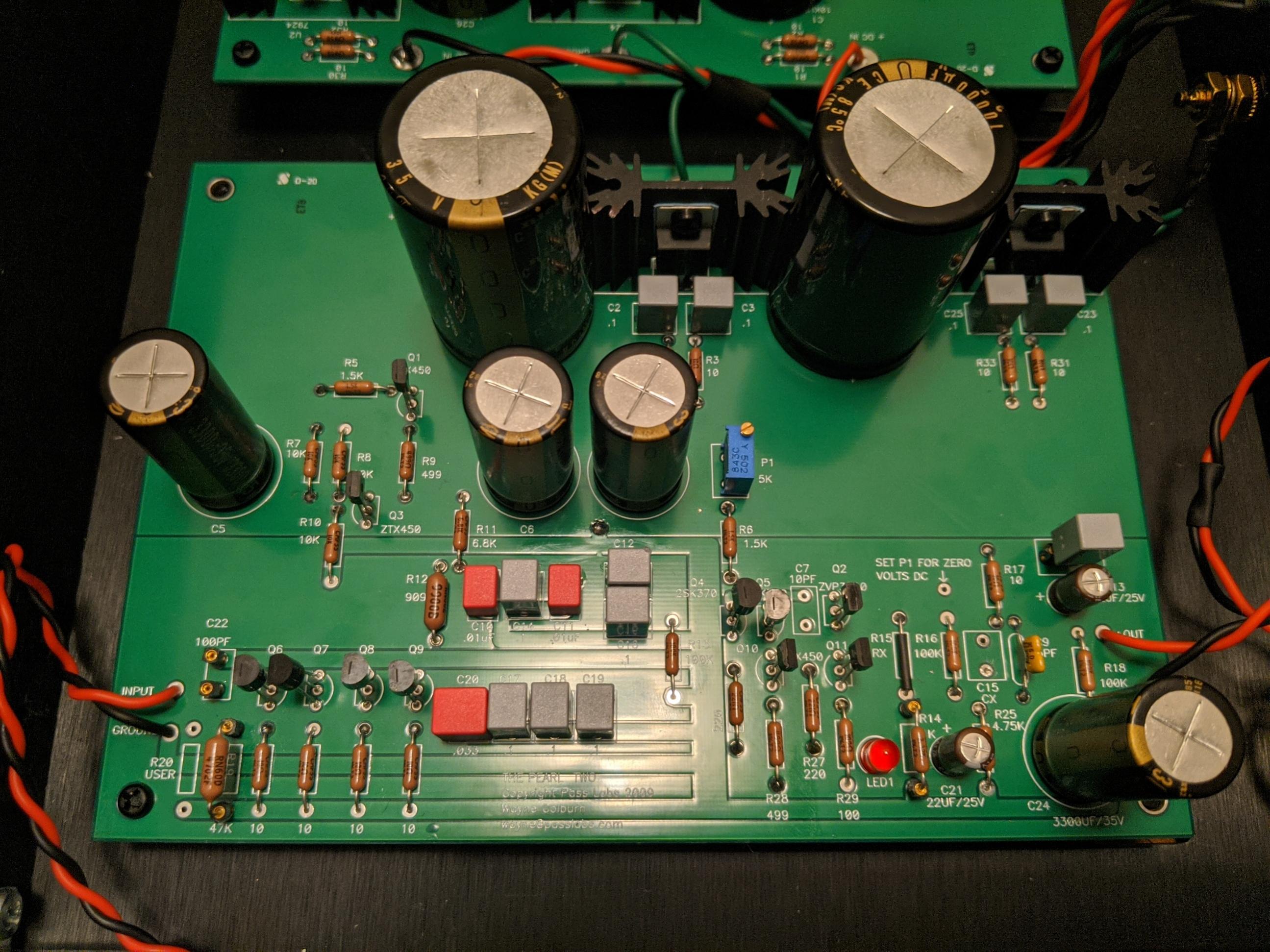

Anything look out of place? First pic shows both boards before I got them in. Both boards seem to have the same issue. Second pic is one board in its current state. I'm only messing with one until I get it right. Sorry about the lighting, it's the best I can do at this time of day.

It should be quiet with inputs shorted. Can we see photos of the back panel (inside) as well as a couple of the PSU.

Is the chassis actually attached to ground? (At ground post is the best place)
Does the metal outside of the umbilical jack connect to ground?

The chassis is not attached to ground. The frame of the umbilical plug does not connect to ground.
Attach the ground lug to chassis.
Make sure all the panels on the chassis have the anodizing scraped away in spots so all the panels are electrically connected.
This is most likely not the source of your issue, but it’s going to need to be addressed at some time so you might as well do it now.
