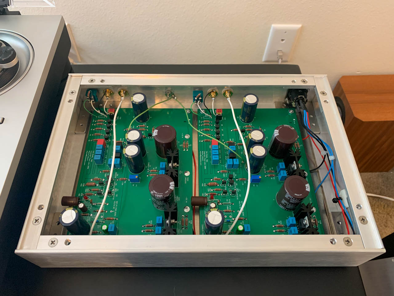

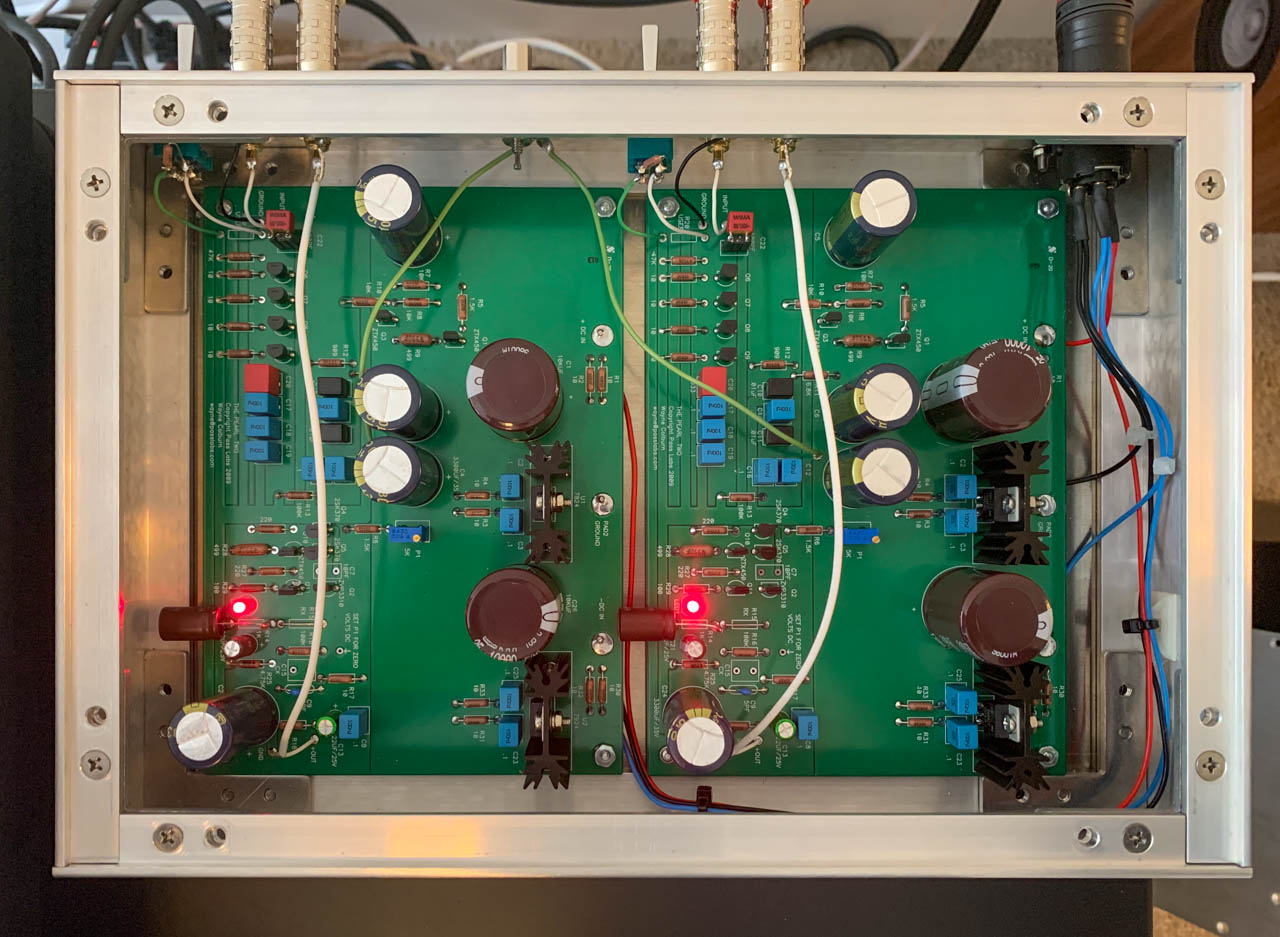

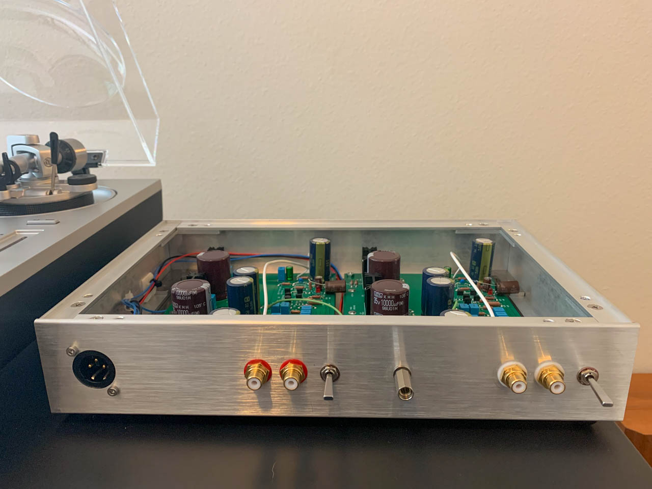

Another Pearl2 is born... have it hooked up and playing nice music.
I optimized my layout for minimal input wiring and small footprint.
Capacitance loading is adjustable with caps on pin headers.
Resistance options are 100,470 and 47K with DPDT per channel.
Chassis by Landfall systems which came out perfect.
2 final notes regarding some questions asked by myself or others recently:
1) I built the PSU exactly per Wayne's schematic with the Antek AS-0522. Connected to both boards, the unregulated supply is 29.2-29.4V.
2) I was slightly concerned with the high gain since I'm using a 4.0mV MM cart. It turned out just fine since overall I don't have high gain in my system. Preamp based on AMB alpha24 line stage with 5x (15dB) gain, and power amp is a Benchmark AHB2 with low gain setting (9.8Vrms input sensitivity)

Super nice build.
Thanks alot!!
The power inlet is just a standard XLR. They are rated for 50V, 16A so no issues there.
I typically prefer the Switchcraft Con-X connectors for DC power, but I had a few XLR spares that would go to waste otherwise.
The switches are TOCOS, which are really beautiful switches. They are out of production but Michael Percy has some DPDT and 4PDT left. Otherwise, I use NKK from Mouser/Digikey which are very good as well
