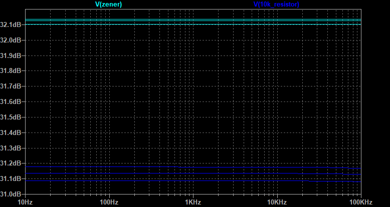

Substituting a 3.3V Zener diode for R10 (10k) will add about 1dB of gain to the first stage, and, as Vds of the input JFETs is reduced to about 2.8V there is less heating, better thermal compliance.
Illustrated:
I definitely want to try this one. Great observation!
...except when you change one parameter, you have to change others. THD% is going to be higher according to my measurements.
gain is a bit over 1dB higher using the Zener.
it's very difficult to compare the sound -- I've soldered in some Molex female headers so R10 can be swapped out for the zener.
noise is equal under both circumstances.

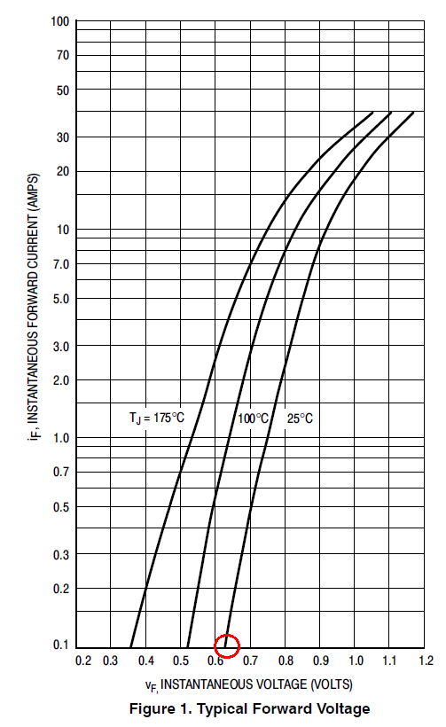

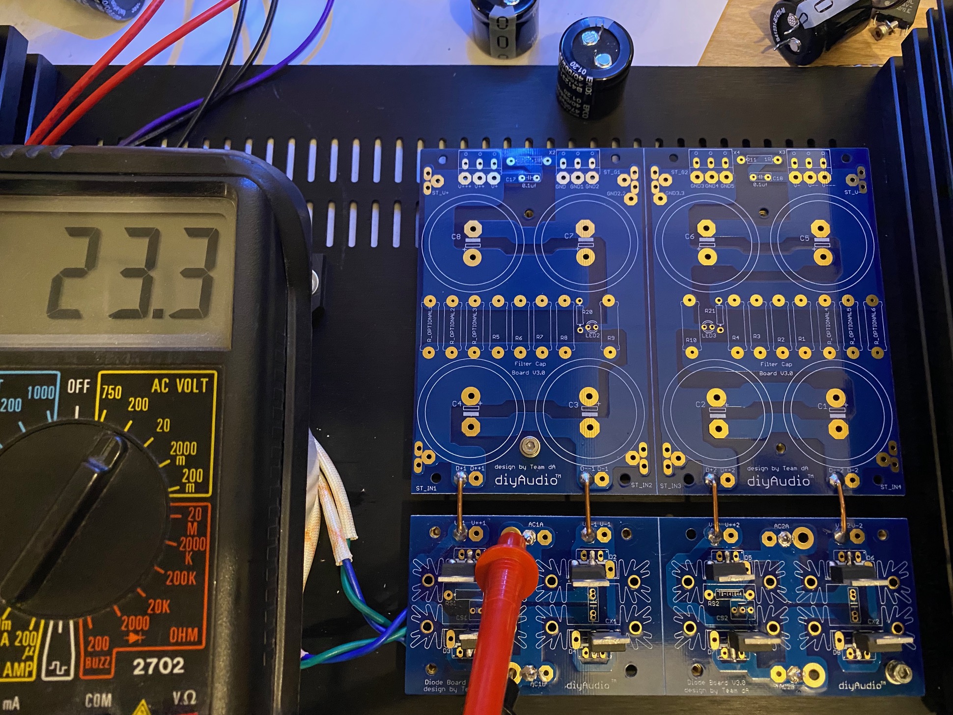

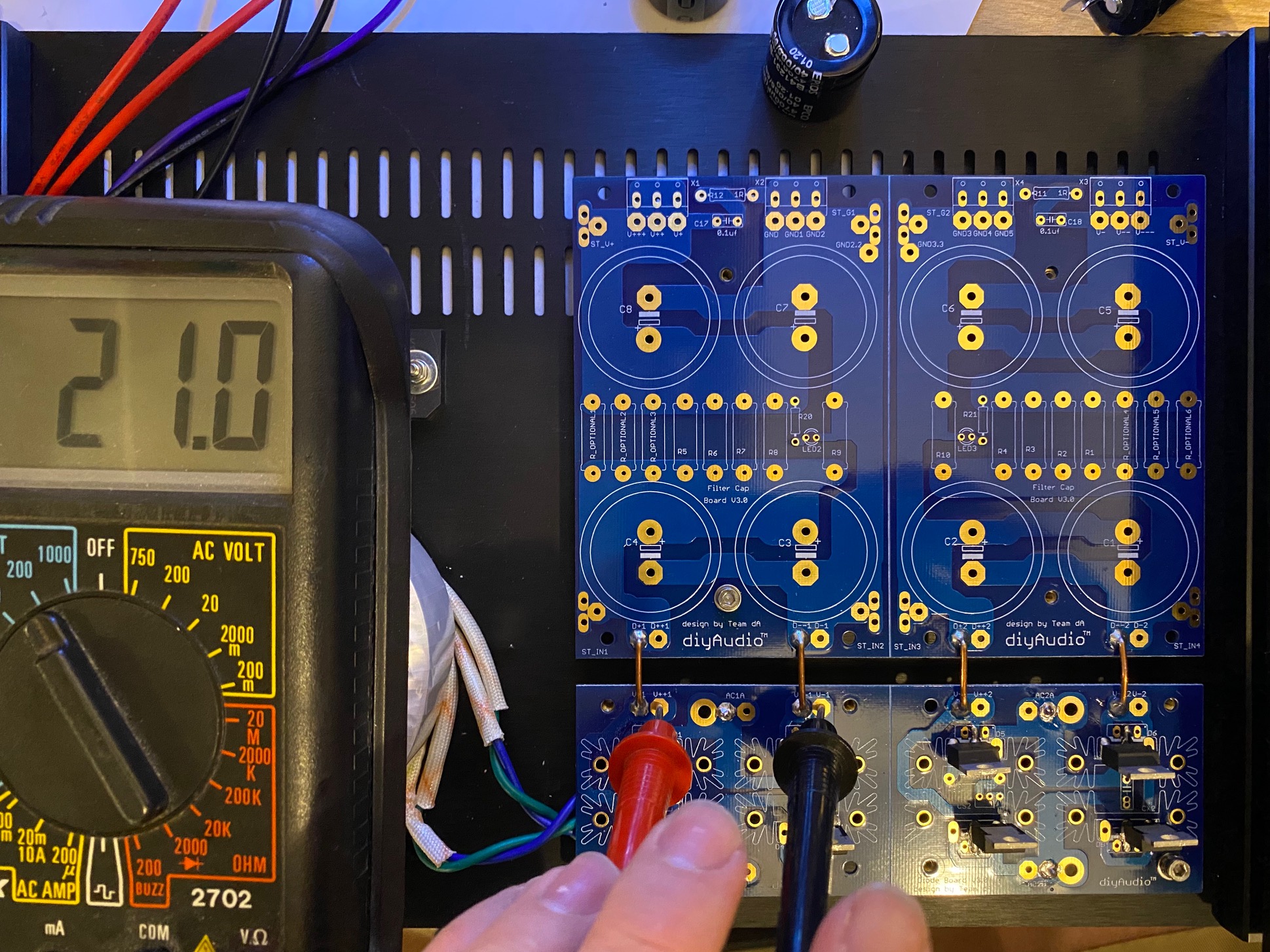

From the wise advise of 6L6 I decided to swap my little standard diode bridges for some MUR820's I had laying around in the parts bin. Now that they're in I think I have an issue. I'm seeing 23.3V at the secondaries but only 21V after the diodes. My mains voltage is about 123VAC. I measured all of the diodes in circuit and I'm getting the same parameters for all (8). I also tried swapping the secondaries and there was little to no change in the DC voltage. Do the diodes act differently without caps in the circuit or the PSU board not grounded at the moment? Or are all of my MUR's somehow bad? Should I stop typing and just solder the rest of the circuit together and test again? 😛

Yes the capacitors are an essential part of the AC-to-DC conversion circuit; leaving them out leads to unrealistic wild misbehavior which you can observe with an oscilloscope if you want. But who cares really; it's not a real world situation and the measurements merely answer the unimportant question, "What happens if I connect the components of my power supply incorrectly?"
The datasheet of the MUR820 tells you what forward voltage (from anode to cathode) the diode will drop, when you're pumping 100 milliamps through the diode. Red circle. Now it is up to you to extrapolate and estimate what the forward voltage will be when you're pumping only 1 milliamp through the diode. {hint: think in decades. 1mA is two decades below 100mA}

Looking at the photos it seems to me that the bridge board and the reservoir board are not wired according to the (idiosyncratic) configuration of the Pearl 2 PSU.
Shouldn't the bridges be connected together and the dual bridge connected to just half of the circuitry available on the caps board not all of it?
