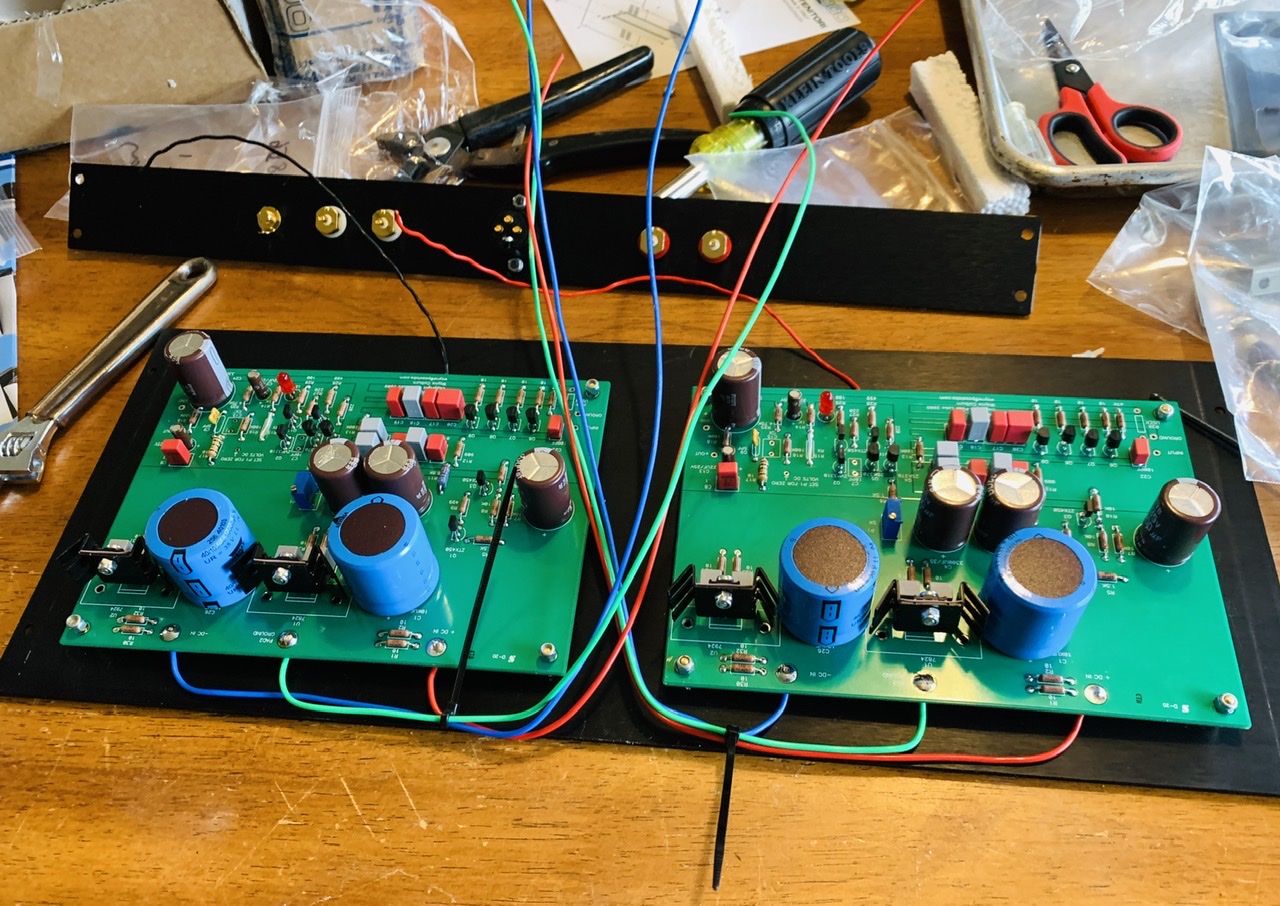

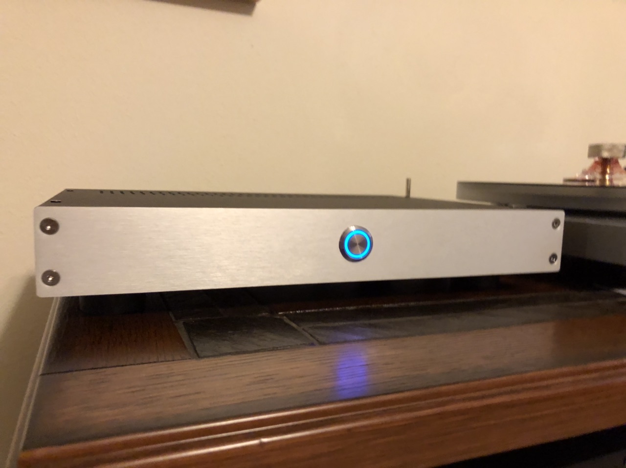

If you haven’t already bought your chassis, I used a 1U Galaxy by laying the 10K uF caps on their sides and finding 30 mm 3300 uF caps. The heat sinks aren’t a problem. You have to use short standoffs and still won’t have much clearance in the end but it will fit.i just really like the low profile.

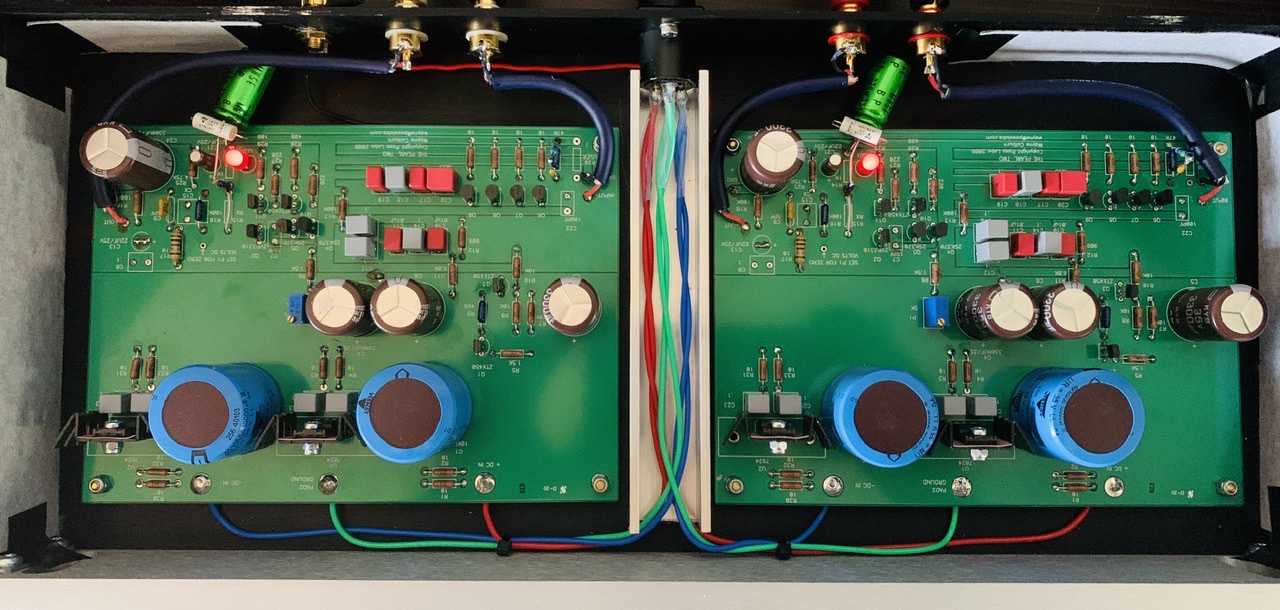

To fit 1U I ended up going with a slightly larger diameter for the 15Kuf caps and bent the regulator heat sinks to accommodate. Also, I’d advocate for bringing power right down the middle and using some kind of mu metal u-channel to shield the power wiring and create some separation between left/right channel.
