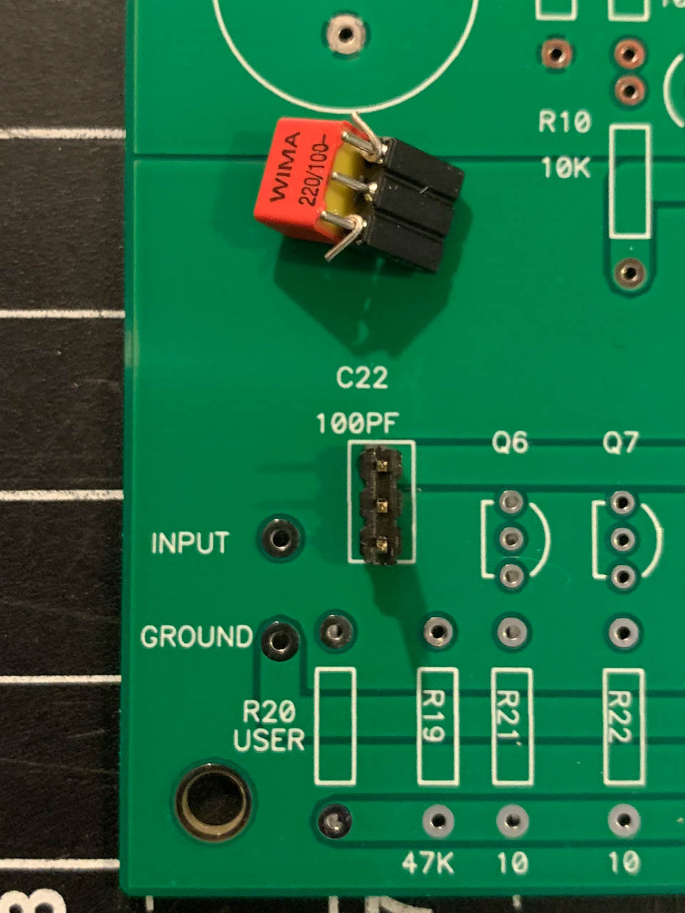

My Grace F9 specs 220pf I think, but I’ve tried with and without and preferred nothing at C22. Add sockets if you want to try different values.
The Audio-Technica MM carts spec asks for 100-220pF, although many state that FR is best in the 100pF region...would it be recommended to use something like 50pF, or none at all?
I have an Audio Technica AT-150MLX MM cartridge with 5.0mV output. I rewired my tonearm with KAB SuperFlex Litz wire and replaced the original output cable with 1.0m of BlueJeans LC-1 cable. This resulted in total capacitance of of ~57pF for each channel. For me and my system, I felt this was a little bit too low, it sounded like it robbed treble. After listening for some time, I added 82pF in the Pearl 2 for a total of about 125pF per channel. This added the treble that I was looking for. I've had it this way for the past four years now and really enjoy it.
If you want more treble, add more capacitance. If you want less treble, add lesser amounts (or none) of capacitance in the Pearl 2. I really appreciate the ability to dial in the sound to my liking.

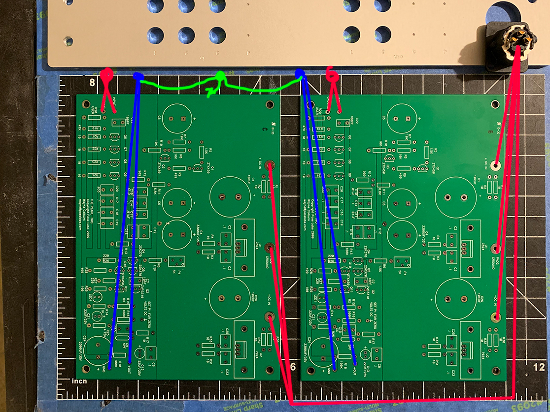

I have been spending alot of time figuring out good layout.
I want to have short input wires, not too much of a rats nest and still allow for various input resistances for MM/MC (something like 100-470-47K), and allow for tweaking capacitance in case some cart needs more than minimal.
Attached is a sketch of how I would wire it, which addresses inputs, outputs, power and ground binding post.
I think I have an elegant solution for the capacitance loading by using pin headers and receptacles.
Connection between the header and the housing is very solid, much better than putting the thin capacitor leads directly in a socket.

This has been on my mind too as I am gearing up to realize my Pearl (1) build. Here's my current thinking.
Unless one is intent on "playing" with cartridges and tonearms and 'tables a phono stage is more or less a set-and-forget in-line component. Vanity aside it can reside behind the deck and the preamp. So...
I'm planning to stack the boards on edge. Inputs on one end, outputs on the other and the power umbilical organized to feed the boards at or near the top of the case. The wiring would be short and well-separated.
One other wrinkle I'm considering was inspired by Tom Evans' Groove. The Groove has a reputation as a very quiet stage yet it is housed in an acrylic case. Evidently, the good performance is due in part to a (pseudo?) Faraday cage made out of copper-clad PCB material placed on either side of the signal board. I figured on stacking these with the Pearl boards and then finding a nice box to contain the assembly.
It's a plan. One plan.
I’m putting mine together (Doing the PSU now) and this is pretty much exactly how I’ve planned my wiring for the phono case. I was planning to take the output wires around the boards, but perhaps going underneath is a good idea!
I’m putting in a 2U Galaxy 330x280 chassis, yours looks to be a similar width.
I had considered this too. I like the the symmetrical wiring aspect and short power feed.
Yes, pretty close. I'll be using a 12"x8" case.

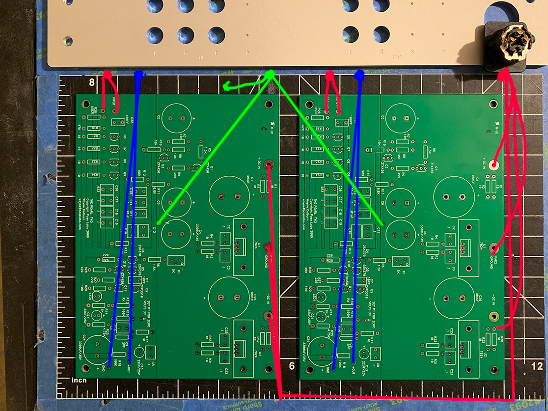

One alternative wiring which is slightly cleaner is attached.
Is it OK to take the signal ground from the output instead of from the middle of the board?
