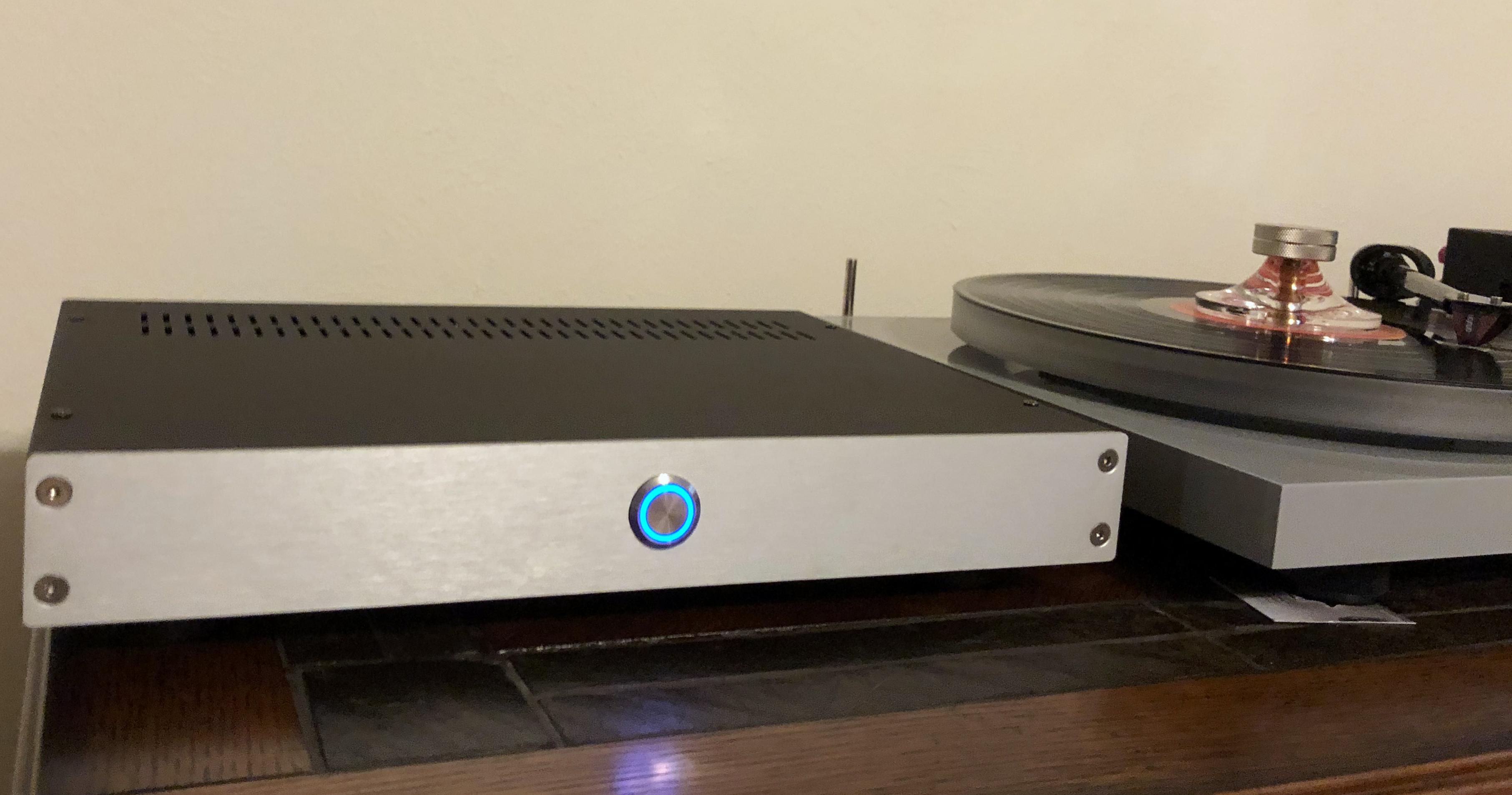

I'm going to say I'm a pretty happy camper with my finished Pearl 2. I tweaked the final grounding scheme and went with 47uF Silmic capacitors in series with R14. I also think it's mellowing a bit as I run it, losing some of the sharpness I thought I heard at first. It's interesting comparing it to my Rogue Sphinx phono stage, which has a good reputation. The Rogue is pleasant. The Pearl 2 digs deeper into the music and draws out more depth of tone. Thanks to 6L6, McQuaide and others for their help. I ended up moving the power supply to the opposite side of my console from the Pearl 2, which is about five feet.

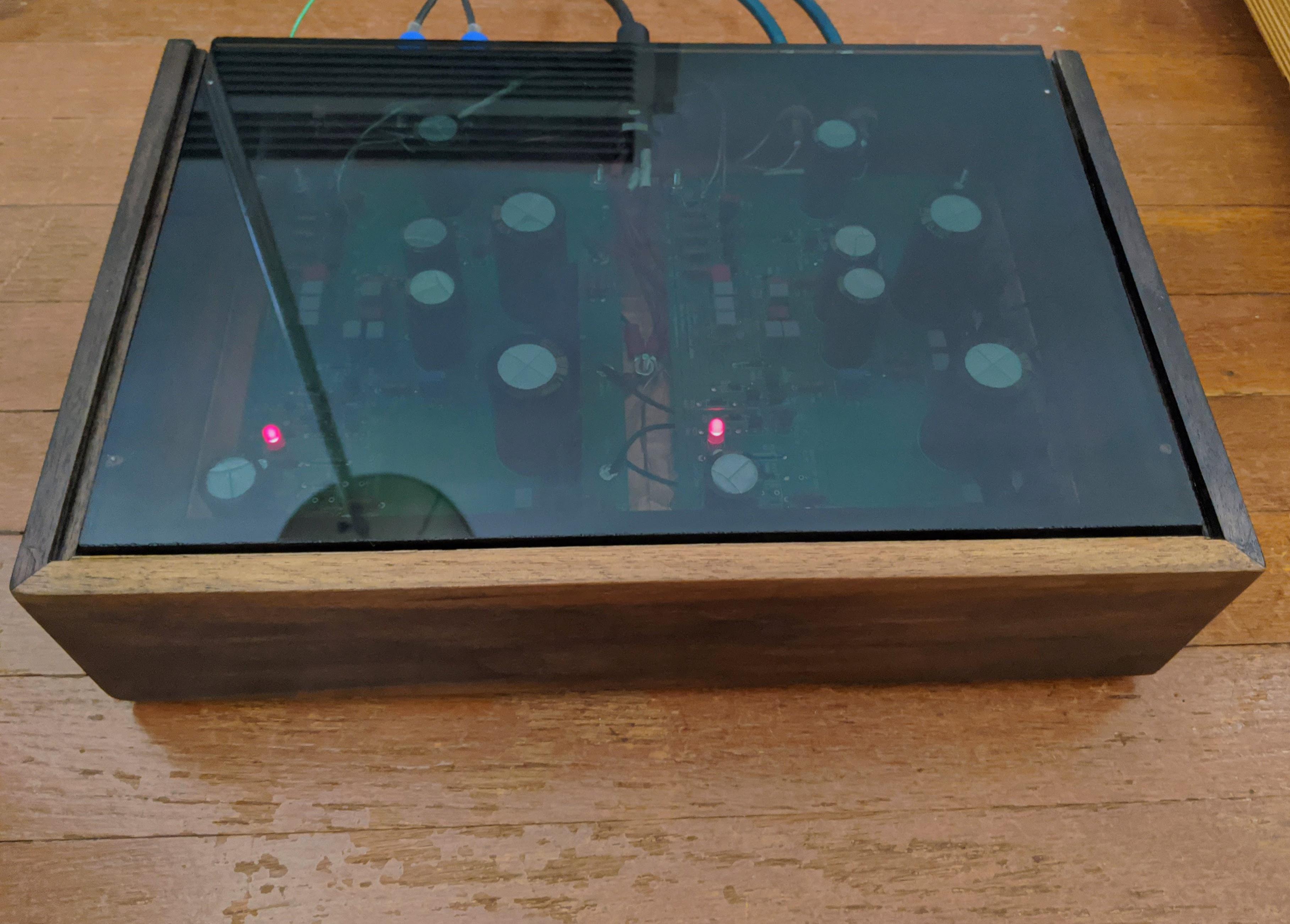

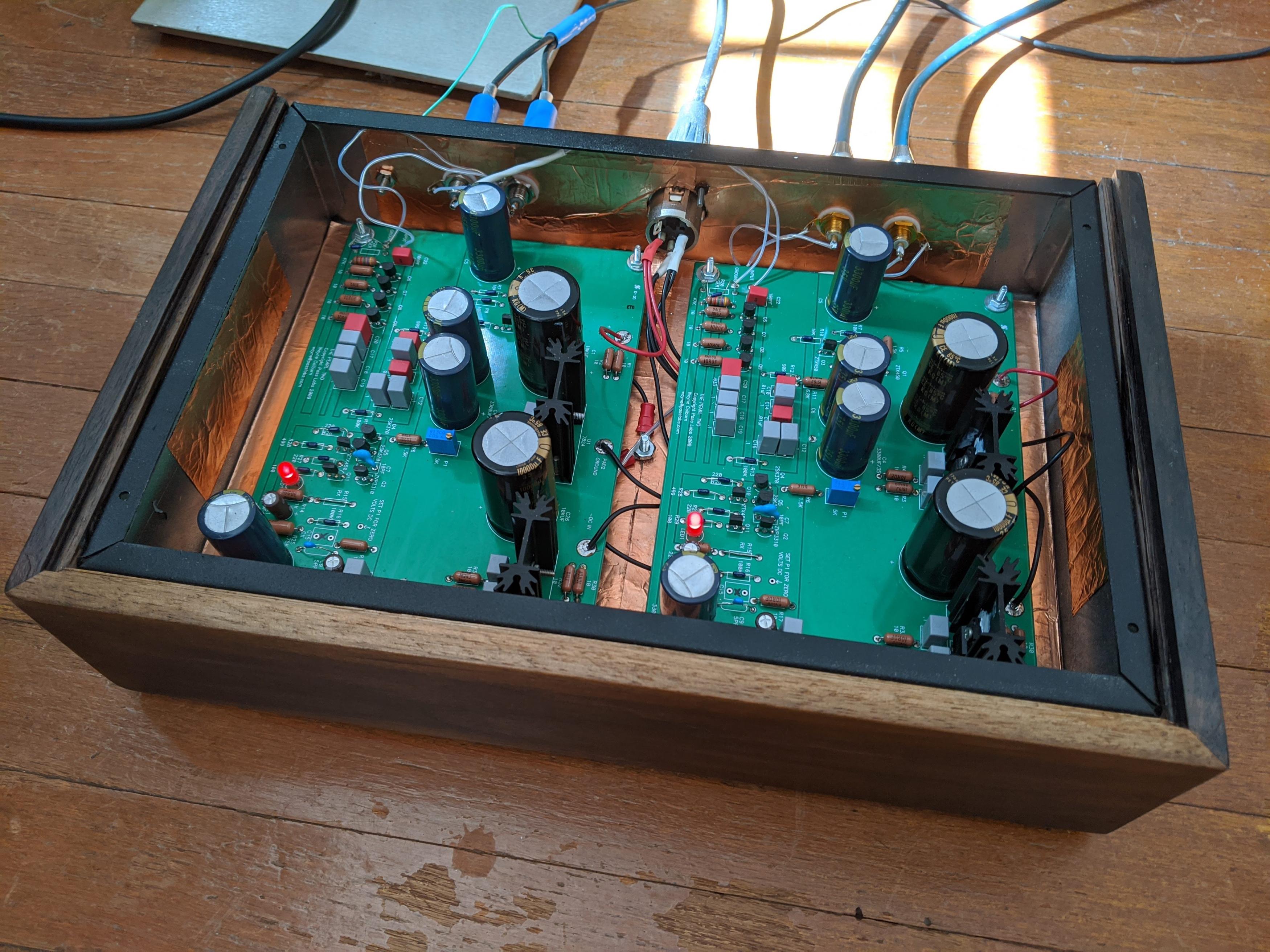

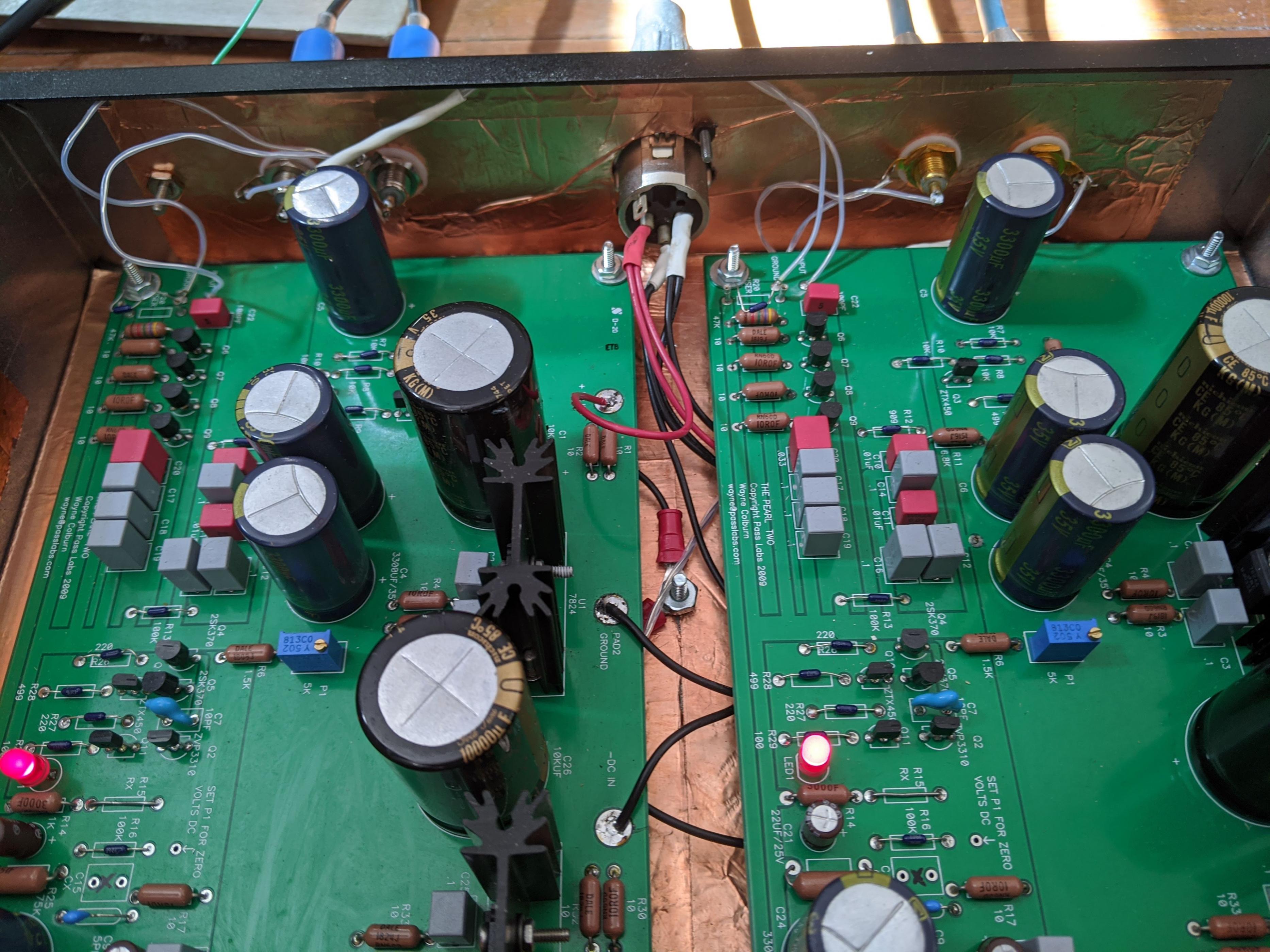

Okay, so I spent the last couple of days making a chassis (boy did that not turn out the way I thought it would, aka learning as I go). I cleaned up the wiring. Pictures attached. I hooked it up and I get a loud buzzing sound, that I did not get before. Any ideas? It worked fine before.
Is the TT grounding post hooked up to anything inside the chassis?
Well, I feel stupid. The right output channel was cross-wired. I fixed it and it plays but it doesn't sound very good. It's really noisy and flat with no dimensional imaging. I attached the ground post to the chassis ground lug as suggested, but I might disconnect and see if the noise floor drops. I appreciate the assistance and I'll keep posting my progress. Here's more or less what it will look like when finished.
