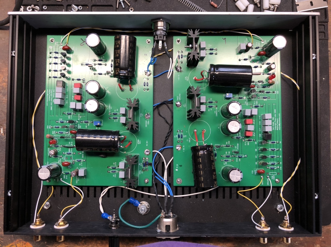

Start-up #1: right channel fuzzy. Left dead. Here’s a photo. I can hear hum at 12 o’clock on the right. The fuzzy happens at about 10 o’clock on a moderate volume. I hear nothing at all on the left. Checking input and out connections. BTW, the switch on the front panel is only connected to LED.View attachment 845001
I had similar problems that disappeared when I went around and touched up all the solder pads from the top as well as the bottom, paying close attention to the ground plane connection pads.
I used a heat sink clip on all semiconductor leads between the pad and the component body to prevent damage. I also had oscillation at 4MHz on the scope until I removed C7.

Test #2: Found a solder bridge that revived the dead left board. But its sound Is very muted. Right channel has very distorted sound -- a fuzzy static kind of layer to the music, worse on treble — and audible hum at 12 o’clock. I’m using a shielded mic cable and Neutrik 4-pin XLRs for my umbilical. My power supply is a Gainclone PS board with an Antek 22/22 50VA toroidal.
All my voltage measures are very close to recommended levels, so I’m disappointed. I gave each board a good going-over in search of bad joints.So far it’s built to the design.

Is your cable shield grounded?Test #2: Found a solder bridge that revived the dead left board. But its sound Is very muted. Right channel has very distorted sound -- a fuzzy static kind of layer to the music, worse on treble — and audible hum at 12 o’clock. I’m using a shielded mic cable and Neutrik 4-pin XLRs for my umbilical. My power supply is a Gainclone PS board with an Antek 22/22 50VA toroidal.

The Unraveled umbilical Cable shield is grounded to the XLR connector ground tab on the Pearl 2 chassis only (not the PS) and then to star ground on the steel bottom. I think it shows in my photo.

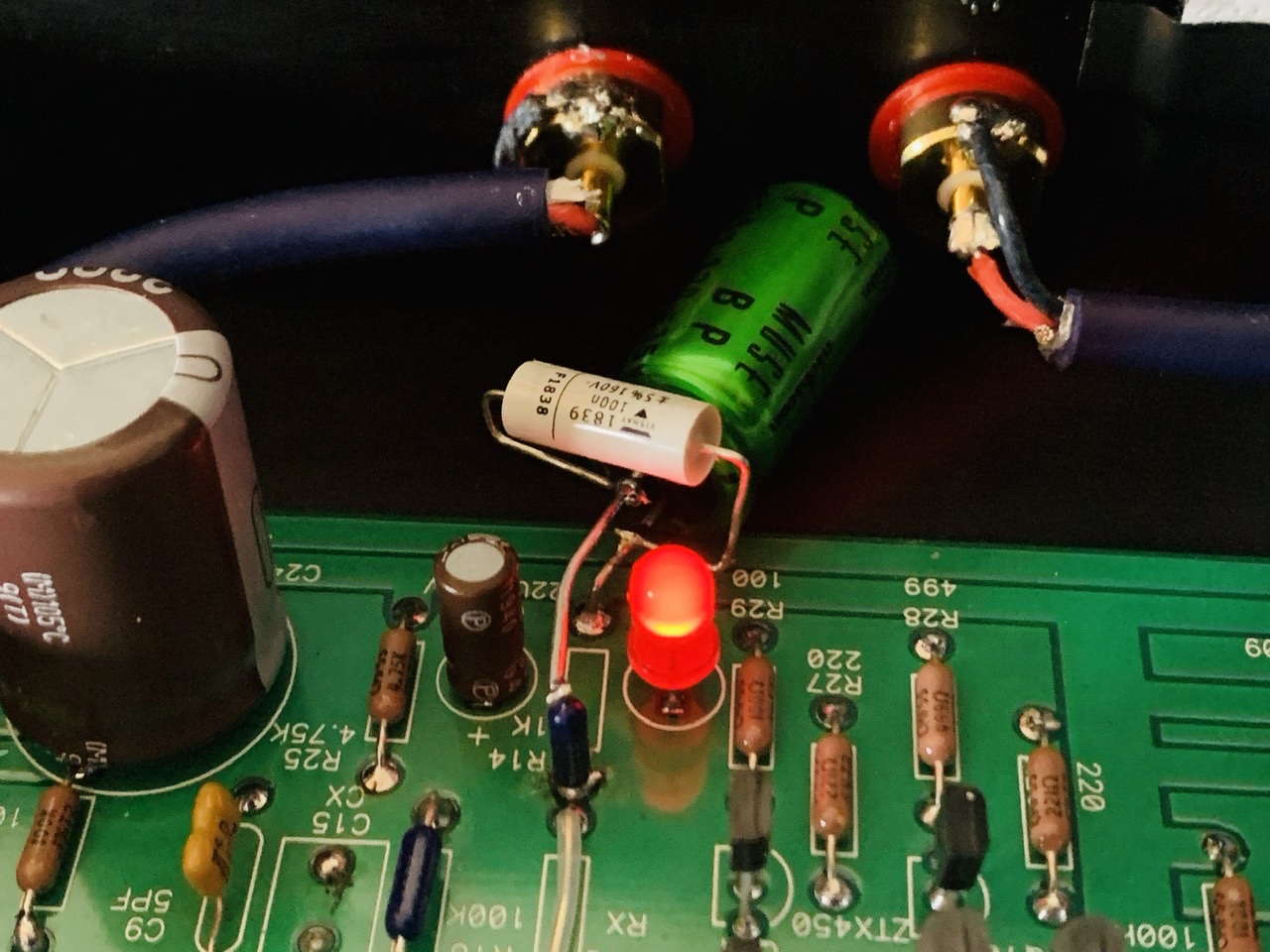

I decided to approach my problems with distortion by going back to the beginning. I got stable, low mV readings at the P1 test point earlier but can’t anymore. So I’m going to achieve that first. I initially thought stability was a matter of temperature; if I left it powered up an hour or so I got good readings. That’s not true now. I get a different readingS every time I test. Often Initial readings are in the range of several hundred mV on both boards and must be lowered using P1.but they still oscillate in the +-70mV range.
I’m inclined to try the capacitor fix, but I’ve seen at least two different posts on that. One calls for a 47uF/25V cap between R14 and ground. Another calls for a 400uF/25V cap in series with R14 and then bypassed with a Silmic or similar. to quote a post here. Can anybody suggest the best approach, and include physical contact points for these components.
Let me ask this: I wanted a low profile so used a 1U Galaxy chassis. It has a 40mm internal height. I used 3/16-inch standoffs from the steel bottom cover. I’m satisfied there is no contact below the PCB or with the top cover by any Bare wire or component
t
I used the first approach and it worked perfectly.
Thanks, Mark. I don’t have anything that size, just some extra 22uF/25V Silmics. But when I do get one, where do I attach the cap? Across the leads of R14? Looks on the circuit that it goes to ground. I haven’t done anything “off-label” before.
