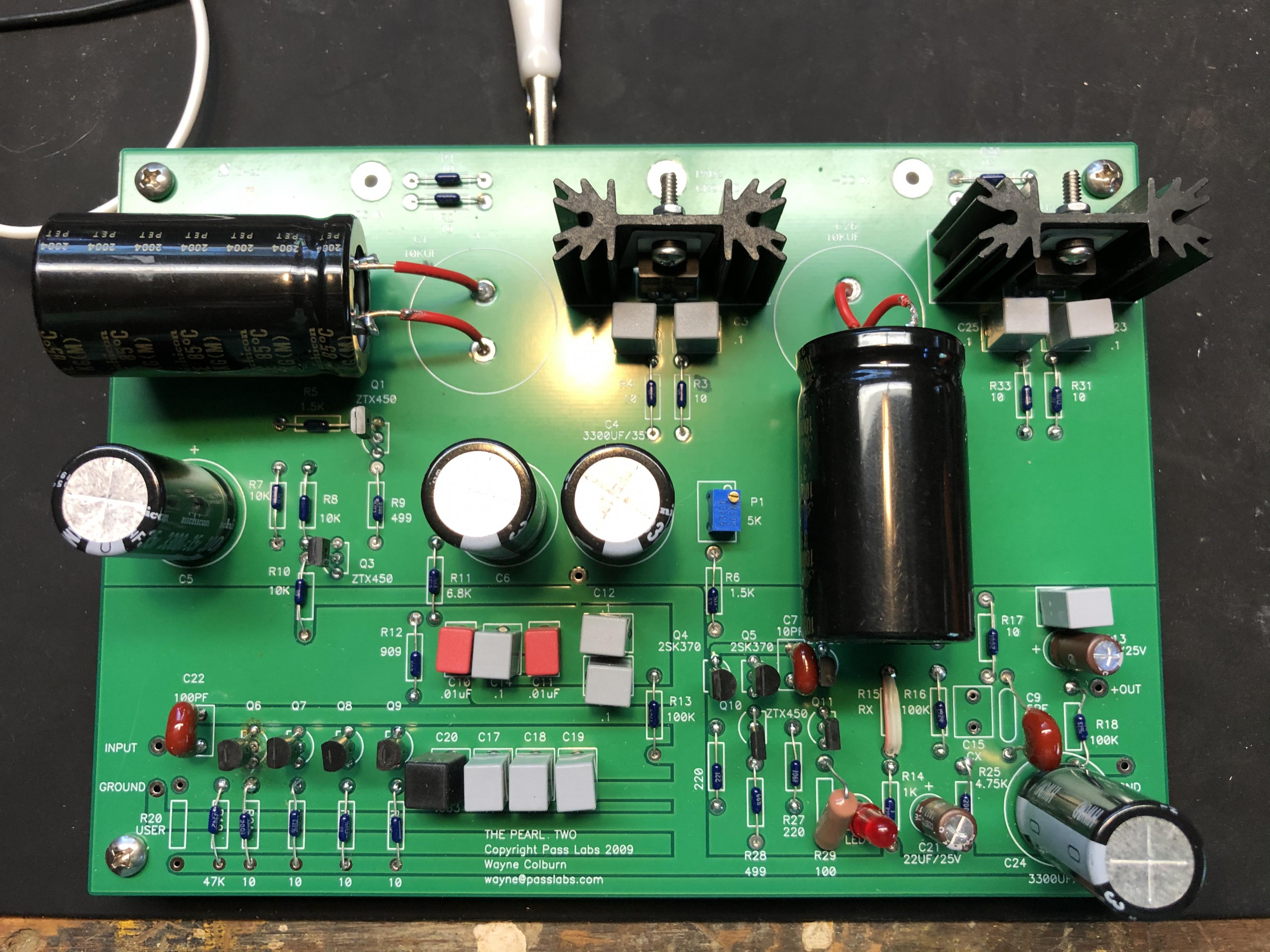

6L6 has been helping me with my boards but I thought I’d post my issue so others could chip in and maybe learn as well. I’ve completed both PCBs and get identical — and wrong — measurements. Here’s the situation.
I’m using the Chipamp PS to get 31.7V. When connected to the boards, the LED does not light and I get these measurements: At the P1 adjustment pad, I get -7.3V which does not change when turning P1’s adjustment screen. At R4, I get +2.3V instead of +24V, and at R33 I get -7.4V instead of -24V.
6L6 diagnosed a zapped ZVP3310 when I tested the first board, but also noted the dark LED was another issue. I replaced the 3310 and got the same measurements. I then completed the second board, being super careful with the 3310 (wrist strap, silicone rubber mat, spreading the leads only with a plastic tool) and again get the same measurements. Photos of both boards posted.
Before stuffing I checked all component values, except the transistors because I wasn’t sure how to test them anyway and was afraid of damaging them in the process.
So there we are. All input welcome, and thanks.

Your voltage regulators are not putting out the correct voltage so nothing downstream is going to be right - you need to fix that. Confirm + and - voltages from the power supply are correct and confirm correct orientation and correct parts for the regulators.
I can’t believe I did that. Swapped 7924 and 7824, both boards. But I have spares! Many thanks.

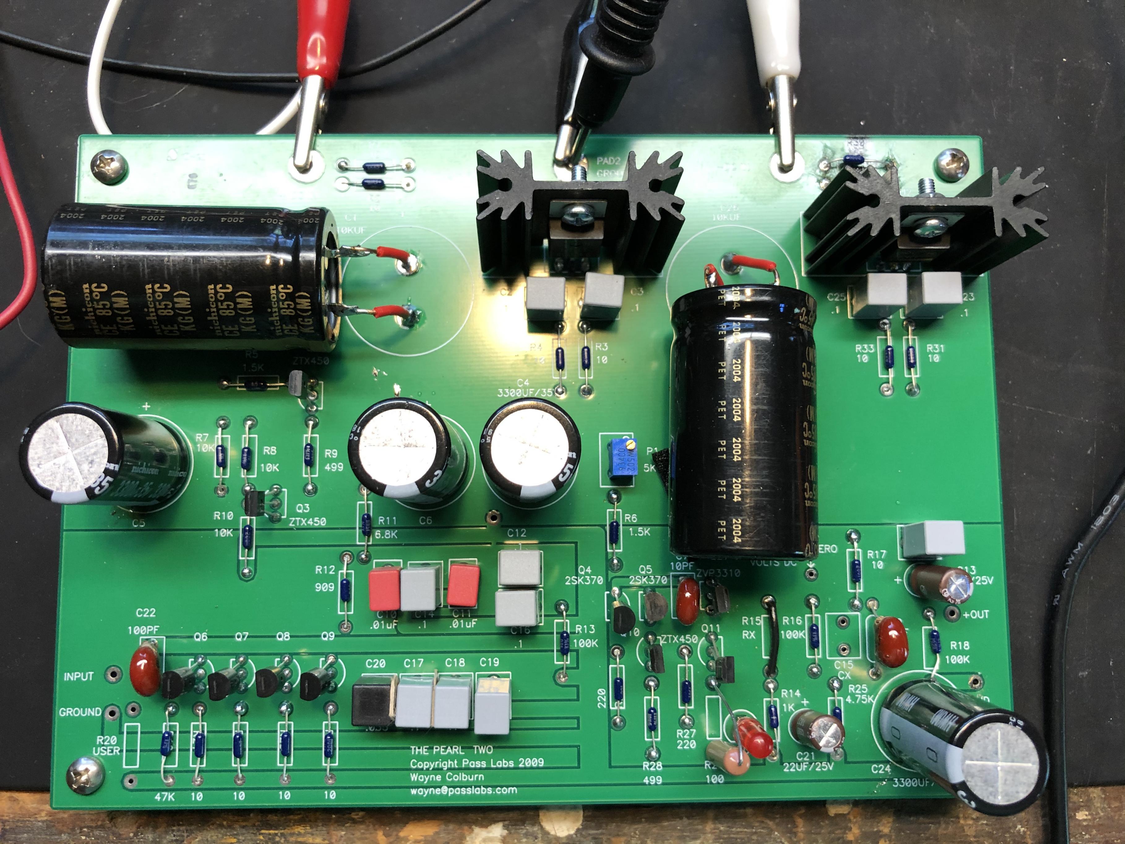

Ah, all is well. Out with the bassackwards regulators and in with the correct ones. Lights on, correct voltages. One PCB drifts between +-75mv and was easy to trim at P1, but the other drifts more And is more sensitive to adjustments. I’m letting it just run a while after getting the swings down to about +-200mv to see if it settles down.

I just built mine (without reading this thread first), and had similar swings and not such great sound, so I started reading the thread. I realized that I shouldn't have included C7, took it out, and the offset swings settled way down and the sound was much better.
I went back to my boards one last time. But before measuring offset, I looked at every solder joint under my magnifier light and reflowed any that looked at all iffy. If I didn’t see a nice solder bump on the top side, I did it again with a freshly tinned iron. And what do you know? Both boards are now +-1.5 mV and move slowly in that range.
I thought back to the Steve Guttenburg Audiophiliac interview with Wayne Colburn and Nelson Pass. They’ve worked together 30+ years, Wayne on small signal kit and Nelson on power amps. Makes me think The Wizard’s Assistant knows how to design and we just have to be up to the task of a clean build. Then try some variation.
