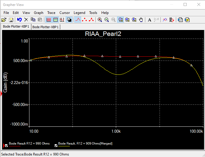

A friend built a Pearl 2 years ago, and I decided to build one myself because it sounds great with his table. However, I think my Ortofon cart with 5.5 mV output is a little hot for the standard configuration because it sounds VERY wrong hooked up to my table. I've seen a couple different solutions mentioned in this thread, but they're kind of spread out and I'm not sure what exactly is the right way to set up a Pearl 2 with such a high output MM cart. What value changes do you all recommend I implement to make a Pearl 2 compatible with my cart? I will be using a B1 preamp after the Pearl 2.

tayj10 - Can you give any more information? I've used Ortofon OM series and 2M series with zero issues.
Yeah, it just sounds like there's a huge dip in the middle of the response when hooked up to my P6 + Ortofon Blue. Since it sounded so off, we didn't leave it hooked up for long. Bass was there, and ultra-highs were there (maybe a little too there), but something in the middle sounded super recessed. We thought there was just something wrong with his Pearl 2 altogether, but when we went back to his Sota + Grado cart, it sounded great again. His Grado cart has a 3.5 mV output, so I am just kind of assuming the issue is due to the high output of my cart, but I could be wrong. At the moment, the only other phono stage I have on hand is through my surround receiver, and my table sounds fine through that.
tayj10 #2031
Hello tayj10,
the Ortofon 2M Blue (moving magnet) wants to see 150pF to 300pF capacitance at the input.(C22 ? on the Pearl2 board) and 47kohm (normal value in Pearl2)
Your phonocables capacitance + capacitance at the input of the Pearl2 should be in that range. Tried that?
Outputvoltage of the 2m Blue is 5.5mV. Could be high.But should work.
A lot of bass and highs and reduced mids sounds to me like wrong input capacitance. But I can be wrong....🙄

In the worst case, I can make a direct recording from the B1 output and post that to see if that helps make a diagnosis.
R12 -- the combination of R12 and C17 set the time constant "T4", 3.180e-4 seconds. 909 ohms * 333nF = 3.027e-4 seconds. Le voila:
