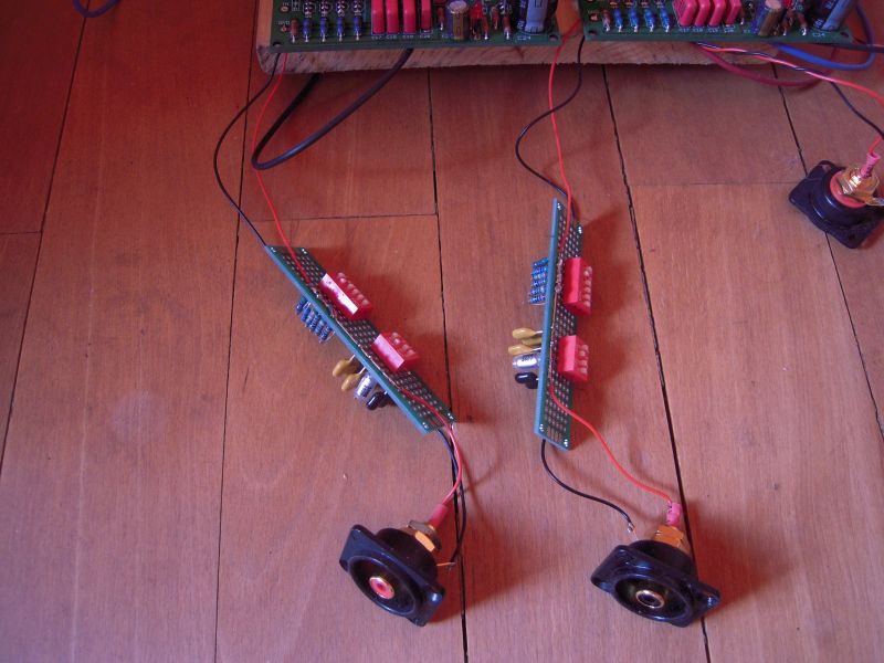

Hello aljordan,
in my phono-pres I made little resistor- / capacitance- switchers at the inputs.
Easy to do on protoboard with DIP-switches (some don't like DIP-switches -
but it is also in the XONO!).
Makes adjustinging the load / capacitance to the cartridge easy....
Never switch during operation or listening to music!!!!
Greets
Dirk

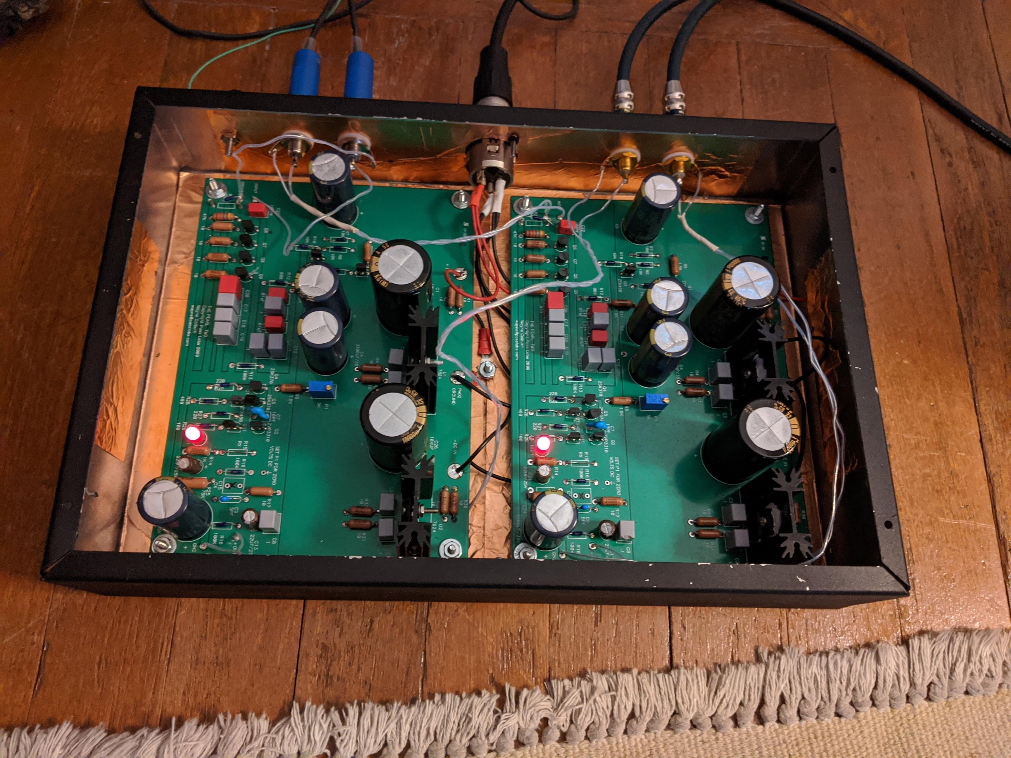

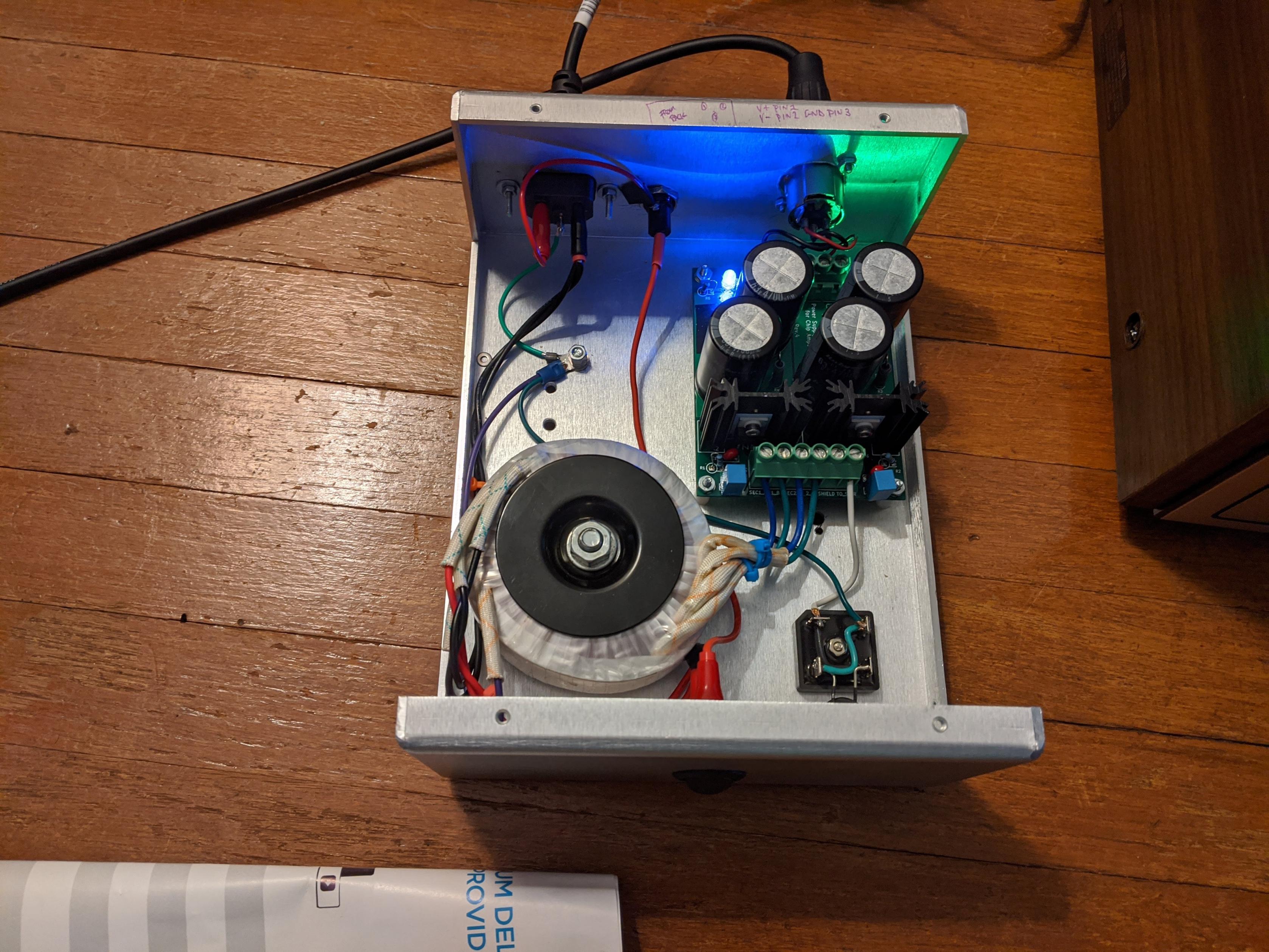

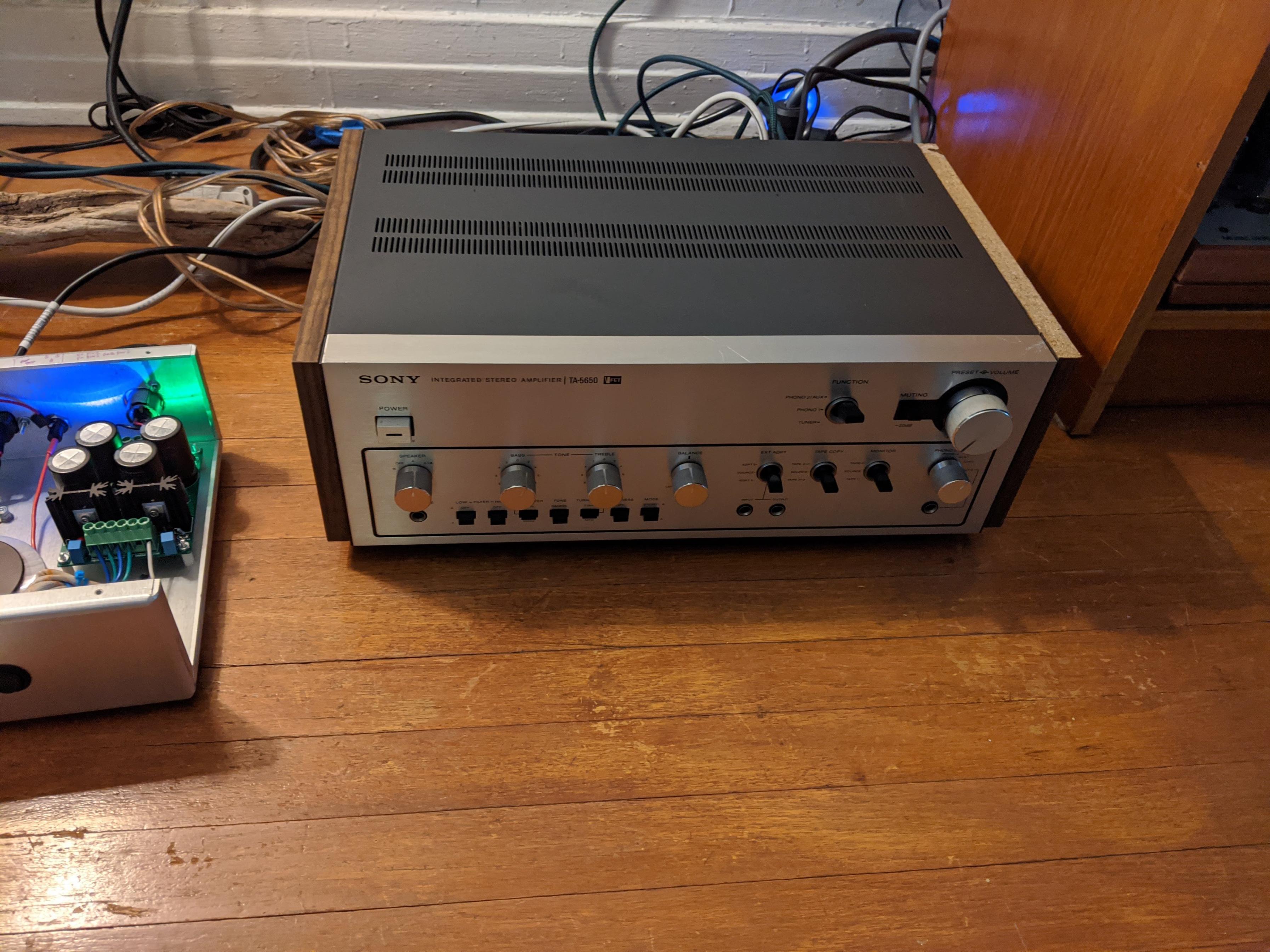

Hi all,
I hope everyone is doing ok with quarantine. I finally had time to work on my Pearl 2. After several failed attempts at making a case, I got one that works for me. I hooked everything up for a rough first run. With the dc voltage, I set it to zero with the trim pots as instructed on the boards. I hooked everything up to my Sony TA-5650, but upon turn-on of the Sony I get a pop. When I select the line that has the pearl connected it seems quiet with no cart installed, only a faint hiss when I turn it way up, but when I select another input I get a crazy oscillating type of noise? Not sure if I am describing it correctly. When I did turn the Pearl for a test when I brought it into the house, it did blow a fuse the first time so that was a sign of something not right. Any ideas?
Thanks goes out to 6L6 for going way beyond the norm to help me with the power supply!!! Thanks so much.
I've attached some pictures
