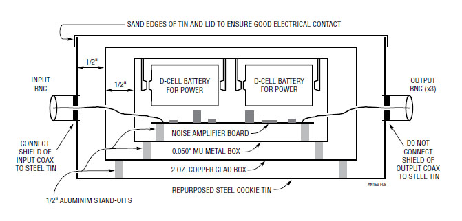

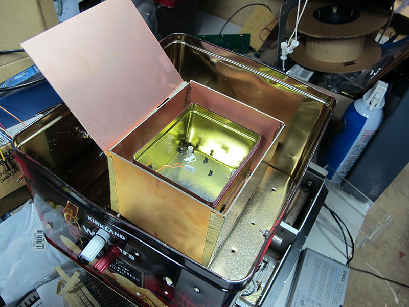

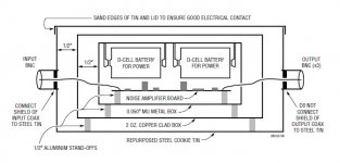

This is the shielded box I used to measure noise, and an illustration of the shielding technique suggested by Linear Tech (now Analog Devices) in an application note (I don't have a muShield box, so used a smaller cookie tin) -- I can measure as low as 420 pV/Rt Hz which is 60dB lower than the average MC cartridge, using Sam Groner's 60dB LNA
I found the application note, and the Sam Groner LNA thread. Thanks for heads up. I should be able to make such a box.

As it pertains to the topic at hand, I am bothered that the original design is so hyper-sensitive to hum and the 120 and 360 Hz artifacts. It's a really nice design and easy to implement and it IS NOT noisy!!! The boxes I show above reduce 60Hz and 120Hz (50 and 100) hugely, and that was the point of my illustration.

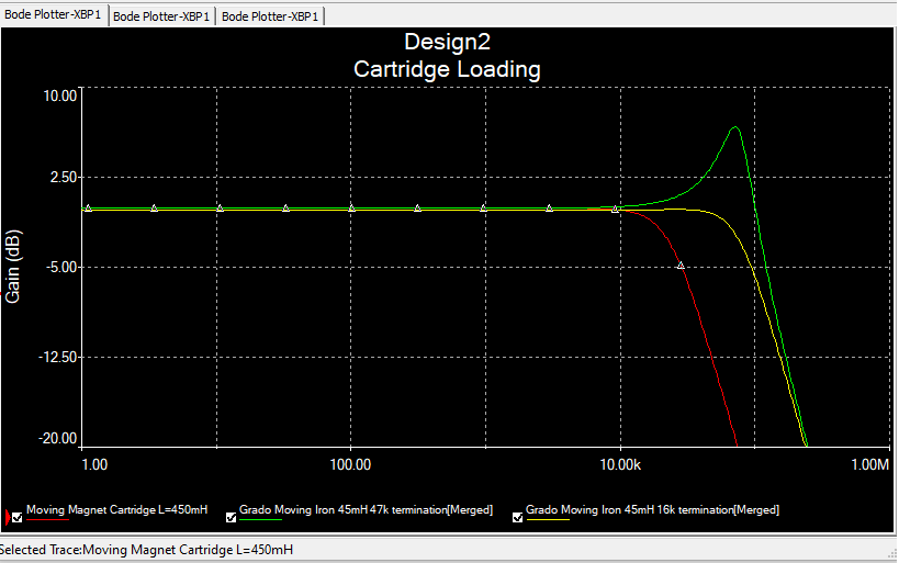

If I am not mistaken, Grado XC+ is a moving iron cartridge with 5mV output. Two things have to change. The cartridge loading resistor (R19) at 47k will under-damp the response. This results from the low inductance of 45mH (moving magnet carts are 10x this value). Thus the loading resistor may be less than half the 47k.I am using a Grado XC+ MM cartridge.
Second, with 5mV output chances are that you are overdriving the output stage.
Third, I believe that the upper limit for the input voltage LM7824/7924 is +/-38V. TI no longer has a data sheet on their website, and the product is not in the "National Semiconductor Power IC's Databook"
I updated so that R19/R20 in parallel are 16K. I also changed R16 to be 50Kohms. The sound issues are mostly resolved. There is still a bit of noise/harshness in the high frequencies. I'll keep playing with R16 and R19 to try to resolve. Any other suggestions? I appreciate the help! Thank you.

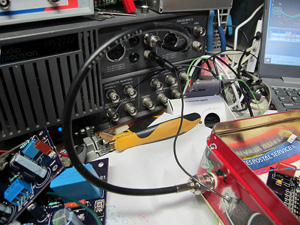

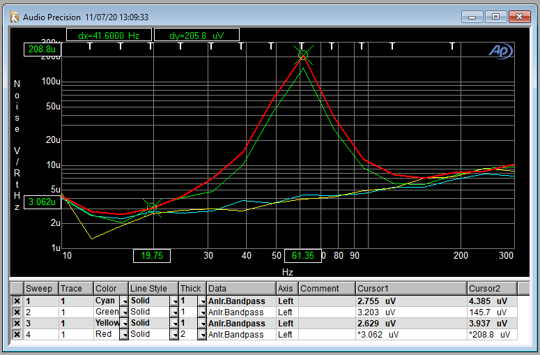

To demo the importance of proper shielding and grounding I ran this test. My LNA is Sams 8x BF862 from Linear Audio, gain of 60dB and noise ~425-460nV/Rt Hz. As sanity test I shunt the input with a 60 ohm resistor, which should be a bit greater than its thermal noise owing to the amplifier.
The "ugly" data were taken with the amplifier shielded, but the shield disconnected from the AP analyzer. The "nice" data the cookie tin used for shielding is connected to the analyzer. Its 33 to 50x better.
By the way, Wayne's boards WILL fit in the rectangular Oreo Christmas Cookie Tin.
