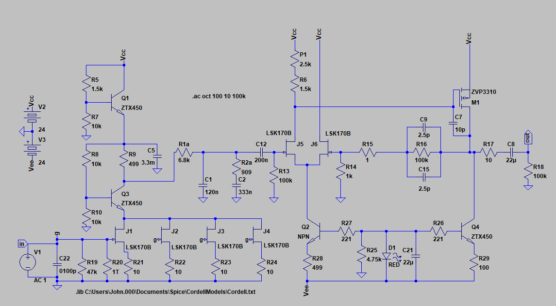

The Pearl pre-amp sounds great now with my Lx-mini active crossover. The bass frequencies are being boosted by the Pearl 2. I have tried adjusting the input resistors without luck. Any ideas on where to look if the bass frequencies are being boosted/high frequencies are being attenuated? Would the 5pF cap at C9 be a suspect? Does anyone have a full simulation file for the Pearl 2 that I could play with?

I do have a simulation file I could provide, in Micro-Cap. Send me a PM if interested.
For some measurements you could look at post 1341 in this thread. With stock RIAA values the bass is boosted a bit, but only a few tenths of a dB, so probably barely audible.

Attached
In the above, change Q2 from NPN to ZTX450. I modified the *.asc to include a behavioral voltage B1 with the RIAA time constants. This will save time for the analysis.
The ZVP3310 model is lashed up from ZVP3306 in Multisim which is quite similar, but there is no VDMOS model of either, so ymmv.

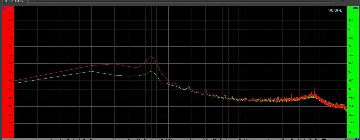

I picked up a FocusRite 2i4 Gen 2 just a short while ago and connected it to the output of my Pearl 2 build. Before I go digging too far into things, is this a somewhat "normal" noise profile from the Pearl 2? This seems a bit high to me, especially in the 10Hz - 100Hz range (right channel is red, left channel is green). Seems like there is some difference between the two boards that I'm trying to track down. This graph is from the "max hold" setting of the software.
Both traces are from an outboard DC PSU connected by a 5-ft umbilical cord. I wanted to compare inboard vs outboard PSU configurations and noise performance.

The umbilical is picking up the 60Hz mains "field" -- you could try shortening the power connection, and make sure that the chassis of the Pearl is connected to "earth" ground.

By the way there is some good grounding and shielding advice in this thread: Shielding thoughts and looking for experience

Thanks for insight and thread link! I was able to reduce the 60Hz-induced noise (was clearly seeing odd harmonics of AC hum: 60Hz primary, 180Hz, and 300Hz) by simply re-arranging the AC wires with respect to the DC umbilical. This lowered the noise floor to about -105dB across the spectrum. Still seeing about 5-10dB more noise in one channel than the other. I need to double check my wiring and solder joints between the boards.
