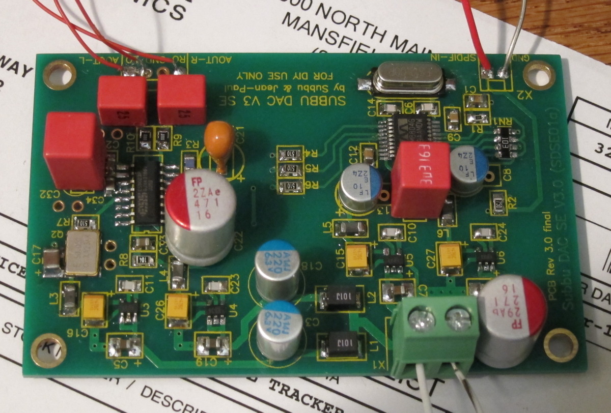

We dont know for certain if its either C31 or C34 OR both C34 and C31...based on my findings I had to remove C31 to remove distortion and the crlrect voltages then showed up on pins 9,10,11 of 9023. Both Atupi and Gary had one or the other but not both populated.
We know for sure its either C35 or C32 but not both.
I cannot see from angle of your photo but you need to check orientation of C7.
i'd say stick with C34 and keep components to the top side. Because of it's proximity it is very important.
C32 and C35 are essentially the same cap, just different footprints. It may have been better to have C32 also marked as C35?
That's the definition/clarity we needed. Same idea just stated more ditectly as it came up early in the thread. Seems perfectly clear now by looking at the board. 😀 :scratch1:

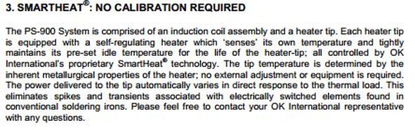

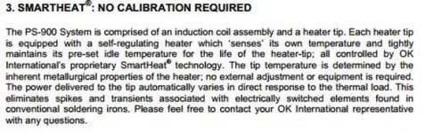

Passive, can you tell us what size and type of solder - and the tip size you used?
solder is good 'ol 60/40 from banzai music - very good solder indeed, flows beautifully but My main weapon is Insat Super Flux, brilliant flux for smd. Look it up 😉
My iron is metcal/oki PS-800 and the tip is a 2mm chisel tip.

Just to put to bed the discussion on what caps to mount on the NEG pins - C32/C35 and C31 or C34 or both, I finished a 2nd V3 board and mounted 1uf ceramic caps for both C31 and C34 and used the same 4.7uf MKS cap for C35 that I used in the first build. This board works fine and sounds good as does the first board. I'd say that each person can experiment here and there is no set rule. I've attached a picture of this latest build.
---Gary
p.s. I also use a Metcal soldering iron, which is a great tool. One can buy used ones for decent prices on ebay. Having a good soldering iron makes this project much easier. The only thing more important is having really good magnifying glasses so that one can see the small parts.

I would say C34 is mandatory and C31 is optional extra bypass for a film or elko in C35 position. If I do experiment it will be with the neg pin decoupling either with film/ceramic like you or maybe an oscon.
C34 is mandatory as it is closest to the pin, then it's either a low ESR electrolytic cap for C32 or a SAL-RPM aluminium pearl cap for C35 (I thought that would be clear as it seems ultra obvious one can't solder both as one hole is shared). If you wish you can use the pads for C31 (at the underside of the PCB) for soldering an extra SMD cap. C31 can always be soldered but keep in mind when a tantalum cap is used where the + must be connected ! Yes to GND ! The negative pin of the ES9023 is sensitive and I thought it would be nice to have pads for experimenting with caps but I see it gives confusion to give choices (isn't it always like that?) 😉
Often I use 4.7 Panasonic FC for C32 and an SMD 4.7 µF tantalum for C31 at the underside of the board (or PPS 1 µF in SMD or 1 µF ceramic MLCC X7R). Too many choices really but I thought you all liked choices....
IMO make total capacitance at the negative pin of ES9023 not higher than 22 µF and I even recommend to stay around 10 µF. Datasheet value of 1 µF really is not enough (visible on oscilloscope). More than 10 µF does not make things significantly better which might have to do with the high switching frequency of the charge pump inside the ES9023. I think many will agree on keeping the total value around 10 µF. OK, now the waiting is for one of you that says 100 µF sounds better 😀
IMO make total capacitance at the negative pin of ES9023 not higher than 22 µF and I even recommend to stay around 10 µF. Datasheet value of 1 µF really is not enough (visible on oscilloscope) but more than 10 µF does not make things significantly better. OK, now the waiting is for one of you that says 100 µF sounds better 😀
I compared my 2 V3 DACs - both with C35 4.7uf MKS and 1uf ceramic C31. One skipped C34 and the other had another 1uf ceramic for C34. The version with 1uf for C34 sounded very, very slightly better so I added this to the other DAC. So I'm done tweaking the NEG supply - this sounds good to me.
---Gary
