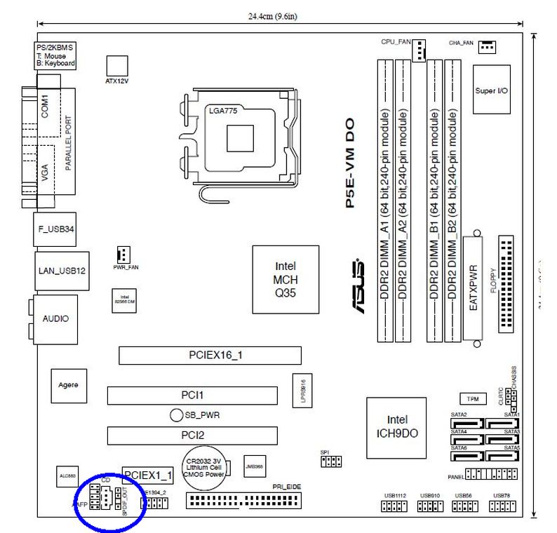

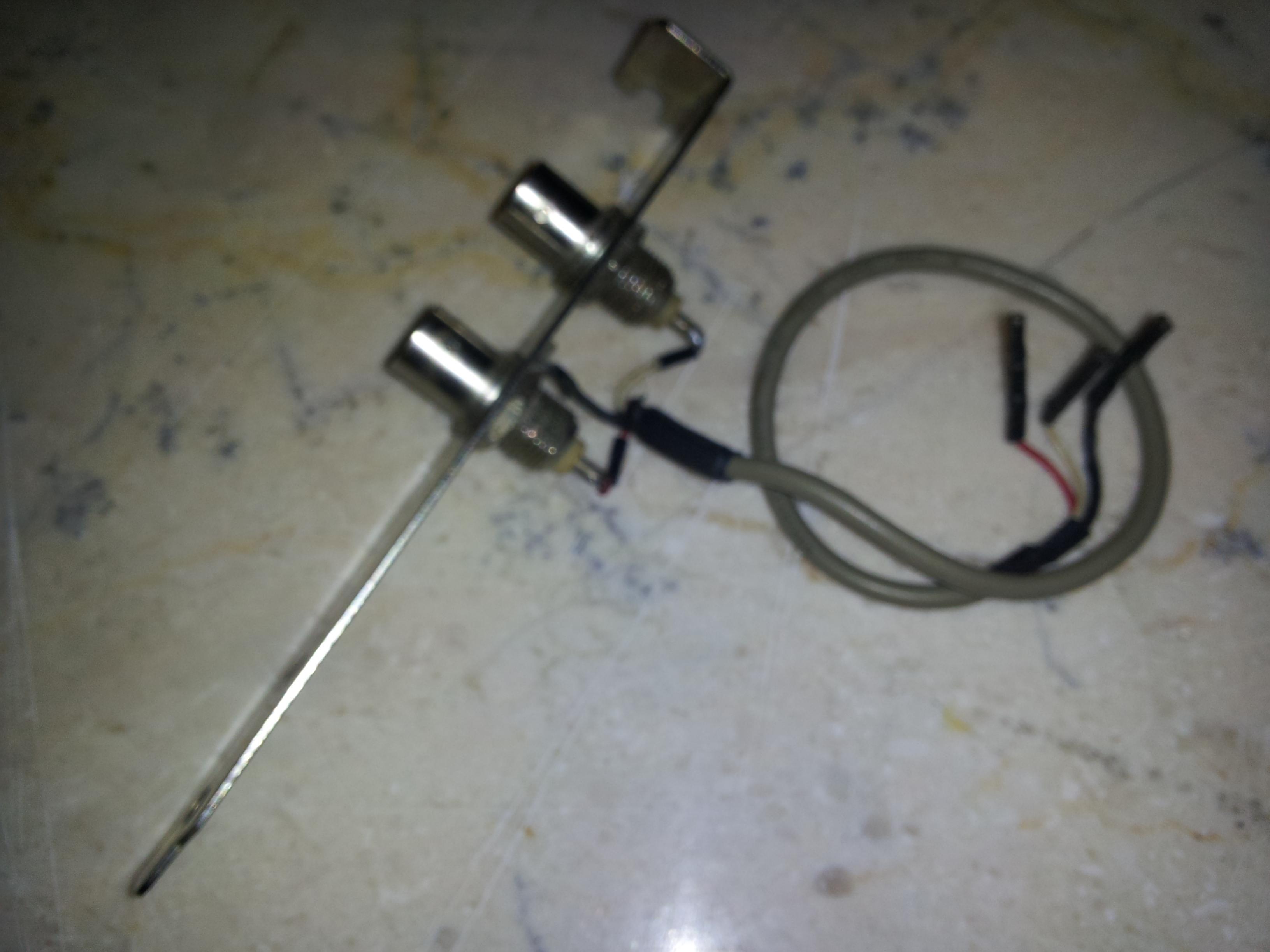

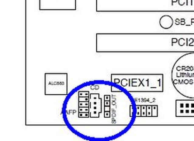

A nice little trick if you use a PC and the motherboard has the pins - make a one or two port BNC adapter from a back-plane slot cover. This one allows both in and out for S/PDIF, but most have at least the out. Just signal and ground and you have a clean feed without going through extra hardware/software on the motherboard.
OMG ! We are all gonna die ! Bob, there are input and output wires in the same cable together. If you do it like that make sure both "hot" wires at least have their own shielding.
Motherboard ? When using a pc for audio then Toslink would have the advantage of galvanic separation...probably USB is the better choice for computer audio despite its even more complex demands. Never would have thought anyone would use an SPDIF Subbu V3 on a computer !
