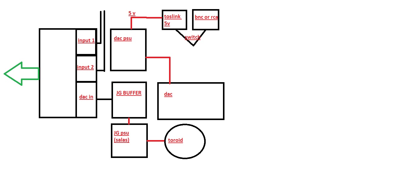

I will try to plug dac some day later, as my system in disarray. I have to think about combining few components under one hood so please bare with me 🙂 am will do my best to test sound asap. I would ask for advise on a subject of component placement. Please see pic below.
Leftmost box is a LDR based passive attenuator with remote control and switch option. As well I can add "soft"start board associated with this pre- in this case it will control power on and stand by for all boards here

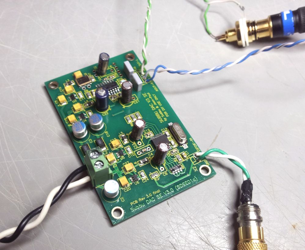

SUCCESS AT LAST !!
Replaced Q2, C17 and R7. Populated C34 and C32 - C31 not installed. The base build is alive with published BOM parts, so I'm happy. Let the tweaking begin. 😎
I suspect I fried Q2 first time around and also had C31 in place. I'll add some definitions dealing with that area to the first post.
So JP, I take back 1/2 the nasty things I muttered to you under my breath in the past few weeks.😀 I'm keeping the rest in reserve - just in case.😉

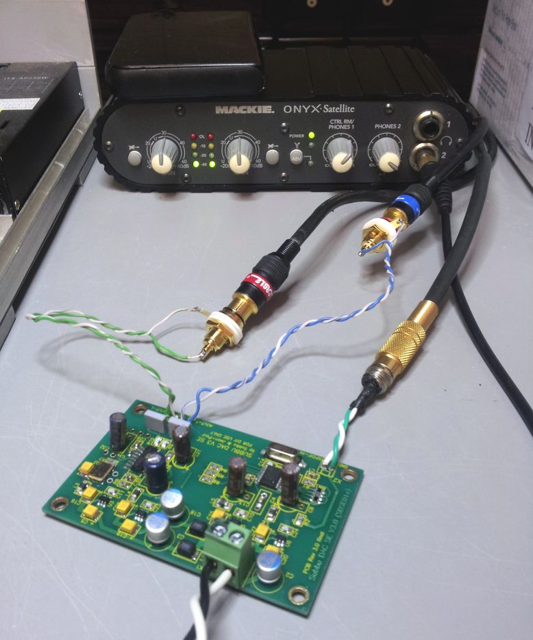

I'm claiming "Stunning".
Second piece is Bizet "Symphony in C" through a top line Mackie Satellite Pre and DT-770 phones. The clarity is amazing and the stage nearly perfect. Can't wait to hook up speakers tomorrow.

Hi all, hope you are having a great xmas.
Got my DAC up & running today, thanks Phil for the parts in time for xmas.
I've only had it running for 10 mins so no comment on the sound at this point,
I'm just pleased it works. I'm using it with a win 7 pc & Jriver mc, the sound was very distorted until i turned the volume down to 50% on Jriver, i'm not sure why. I'm using Wasapi & couldn't get it to work on Asio.
One thing i nearly got caught out on was the SAL-RPM caps, At first i took them to be tantalum bead caps & assumed the stripe was +ve but then realized they are electrolytics.
Q2 was a bitch to solder, i was worried that i'd overheated it but it seems to have survived.
Thanks to J-P, Subbu & Phil for a great project, Ive had the proper kid with a new toy at xmas feeling & the boards are a work of art.
