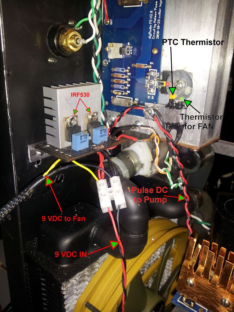

Sunbean 4 port controller. Low RPM = Red, High = Blue.(fully variable) Only need two ports, one for combined fans and one for the pump. I'm working on a small internal module that replaces that entire unit. Also an AC auto shut off for runaway temps.(LC F5 build in photo)

Hi. I do not follow the connection with the DAC. I doubt it is the amp design (or fact they are Pass designs) in combination with the DAC is causing the hum. I see the picture - not sure I understand. You have a water cooled F-5? You also have a BA-3 - is it not completed and you are looking for advice on how to ground? Seems complicated, too many variables to sort.
O.K. The F5, BA-3 and MyRef power amps are all completed - other than the chassis externals and final show wiring. They all play wonderfully and have for months with either a battery powered - or optical source feeding the Mini2496 DAC.
A hum that seems to be a ground loop appears on all three when a copper SPDIF connection is established. The Subbu DAC V3 works just fine when attached to a Mackie unit and/or BrianGT monoblocks - totally hum free. So it appears there is something "different" in the BrianGT (and the Mackie Preamp) grounding paths that breaks or displaces that suspected ground loop.
With the Mackie Pre I'm using ballanced 1/4" TRS to RCA adapters for signal to the V3 - no hum. The BGT combo is RCA on both ends.
I have tried both BNC and RCA cables between the computer and the V3 - no difference.
The Pass amps employ a common ground between the power supply and the speaker feed. Ground is ground is ground.🙄 The Fremen Edition MyRefs have a floating ground that can be configured according to user option and chassis configuration. In either case they don't like to play well with the solid SPDIF ground. I even put the Mackie Pre between the V3 and the BA-3 and still got the hum.
