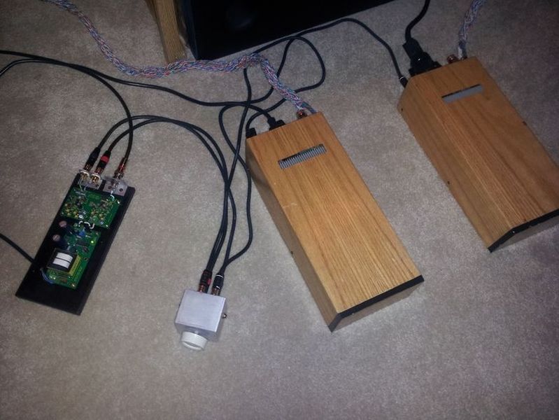

A hum that seems to be a ground loop appears on all three when a copper SPDIF connection is established.
Correct, it is a grounding issue via the SPDIF connector which is very simple but you have to search..
The Pass amps employ a common ground between the power supply and the speaker feed. Ground is ground is ground.🙄

Absolutely the wrong approach, sorry. You know what the outcome of that will be. Using bandaids every day to stop wounds bleeding because you use to take the knife at he wrong side is not the real solution. I already gave some hints on the grounding issue but you did not reply. Please reread post #437. Toslink is not the real solution, it will also make the V3 less good. That is opposite our common audio set of rules AFAIK. At least it is against the design goals of V3 but we live in a free (edit by Edward Snowdon: well that's what you like to think) world so...
BTW "Ground is ground is ground" is not true in the real world. That direction is where you have to be looking. Start checking the power plugs as asked in post #437.

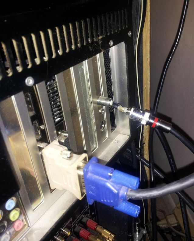

JP, there is no galvanic ground connection between the V3 BNC connector and it's bracket as described in that post. It's just on a wood base - no metal chassis yet. Are you talking about the other end, the PC?
I have no intention to use the TORX on a permanent basis. Just looking for a way to hear the V3 on other power amps.
The Pass ground comment came from a reliable source that helped clarify the differences between the LM3886 amps I had been building and the discrete approach. Not intended to be taken exactly verbatim. I'm more than happy to take this discussion off-line, but was concerned about what might happen with other builders with various amps.
Sorry if I've taken the thread in the wrong direction.
Bob, I suggest to draw a diagram of all connected components, including the main and the safety earth. Then follow how the signal ground "flows". Notice that your Dac now connects the signal grounds of the source (PC?) to the "line out" preamp or amps. The dac is floating, but the other components can form a second loop outside the dac.

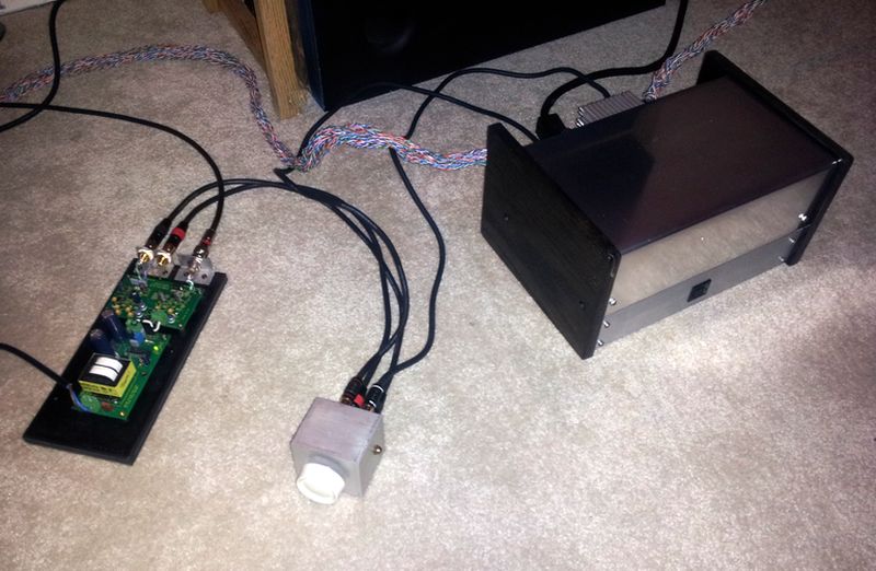

Thanks Fred, I'll do the diagram tomorrow. I'm as tired of writing about this as everyone is reading it, but I did do a final cycle for confirmation:
1. Isolated the PC end of the BNC from the chassis - no help.
2. Noticed motherboard SPDIF RCA ground was touching PC case.
3. Ran RCA SPDIF from OPPO DVD player to V3 DAC - no help.
4. Moved a completely different PC to a location right next to the DAC/AMP. RCA SPDIF feed - no help.
6. Reset music server > V3 > BrianGT amps system - perfect sound - no hum.
7. Hooked up a different MyRef FE build - perfect sound - no hum.
So there has been some "great" progress. I'll do the diagram for the Pass and FE beta amps after I catch my breath and put the server back together. :dunno::boggled:

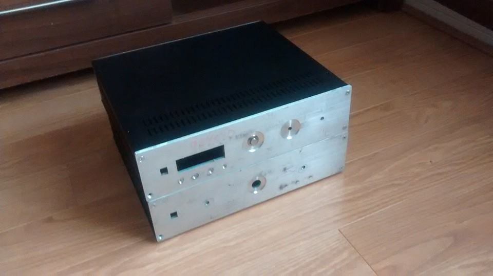

getting there
Received front back plates for both enclosures so after polishing I ll do final assemblies.
Question on how to combine dac+pre+filter grounds remains open.
Or should I leave them floating and only do the earth connected to enclosure floor ?
