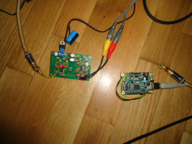

I've only had it running for 10 mins so no comment on the sound at this point,
I'm just pleased it works. I'm using it with a win 7 pc & Jriver mc, the sound was very distorted until i turned the volume down to 50% on Jriver, i'm not sure why. I'm using Wasapi & couldn't get it to work on Asio.

Did a little temp base to use during tests and tweaking. I'll let it run for a few more hours and then put it in the big system.

I just tried asio4all & it's just the same as wasapi.
No distortion with sound format test in control panel-sounds,
Ok with wmp so it's a jriver problem, I'll check the Jriver forums.
I'll just leave the volume set to 50% for now,
I'm using Jriver internal volume & it's 64 bit so shouldn't deterioate the sound and the windows volume slider is bypassed.
"I'm using it with a win 7 pc & Jriver mc, the sound was very distorted until i turned the volume down to 50% on Jriver, i'm not sure why. I'm using Wasapi & couldn't get it to work on Asio."
Actually, I lied.🙁 What I did was switch to ASIO while playing music. The settings saved but didn't effect the output till I stopped and started the song again. I also checked the JRiver site and learned ASIO is considered somewhat outdated for use with Windows latest versions. WASAPI also disconnects the "W" garbage so I'm satisfied. The only thing I can't find in the new JR is the old kernel streaming mode which reportedly enhanced the signal a bit more.

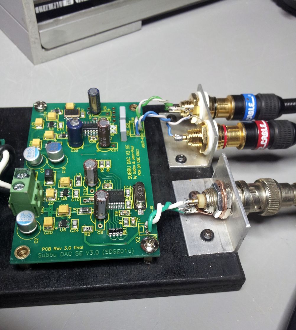

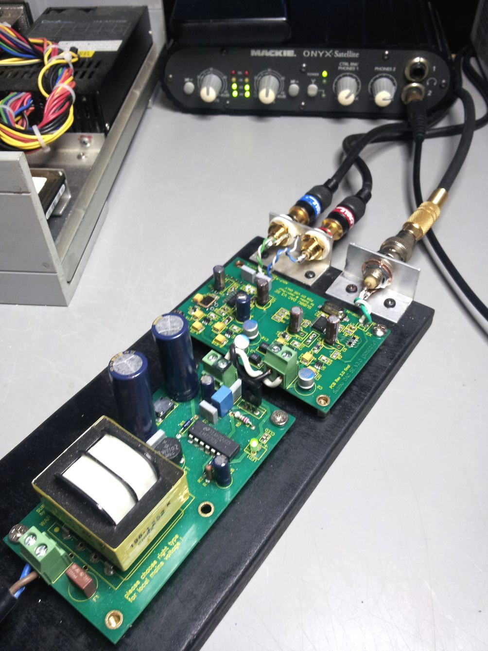

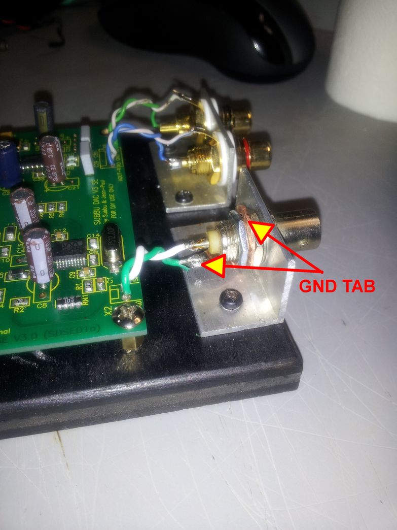

Is anyone having problems with hum using this DAC. It works perfectly with the Mackie pre and a pair of BrianGT LM3886 monoblock power amps. But when connected directly to a MyRef dual mono or a Pass BA-3 the hum appears. The V3 is on a wooden base for now but several attempts to jumper grounds at various places had little or no effect. The DAC DC readings are L = 1.1mV / R = 2.1mV. Idle AC reads 0.002V both channels.
The DAC is hum free when grounding is done right. Input SPDIF connectors GND should not be connected to the metal case. All standard rules for grounding an audio device also count for this device. When left "floating" in a metal case it does not even hum. DC offset voltages have little or no effect at all on humming.
Since I know our design and the fact that it is silent on your Mackie pre and a pair of BrianGT LM3886 monoblock power amps I would not be sure that both MyRef dual mono and the Pass BA-3 are wired correctly.
However the DAC has no input galvanic isolation either by means of an input transformer or a Toslink optical connection. It could be that you have a combination of factors. The DAC couples GND from the source directly to the amps which could pose a ground loop in rare cases. I think you have devices that use PE/Safety Ground ? Please check all devices and their mains connection....

...Input SPDIF connectors GND should not be connected to the metal case. All standard rules for grounding an audio device also count for this device. When left "floating" in a metal case it does not even hum........
.... I would not be sure that both MyRef dual mono and the Pass BA-3 are wired correctly....
..... It could be that you have a combination of factors. The DAC couples GND from the source directly to the amps which could pose a ground loop in rare cases. I think you have devices that use PE/Safety Ground ? Please check all devices and their mains connection....
I added a home-brew tab to the input but it doesn't connect to anything other than the DAC - and that's what surprised me when I heard the hum.
There is indeed a little controversy on the use of PE/Safety Ground with the latest MyRef versions. Different builds/configuration produce varying results. I started tinkering with that last night but thought I'd post the question before I went in deeper. I suspect an inline 1:1 transformer may be a solution as both the BA-3 and MR-FE are hum free with battery powered and optical sources. I'd hoped to avoid the transformer but it may be necessary till I get a better understanding of the conflicts in my particular set-up.
