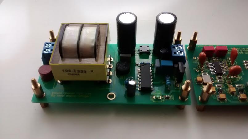

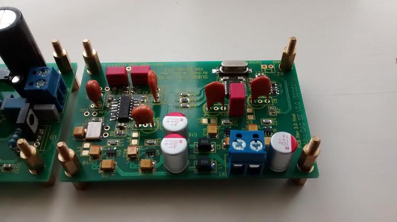

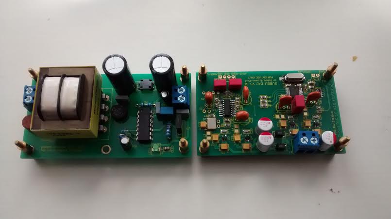

Phew 😀
Will fire it up on tuesday. Or maybe earlier...
Not the prettiest work out here though but I hope it works !
Fingers crossed
