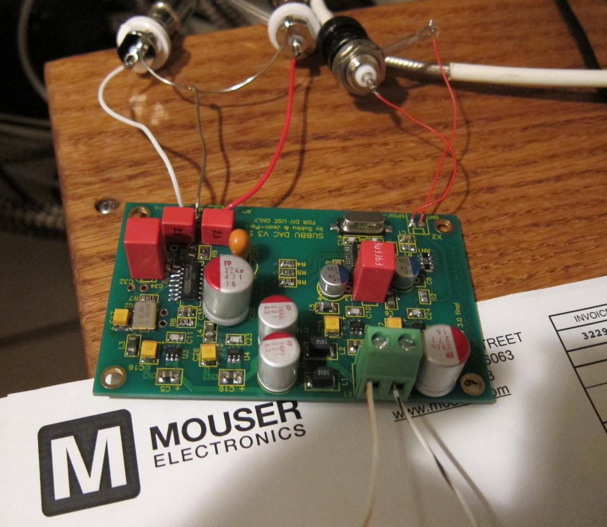

I just fired up my V3 and it seems to be working fine as well. As many pointed out, soldering in Q2 was tougher than I remember in the past. I pretinned all the pads and then soldered one pad down and used tweezers to align the oscillator while keeping that pad hot. After that, I soldered the other pads and used solder wick to remove excess solder. Seems to have done the trick.
---Gary
Good pointer Gary, pre-tin the pads before soldering parts. And if you still struggle with Q2, just put it on its side and join the pads with leftover leads from previous projects.

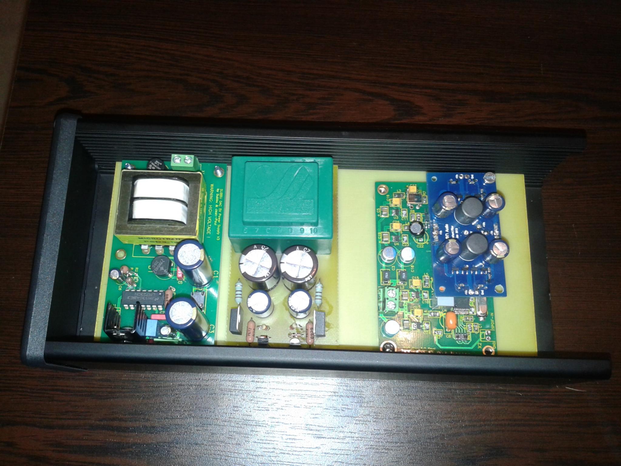

Christmas sure came early - Thx Fred 🙂 Need to warm up the F5 and Aikido tube preamp and get some serious listening done 🙂
Nice case atupi - so if you did not populate C31 and Gary did not populate C34 that can only confirm one or the other ??

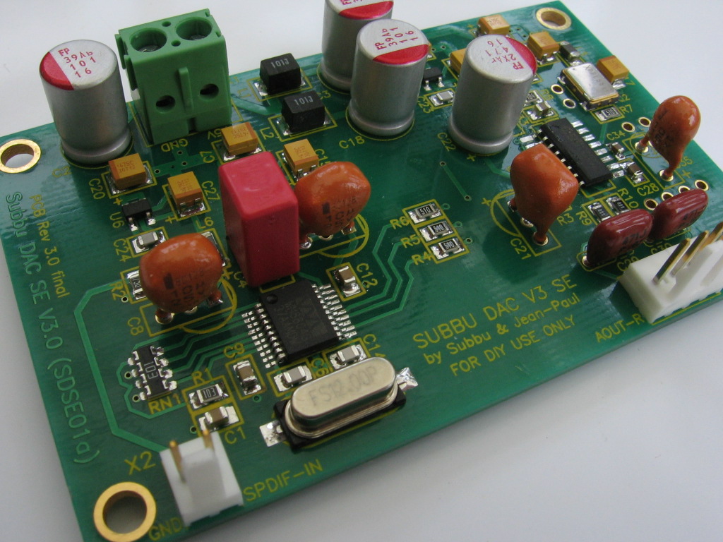

one more DAC lives. All IC pins have been continuity checked and voltages look OK. Need to take a break now, hopefully sweet music later.
These boards are beautiful to work with by the way.
Thanks to all who have gone before for the build tips 🙂
well done Passive420. Curious if you populated C31 and C34? What is the make of those orange "blob" caps?
Bob wish you could finish yours up this weekend 🙂 I bet your old parts work and it was just C31?
Thank you Bob and Neville, actually boys I'm reading back through your posts to establish if I have it correct regarding C31 / 34 etc - So far only C35 is populated with BC128 10uf RAL cap.
The orange blob caps are vishay BC128 10uf/25v solid aluminium caps I have had lying around in the parts box for ages. Nice to able to use them finally.
Spdif input cap is 3.3uf mks, C22 is 470uf polymer.
We dont know for certain if its either C31 or C34 OR both C34 and C31...based on my findings I had to remove C31 to remove distortion and the crlrect voltages then showed up on pins 9,10,11 of 9023. Both Atupi and Gary had one or the other but not both populated.
We know for sure its either C35 or C32 but not both.
I cannot see from angle of your photo but you need to check orientation of C7.
