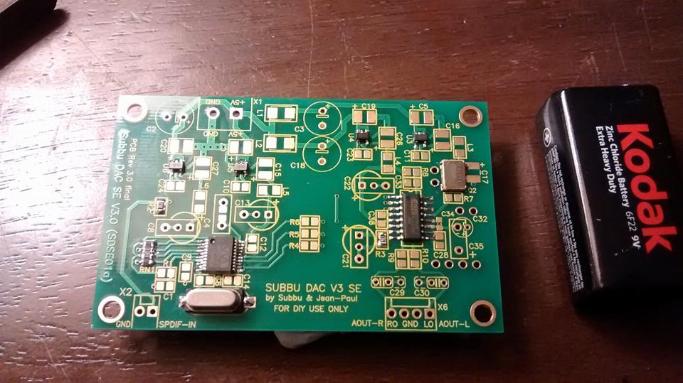

I think I ll stop here and buy a good magnifying glass....

Looks good but I think the 20 pF caps at Q1 will be tough to solder now Q1 is there. You do need a magnifying glass !
You can "clean" the pins of WM8804 with desoldering braid held to your soldering tool (so it will be heated) and then quickly go from left to right on the pins. Of course the braid will have to be on the original spool otherwise your fingers will hurt.
Sometimes you will need to solder the pins a second time. It needs practice. I sometimes use the braid with a lot of tin/lead solder just to solder the pins. It works and looks good afterwards.
Still need to learn Bobs trick to desolder and have such clean pads....
You know what, I did not notice Q2 being soldered. Good job, you are a winner already. I also found those a pain to solder. I assembled a few boards and I haven't tested one of them yet as I practically know I fried the XO. As said before I would use a larger footprint if a PCB rerun would be done.
..........You can "clean" the pins of WM8804 with desoldering braid held to your soldering tool (so it will be heated) and then quickly go from left to right on the pins. Of course the braid will have to be on the original spool otherwise your fingers will hurt....
And lots of liquid/paste flux if you have it. This one is nice to work with and cleans easily with alcohol and a q-tip. Iv'e had good results by coating the braid directly first.

Below is what I did to solder Q2 to the V2.6 board:
Clean all 4 pads of Q2 with alcohol.
Tin all 4 pads. When cold, brush a tiny bit of liquid flux on top of the tinned pads.
Put a small piece of 2 sided scotch tape in the "belly" of Q2.
Position Q2.
Solder one corner. Wait a little to let it cool down, then the next corner so on so forth.
YMMV.
..... but will the tack flux hold the component in place and free up both hands or do you still need to hold with a fingernail or tweezers? Thanks. Kind regards.
In general the tack flux is only viscous enough to keep the part from sliding around. Once heat is added it softens to a full liquid state -which is a good thing for pad and tab coverage. Some method, be it tweezers, fingernail or whatever works best for you is required as the warm flux is smooth enough to allow the smaller caps and resistors to be drawn toward the soldering tip. U1 and U2 placement and alignment is easier with the two pin first technique - IMO.

Replacing Q1 and Q2 did not fix my issue but resoldering 8804 and 9023 did produce music however its distorted.
es9023 pin 11 shows only few mV but should be -3.3V so I need to check that.
8804 pin 9 is 1.7V but does not appear to be connected to anything.
I need to pick up more braid before I can do more troubleshooting.
