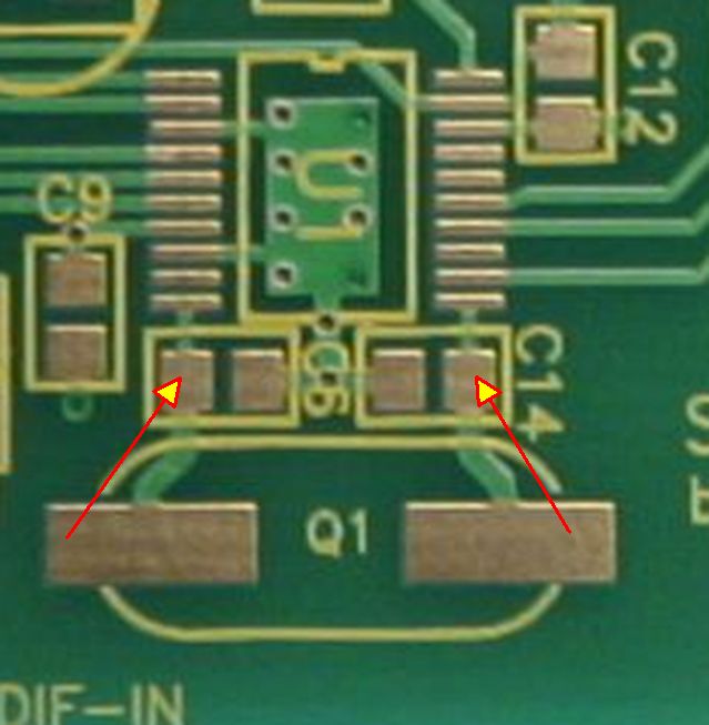

Not a specialists but, It appears the outside pads at C6 & C14 are on same trace. Did you read there?
Hi Bob,
i waq talking about Q2.
Is there a problem with Q1 here ? Not a specialist myself, but a crystal like Q1 must have a cap at each pin?! The comon trace between c14 & C16 is ok for my humble knowledge.
