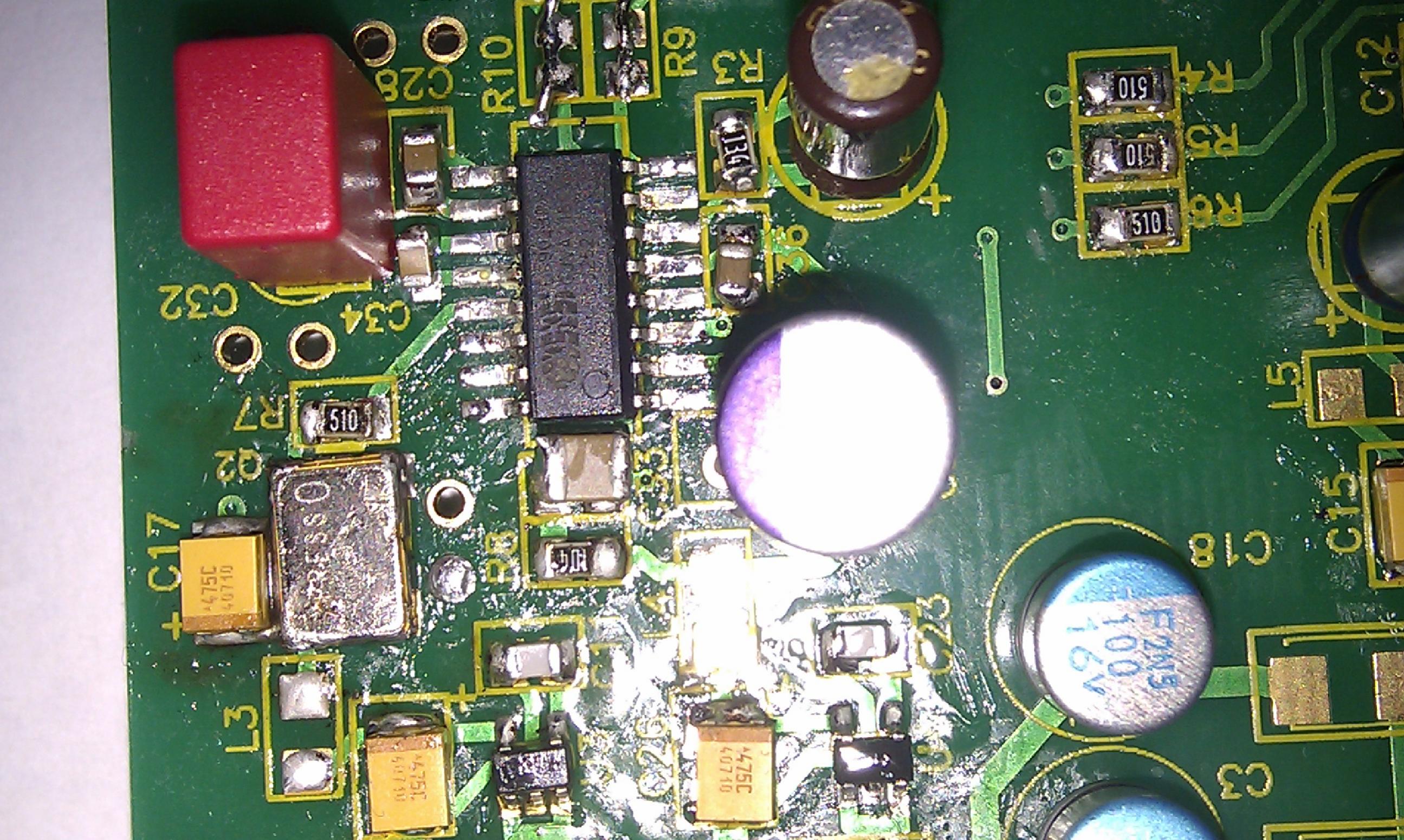

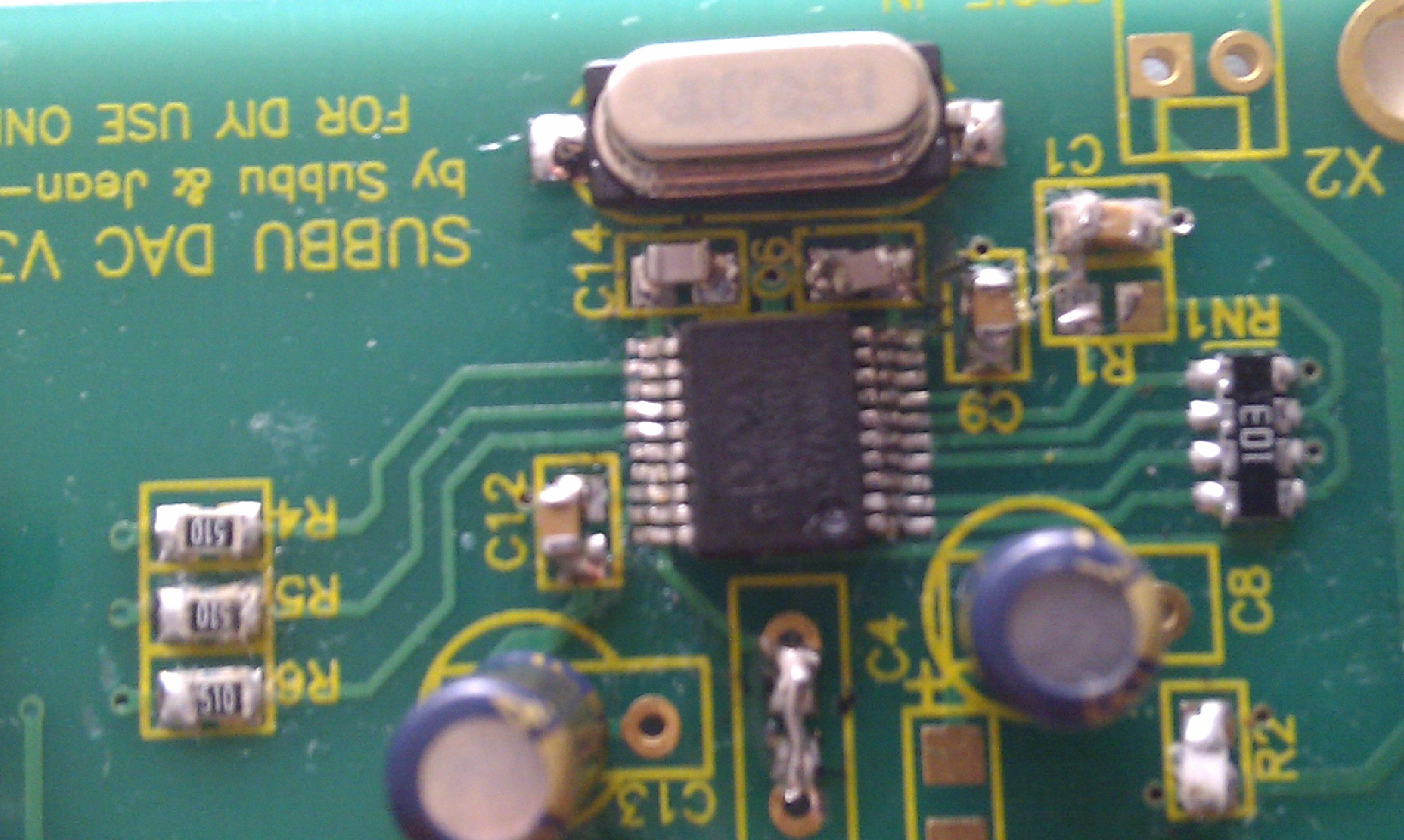

It's my first time smd soldering and have no problem but the Fox XO because of the short pcb here.
I use a lot of flux here and suceed to solder but as Xo crystal are known to be fragile, how can I check it to be sure it's not burned ?
Can listen to it because waiting for R2 : 10 k smd resitor from Mouser (for 2 weeks... waiting is not a problem because JP & subbu learn me the WoW : Wisdom of Waiting)... just asking myself if I need to buy a Xo spare ?
The Blues of the Fox
Sorry my mistake : i talk about R1 on the DAC PCB (near rn1 and C1).
I suceed soldering the XO at 350° iron pen temperature, but as I try many times and the XO was very hot... i asking myself how to check and the need to add a line to my Mouser's waiting list !
for others : As you see on the first picture you must put the iron pen between (below is the right word) pcb & XO crystal... which is not easy ! Flux helps.

And you don't have a 10k resistor, even leaded non-smd in your drawer just for test ? Value is not so critical in that position.
I told you how to test your XO, even without that 10k resistor soldered.
For smd i set 280-290 degrees and always leaded soldering alloy, i hate non leaded solder.

I used Abracon in v2.6 which was my first smd build. I cooked it quite well, but it survived. One member soldered it wrongly, and it still worked after the orientation was corrected. So, it seems to be quite rugged. I wonder the Fox XO is more fragile and requires handle with more care.....
First time round I had Q2 soldered in correct orientation but with 4 x magnifier I found one pad still not connected so I removed it and placed it on its side only to realize I had wrong orientation - that meant pin2/ground was getting Vdd and explained why my voltages around it were off. Put it back correctly and voltages are good. As for the integrity of Q2, still not sure. But I plan to replace Q1, test and then replace Q2 if all else fails.
