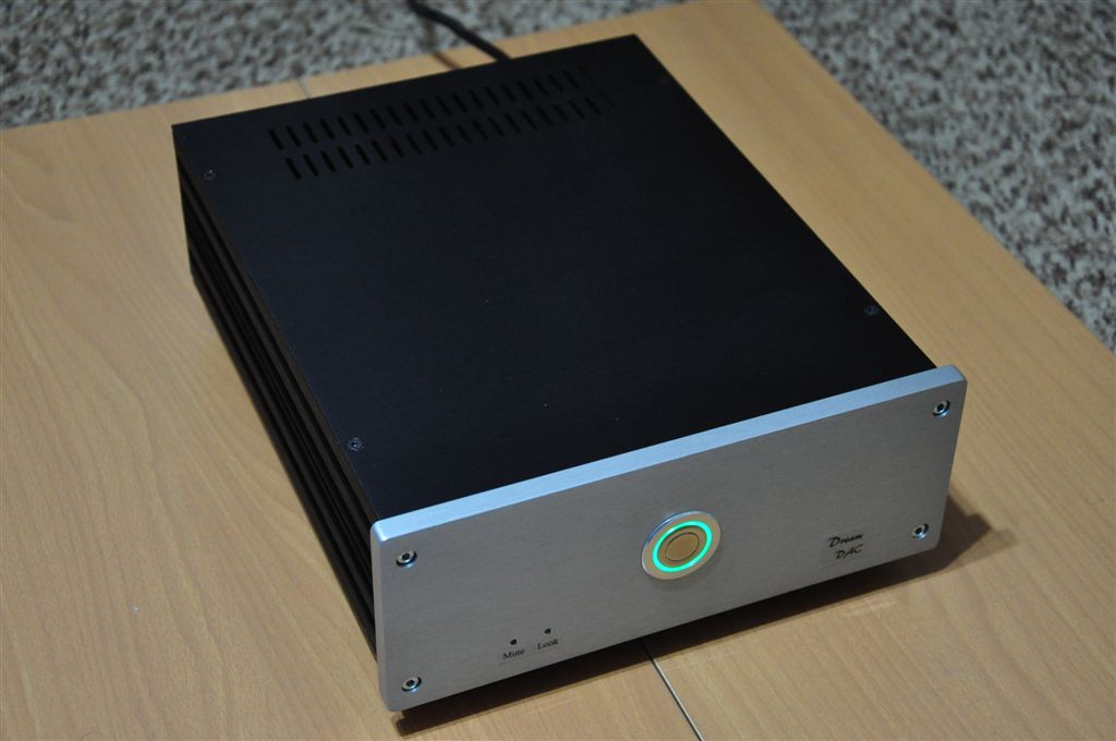

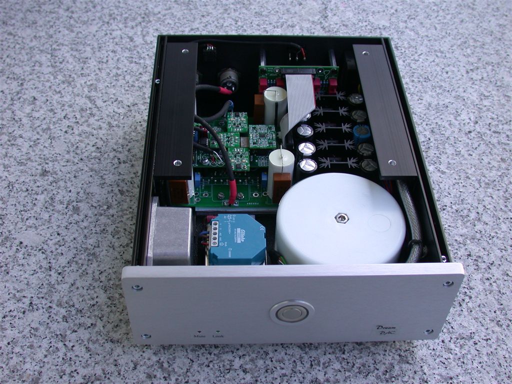

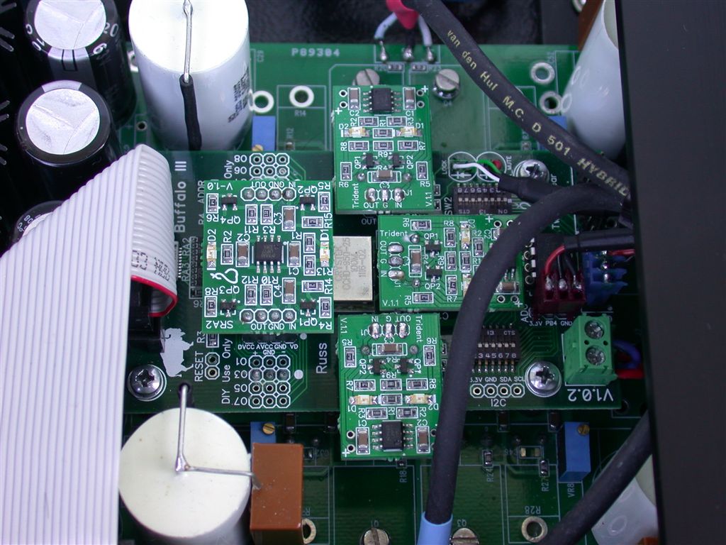

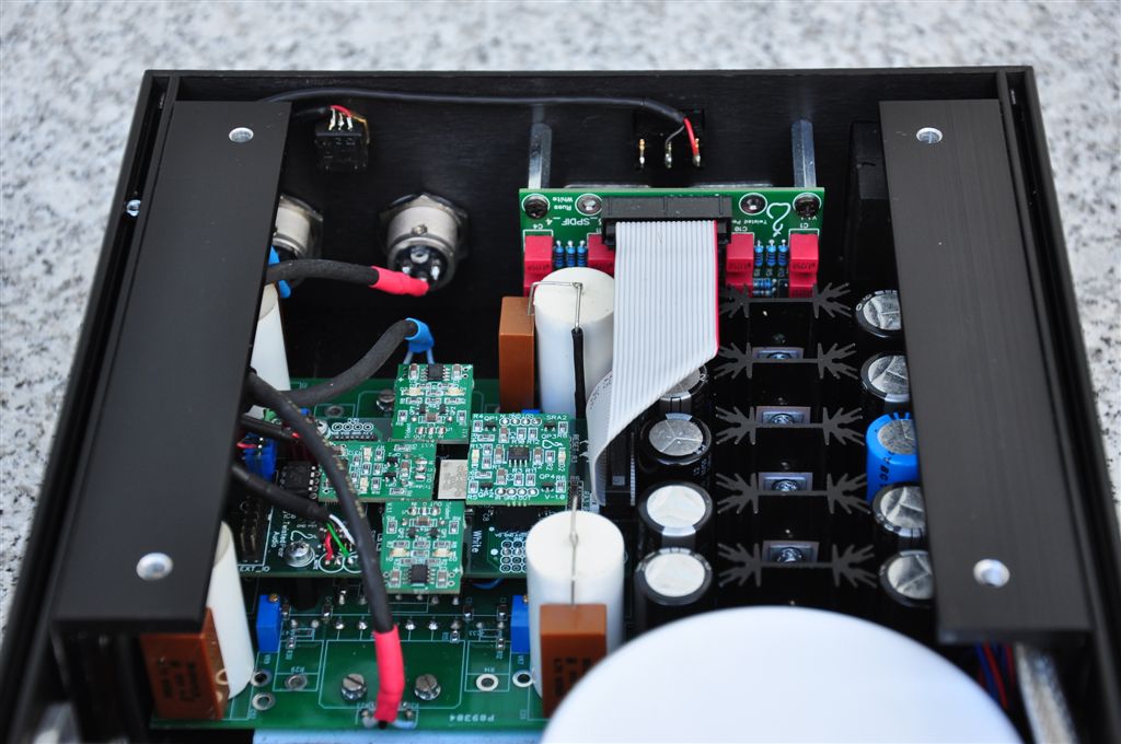

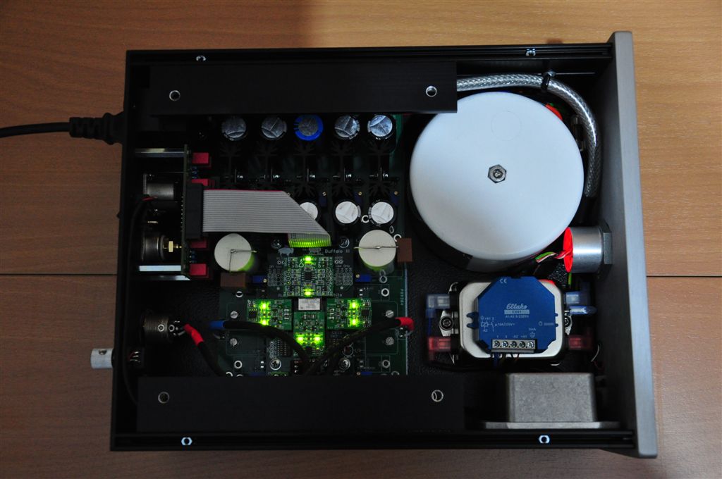

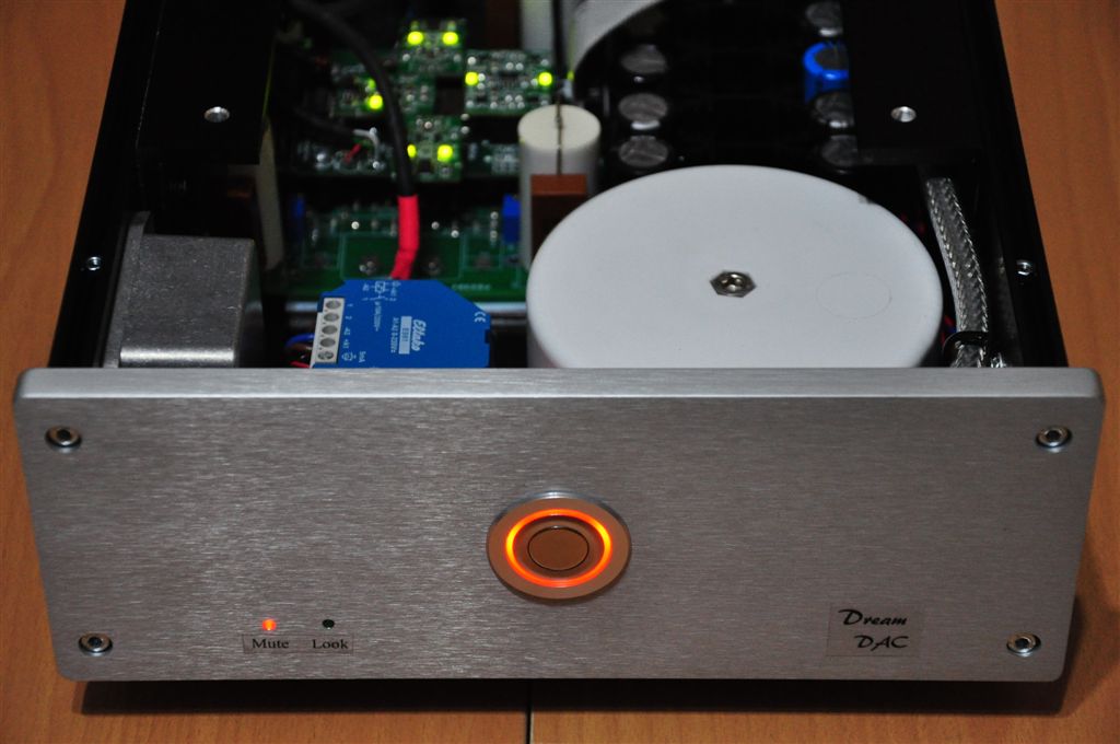

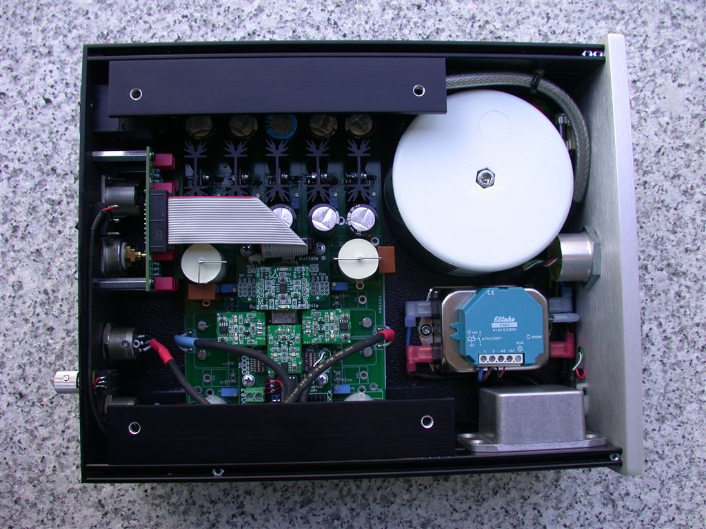

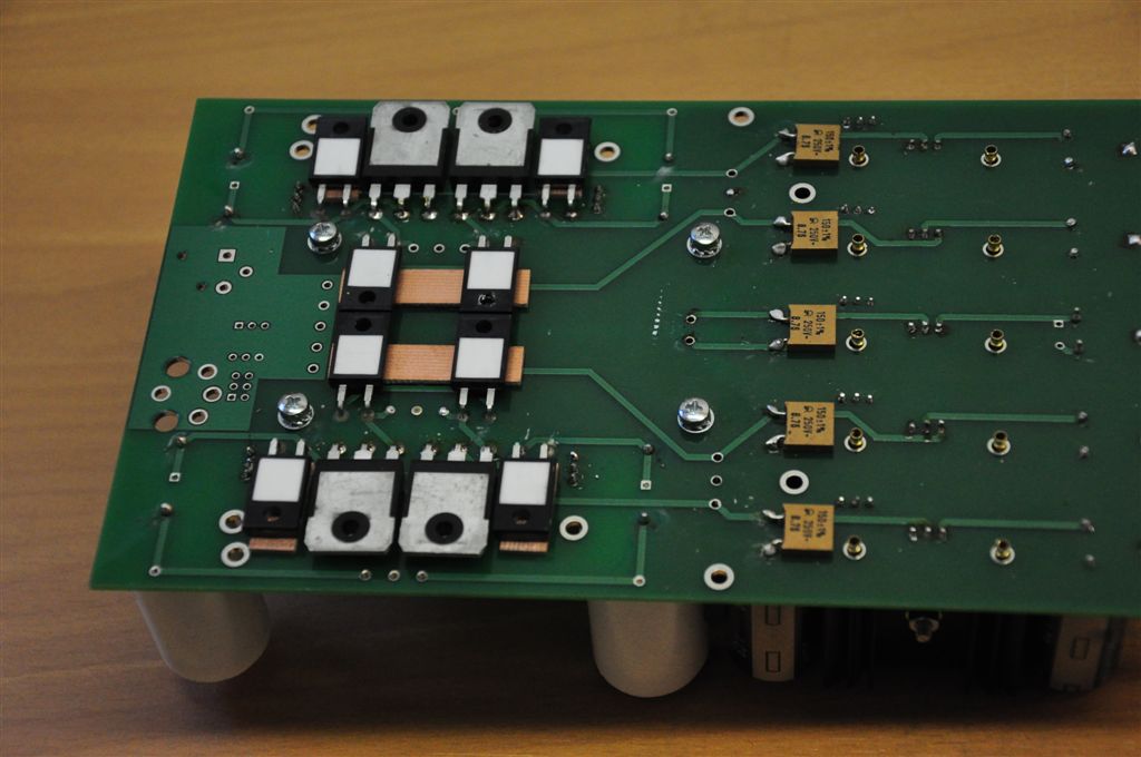

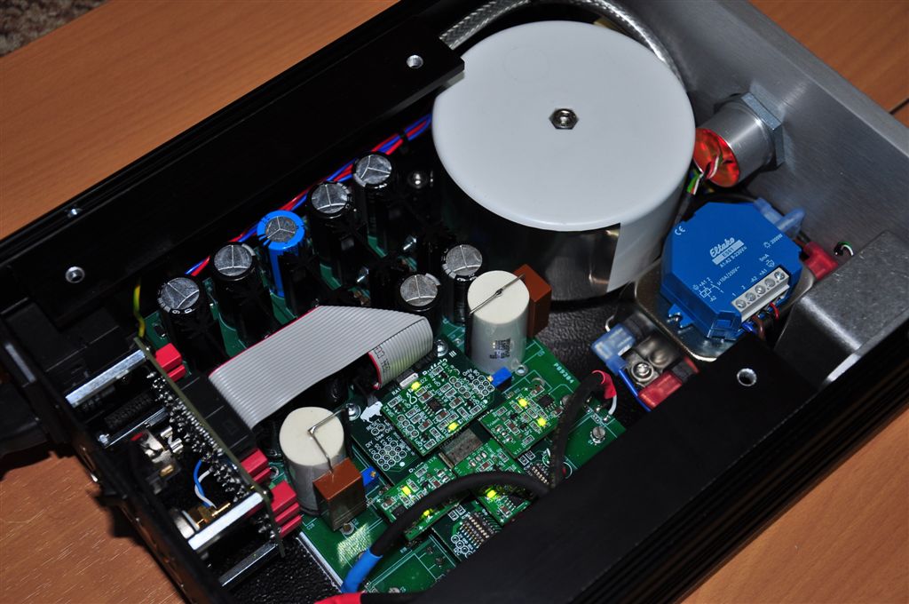

Hello,
now my DAC is ready. A long journey is over
It takes a lot of coffee to get the many good ideas I needed to finish it in this high quality.🙂
The sound is very impressive. Now I get much more micro details from the music. and I can hear very long with it without feeling any distortion. The dynamic is very good.
The four high quality output capacitors I bridged with four silver micas 56nF (new old stock) from the customer Jahre.
Power consumption is 67 watts.😱

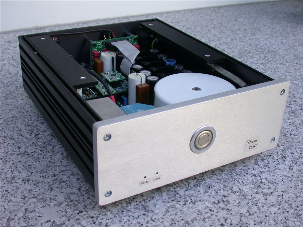

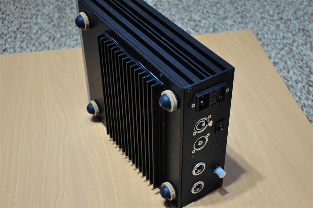

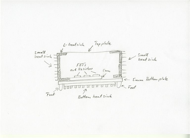

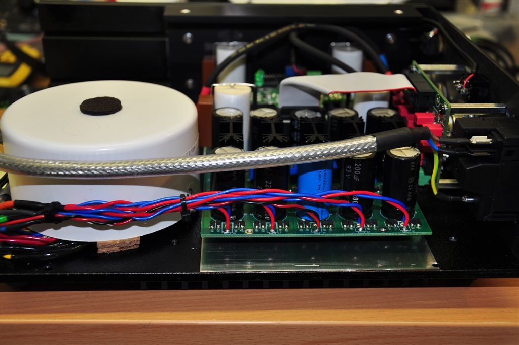

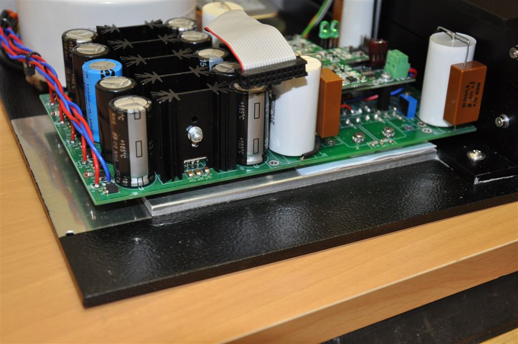

Therefore, I needed to change much details of the original case I ordered from Hifi2000.

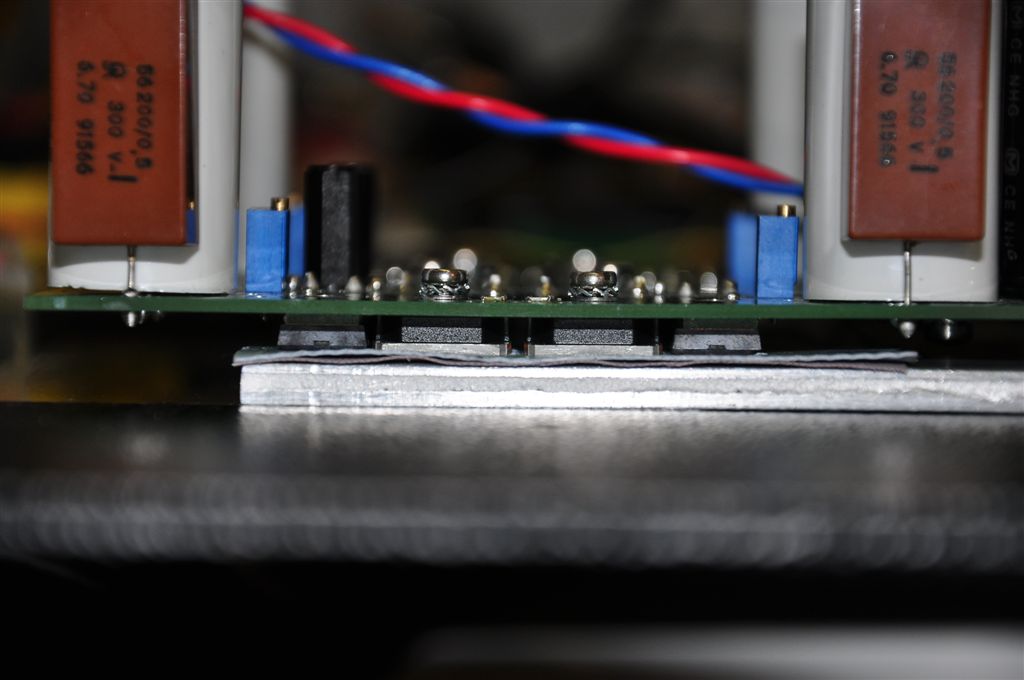

It got a new 5mm powder coated bottom plate, a button heat sink and four L-angle heat sinks (I hope you can see it on the pictures) who are coupling the heat from the bottom side to the top side.
The isolation and thermal coupling of the FETs and Caddock resistors to the bottom plate I made with a combination of a high-tech 0,5mm 86/300 Kerafol and a 86/82 Kerafol red.
Without modify the original case it is not possible to dissipate the heat of the output stages in this case!
The weight is about 6,8 kg
I use a 100 VA custom made transformer with 5 different windings (4x 40V and 1x 9V).

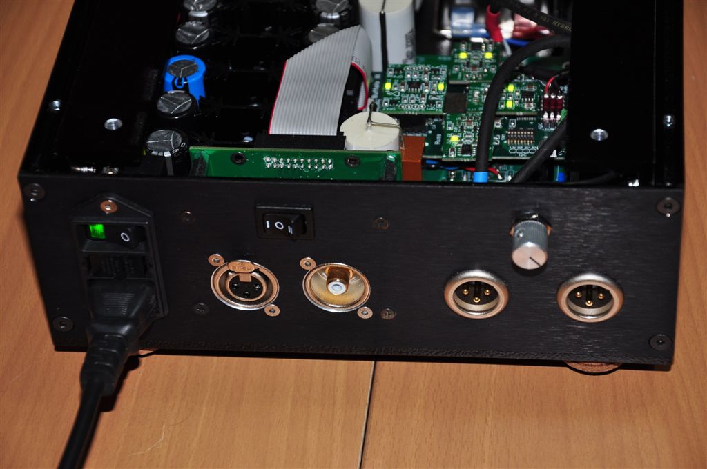

On the backside there is the possibility of changing the output volume.
With the I/II switch I can change between the AES/EBU and the SPDIF Input.
I don’t want to have it on the front side, because normally I only use the AES Input.
With the switch I only change one bit of the remote Input of the Buffalo III.
So I easily can switch between Input one and Input two of the 4-Input board.
If you switch on the DAC with the main switch on the backside, the front taster lights green.
With a light press to the front taster the Eltako ES61 switches on the device.
So It is simulating a normally switch. For this I needed a little auxiliary power supply.
Under the blue Eltako ES61 you find a two stage mains filter from Schaffner FN2080-1/06
I call it DreamDAC because I love it.
The balanced singe-ended design is very good.
Special thanks to Owen and thanks to all who were involved in the development.
I have added many pictures to show you the origin of my DAC and hope you enjoy it.
Horst

Hello,
thank you all for the praise!
Owen it is no problem to mount the Buffalo III Board to the first version of mainboard.
You only have to be sure that the side with the ribbon cable shows to the power supply side.
To turn the ribbon side to the input side of the mainboard is not possible, because the screw holes of the Buffalo are not symmetric. There is not much space between the ribbon cable and the capacitors of the mainboard. But it is ok.
In December I got a Buffalo III board and there was no other option than to integrate it to the mainboard, that I got from you.
With the Buffalo III board now it it easy to integrate a high quality digital volume control and you get it free with the Buffalo III.

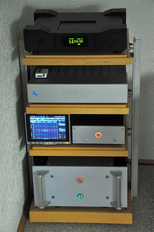

The temperature:
Normally nobody is so crazy to squeeze such a “hot DAC” into such a little case.
But the problem is, I haven’t more space in my Hifi Rack (see the photo).
So I tried to modify the case. It is only 230 x 280mm and there is no more space between the parts.
But now it is ready and the case is good for 4 hours music.
I will test it the next weeks and maybe make one more little changes to get a longer time before the temperature gets high. But for the next time I wanna enjoy the sound.
Owen it is a good idea to take the next bigger size of this case series and additionally install bigger heat sinks on the left and the right side of the case.
But be sure to integrate four L-formed heat sinks (look at my sketch) to get enough of the heat coupled to the left and right side and to the top of the case.
The temperature:

........ heat sinks and chassis - the most difficult part of the build .....
Ciao,
Nic
Yes this is correct.
To dissipate the heat of this DAC design is the biggest problem.
Owen, should we think about less rail voltage?
Does it really sound bad with lower rail voltage?
If you wanna use this DAC with +- 45V for a longer time, you need a big case with big heat sinks. Also the regulaters get very hot in a closed case.
