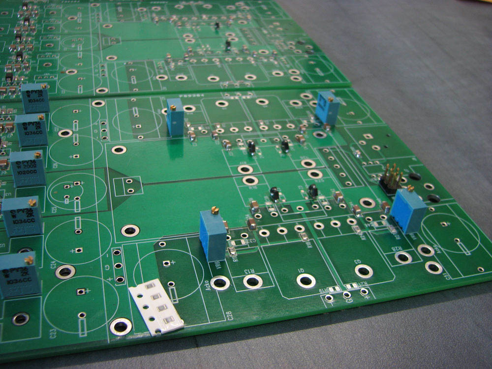

I guess it's time for me to understand how this toy works:
It kind of play music, but something does not work as it should. Let's say that I start with 0V on the DAC pins. It works. Now I start increasing the voltage. it looks like it increase linearly, up to 0.8V then it does not go further and if I continue turning the mosfet shut off and I have all of a sudden almost the same voltage on drain and source.
Looking also at the distortion and amplitudes, it looks like I get the best performances with the pin voltages at 0.390 V.
Why do you think it does not behave as it should ?

I'm going to bet you have the protection diodes installed at the inputs, and you didn't implement the fix that's required there.
There is an error on the board where I put the input protection zener diodes in parallel, rather than in series. If you look at the schematic on the first page of this thread, you'll see that Z4, Z2, Z6, Z8 as well as Z1, Z3, Z7, and Z5 are each in parallel at the input when they need to be in series. this is mentioned a few times in the build thread, but it's easy to miss.
So... when you go to adjust the input voltage up to 1.65V, both Z2 and Z6 will start conducting at about 0.7-0.8V and essentially shunt your drains to ground. That's why you can't get above 0.8V, and also why things aren't working properly.
You need to remove all those diodes and do one of two things:
1. Leave them unpopulated - I did this and all is well.
2. re-populate them but solder them in series, anodes facing outward, by making a little teepee with both diodes where one used to be. I've attached a picture from qusp for clarity.
Implement that fix and you should be ready to go!

That's why I love this forum, everything is back on track.
Uncle Tom's cabin with diodes was far beyond my smd soldering capabilities, so I left the diodes not populated.
Thanks,
I'll let it run for a bit more and then move to the listening room.
I'm still a bit worried about the final dissipation. It runs kind of hot. My transformers have 13 % regulation, now I am running at 46 V. Not a big change.
Aren't zener with higher voltage available that can fit there ?

Hi Davide,
The zener voltage is not relevant when the parts are forward biased as they would be in this setup. The zener voltage only applies when they're reverse biased.
When they're place in series, they won't start to conduct until you exceed the zener voltage of the first diode plus the forward voltage of the second diode. So if you have a pair of 3V zeners, then the whole arrangement will conduct when you exceed 3.7V. With the way they are now on the board, you could use 100V zeners and it would still not allow you to get above 0.7V.
The real solution would be to use a part like this:
http://search.digikey.com/scripts/DkSearch/dksus.dll?Detail&name=568-4044-1-ND
That part is basically two series zeners in one pack that would fit on the existing footprint.
Did you measure your DC voltage before the regs? Could you let me know what it is?

I have 56.5 V on the cap before the regulators. From the spreadsheet this put 2.5 W on each regulator and almost 44 W on the heatsink.
If I get to 50 V I will have 1.7 W on the little sinks and 52 W on the big heatsink.
What do you advice ?

Hi Davide,
Those numbers seem reasonable to me. You'll need to keep an eye on things when you mount it in a case, but the setup you described should help rather than hinder.
Try measuring the ESS DAC itself and see what temp it's sitting at. I'd bet it's reasonably low.
In a perfect world, you'd be best to get a new pair of 35VAC transformers and run the I/V at 45V. That would alleviate the dissipation on the regs and keep the heatsink temp a little lower.
In a non perfect world, you're probably better off transferring some of the load to the larger sink so that the regulators run a little cooler. Once you mount it in a case, most of the heat from the large sink will stay outside the case, where the heat from the regs will be captive inside the case. On that note you'd be best to minimize the load on the regs.

Swapping the taps I have 49.5 V DC in and I set 45Vdc out. That's just perfect. 1 W on the little sink is ok.
