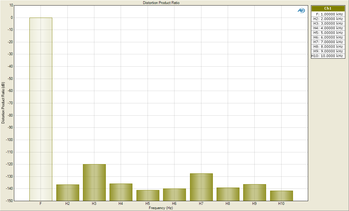

After following a discussion on another thread, there are a few things I'd like to clarify and prove with actual measurements. I hope it will put a stop to some of the random numbers and claims people have been throwing out. Russ, this is addressed to you in particular. If you want to make technical claims about the Legato being better than the circuit presented here, then please post actual measurements and numbers. If you don't have proof on hand, then you're not in a position to make blanket statements (or any statement for that matter) about performance. That applies to input impedance, THD, noise, frequency response, etc.
For the record, the input impedance of the NTD1 with FQA34N20 fets and 45V rails is 2.14 ohms differential. I measure 11.80mVRMS across the output pins of the Buffalo II board with a 0dBFS signal sent to the DAC and connected to the NTD1. According to the datasheet, the DAC outputs 3.903mAP-P under these conditions, or roughly 5.52mARMS with four parallel outputs (stereo mode). Using good old R=V/I, we get about 2.14 ohms.
If you made the overall output at 0dBFS closer to 1.1VRMS, then you could halve the resistance values used, which would drop the input impedance down to about 1R.
I know it's nice to think the Legato has low input impedance, but has anyone actually measured it properly? Simulations and guesswork don't count. I want to see an actual measurement the exact same way I did above. When we have that, we can make a real comparison. This will probably be more useful than guessing what the input impedance of both circuits is, and making statements based on that.😕
I'm also expanding the above requests to all aspects of performance. I'd like to see a full set of THD+N measurements, along with IMD numbers. There's nothing to hide on my end; the NTD1 performs incredibly well and I have the actual measurements to back that up. Not simulations, not wishful thinking, and not guesswork. They're attached at the bottom of this post.
If someone wants to send me a Legato, I can measure it under the exact same conditions and then maybe we can try to draw some conclusions about why several people feel the NTD1 sounds better.

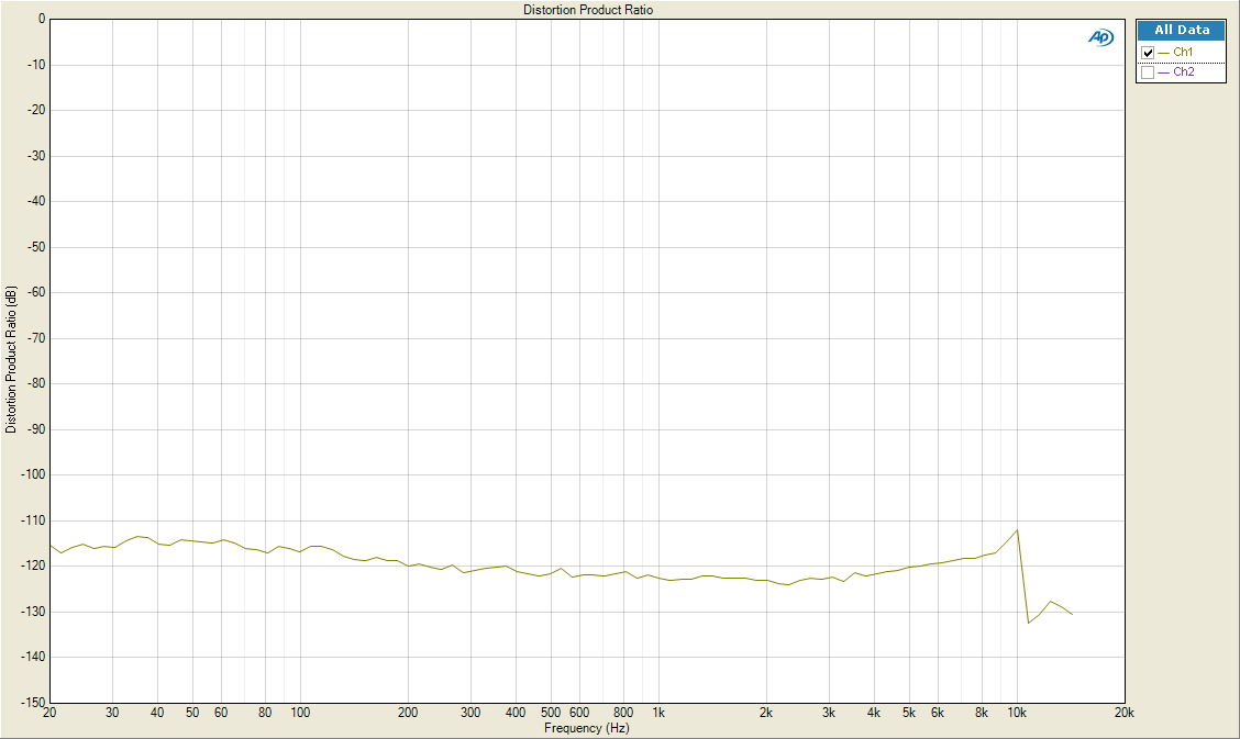

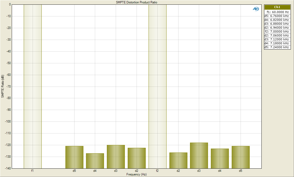

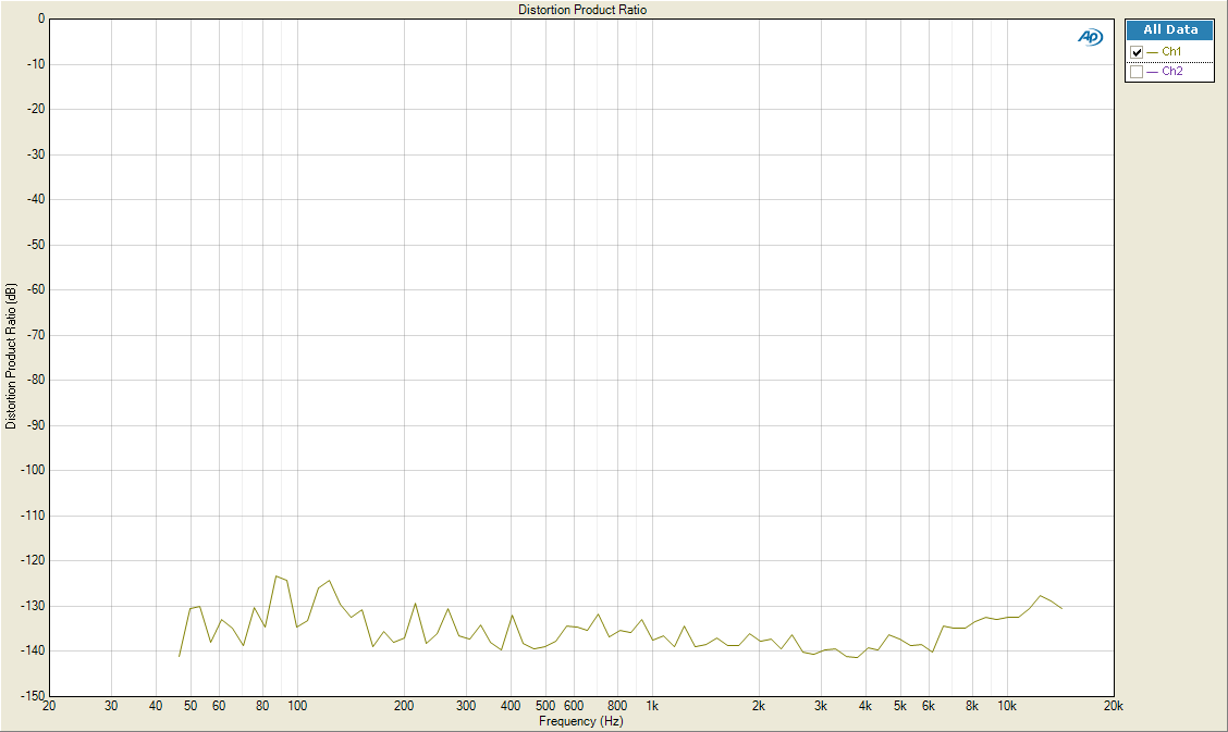

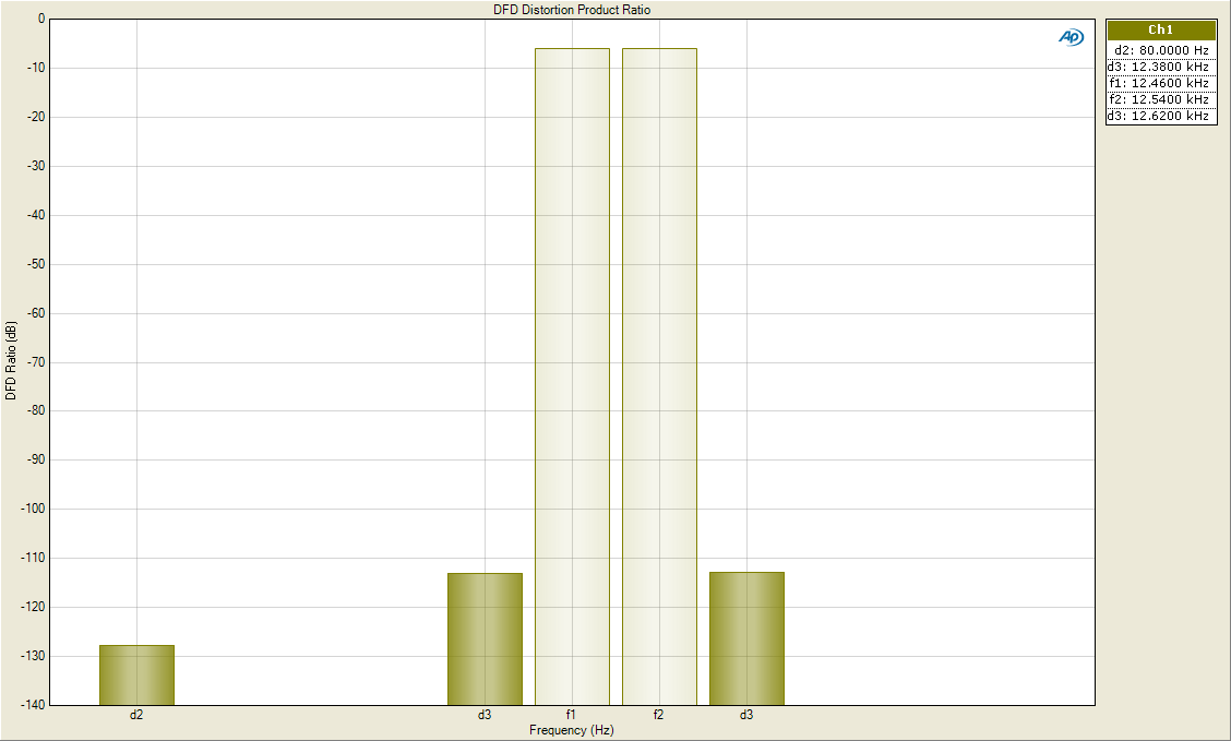

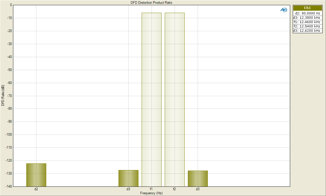

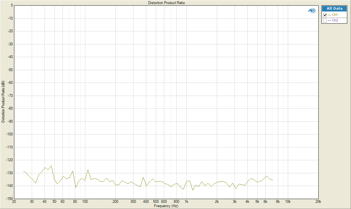

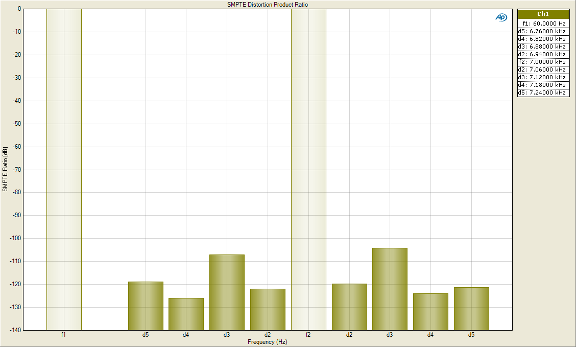

Hi Russ,
It's not angst as such... I just like to minimize unsupported claims. I'm not upset, I just don't want to spread misinformation one way or another.
If your claim is that input impedance is important to the performance of the ESS DAC, then it would be nice to see the specifics. If there's a difference in distortion between a <1R and 2R load impedance, I'd really like to see the actual measurement to support that. I'm not saying it isn't true, I'd just like to see the proof rather than hear it second hand. People here get really hung up on stuff like that, and it can be misleading if its not true. This applies even more if it's part of a statement that implies your product is better by virtue of the claim. See where I'm going with this?
If you'd like me to run a Legato through the AP, I'd be more than happy to give it a go. As long as I can mount it to my BII, we should be able to get a very fair comparison between the two. Send me a note offline and we can make arrangements.
Owen

Hi Russ,
It's coming up now because of your post yesterday:
http://www.diyaudio.com/forums/digi...-iii-dac-tube-output-stage-3.html#post2714833
That's a very long-winded way of saying you really don't know if there's a difference between 0.5R and 2R, but you took the liberty of implying there was here:
Which is what I took issue with.
That's a very loaded statement as well. Distortion simulation is very tricky, and sometimes results can line up, other times they're not even close. I have some great examples of the latter. The truth is that there's no way to tell until you measure the real thing.
I did buy a BII didn't I? Nothing says "I support you" like cold hard cash 🙂
I really do appreciate all the work you do, and I think you turn out some great products at fair prices. I just take issue when you overstep the boundary and turn from Technical Ross into Salesman Ross. One I appreciate, the other I do not. This is the sort of thing I'm talking about:
http://www.diyaudio.com/forums/digi...ssic-pass-labs-d1-ess-dac-30.html#post2317699
If you want to support, then just say "Great Work!" and if you have meaningful technical input, then just say "Hey, you can improve the distortion performance by lowering the input impedance of your circuit".
When you say things like:
you clearly have other intentions.
There is no problem there, and you're certainly welcome to your opinion. I do somewhat take issue with fact that you're drawing a conclusion based on circuit other than the one presented here, but that's beside the point. Not all common base amplifiers are created equal, and unless you tried exactly what I've settled on here, then it's not really fair to draw conclusions now is it? With higher resistance values, lower voltage and different mosfets, who knows what you'll get.
Owen

It's interesting to see measurements, mostly if done with great equipment like the AP. For me is always a bit frustrating to do measurements, as nothing works as it should, but I Think nobody would judge the sound over a 2 dB difference in THD down at -160 dB. I wish I could hear that.
I commented in favor of the D1, and this could be real, or only a psychologic effect, as I had my last toy done, but it could also be that the implementation is very different.

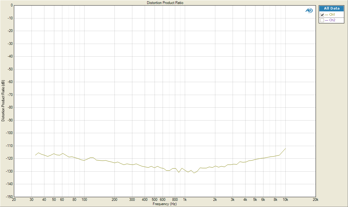

~-114 and -117 db THD+N?
