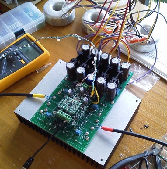

Good news and bad news:
I finish to assemble the board, and I could fire it up. I have few problems (not sure if they are problems):
1) The distortion spectrum looks like the picture attached. For all the four phases.
2) What temperature are the sink of the regulators in your built ? Mine are very hot !!
I also have a question: there are the four trimmer to set the voltage of the in pin. What voltages should I set ? I put them to zero now. Is it correct ?
Thanks,
Davide

remember you absolutely have to keep case temp well under 70 degrees or you will kill the sabre dac chip

That's OK, I am more worried about the caps of the psi.
What about the voltages of the in pins ?
D.

Connected the BII to the I/V output pins BII measure 1.61V-1.65V
Hi Davide,
Looks great! Congrats on getting it up and running.
The regulators for the PSU do run pretty hot, but it's nothing to be concerned about. Just for the sake of safety, can you tell me what the DC voltage is at the input and output of the reg? The lower you can get that voltage drop the better, and it will depend on what transformers you have, and your line voltage.
If the differential there is way too high, you might be dissipating too much power in the regs. Ideally, for 45VDC output, you want to see about 50VDC at the input to the reg under normal line conditions. The dropout on those regs is somewhere in the ballpark of 2V.
As for the caps on the PSU, they should be fine if the temp is around 50-65C. I always buy 105C rated caps, but some of the fluffier audiophile parts only come in 85C flavours.
The voltage at the input of the I/V (or the voltage presented to the ESS DAC) should be 1.65VDC. Adjust each pot with the unit connected to the Buffalo board until you read 1.65V from each pin to GND. Check that voltage again after everything has warmed up and settled in. It's normal for it to drift a little bit with temperature.
Something does indeed look wrong with that distortion plot. There's broadband noise and what looks like harmonics of a higher frequency in there. If you've got everything working correctly you shouldn't even be able to see the second and third harmonic if your measurement floor is -110dB 🙂

I am not at home now, will make the final adjustment tomorrow. The distortion plot is strange, but these things are artifact of the signal generator, as I have them only at 196kHz. So they do not depend from the IV stage.
The transformers are custom made by sumr with 40Vac. I'll check the output tomorrow, but I think that the in-out difference is more than 2V, as I could have 50V out with no load.
In case can I increase a bit the supply voltage of the IV ? How much high I can go ? Like this I will have more heat on the sink, that will be mounted on a metal plate with a hole underneath.
