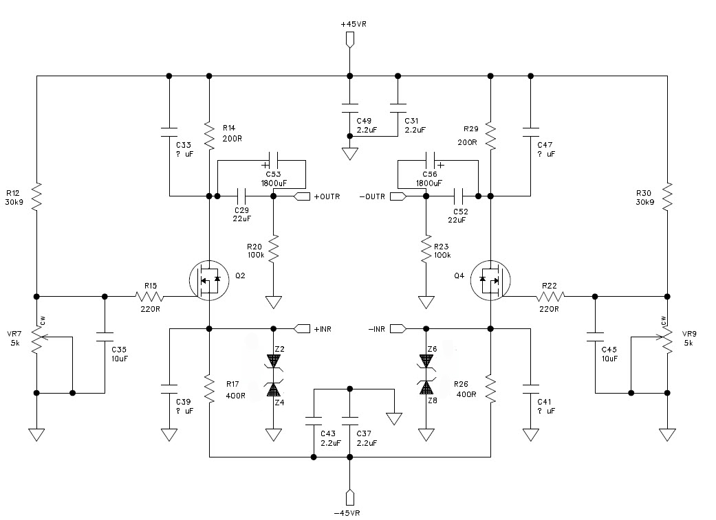

Hi Guys,
I picked up my DAC to finish it now and came up with the issue of the wrong orientation of the input protection zeners.
So ...decided to put up a picture with the schematic corrected if it's ok with you owen ?
Official schematic at beginning of thread should be updated i guess, leads to continuous confusion for some.

Hey CeeVee, this has been covered a number of times, there was a mistake on the PCB, you need to make little zener tipis to make back to back zeners. there are pics in this thread as well as the other one. i'll see if I can track it down. they go on pads Z1, Z2, Z7, Z8 putting them on all the pads of course wouldnt actually protect that well, they need to be back to back as in the schematic.
