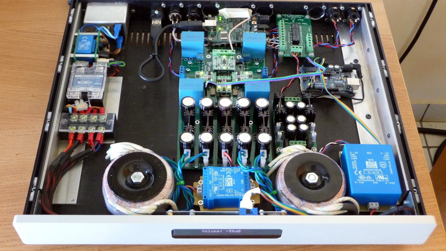

Hey Owen - I was wondering if you ever built this enclosure? Based you your approach, I drafted a similar case. Dimensions will be 11in deep by 16in (ID) wide and 6in tall. Total width is between 20in and 24in, depending on if heatsink extensions are installed. I found some unique heatsink on eBay for this.
With the height, I partitioned it as two 3in levels. Heatsinks were $35 each, and raw 6061 aluminum came to $166. Wouldn't even tell you what it's costing me to have is milled, drilled, tapped and polished. 😱 I'll just say that I'll not be going 'all in' on a case like this until I build up a small shop with the gear I need to do it myself.
Anyway, as much as I've enjoyed the NTD1, it'll be worth it. Case should be assembled by the end of next week. I'll post pictures 😀😀
Hi Guys,
I drew up a quick model of what my plans are for the DAC, so everyone can get an idea of where I'm going with mine.
For reference, the bottom plate is 0.5" thick, the whole DAC is about 12.5"wide by 12.25" deep and 3" high
I'm going to use Aavid 65535 extrusions cut to 3" lengths for the sides.
The 1" by 1" bars will transfer heat from the bottom plate to the sinks, and the whole thing should run pretty cool.
The .zip attachment is the Google Sketchup file.
Owen

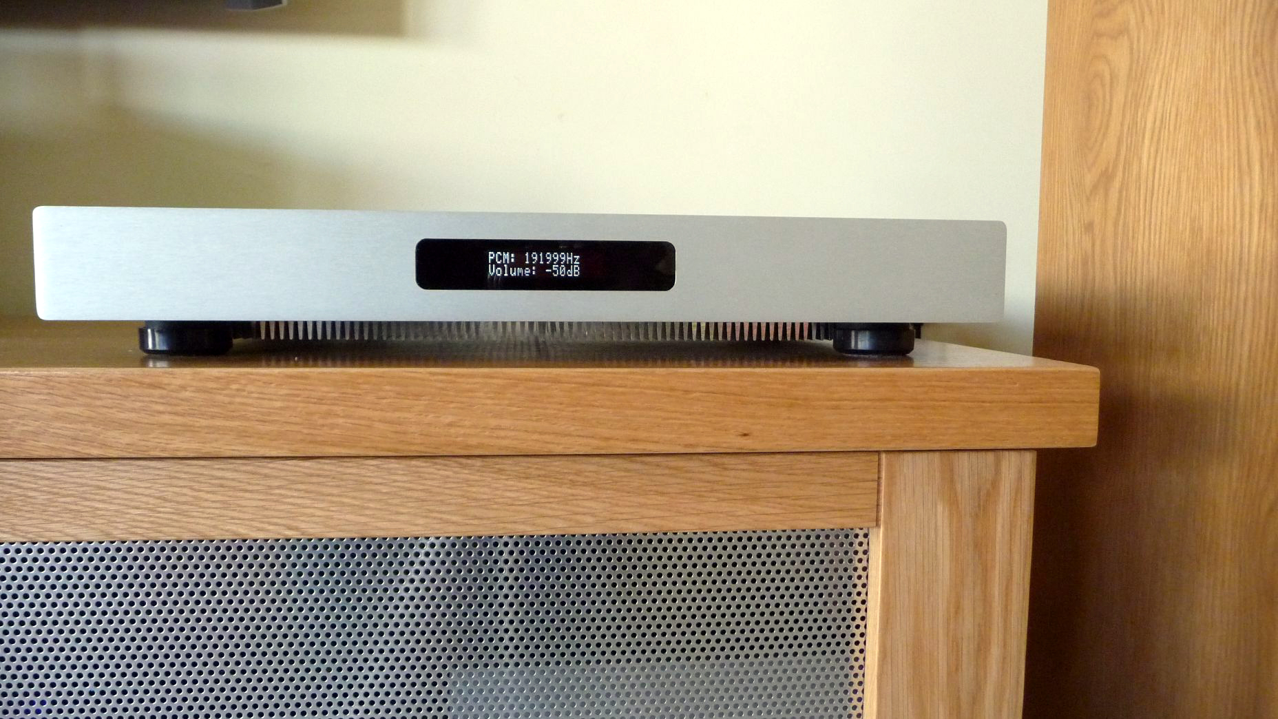

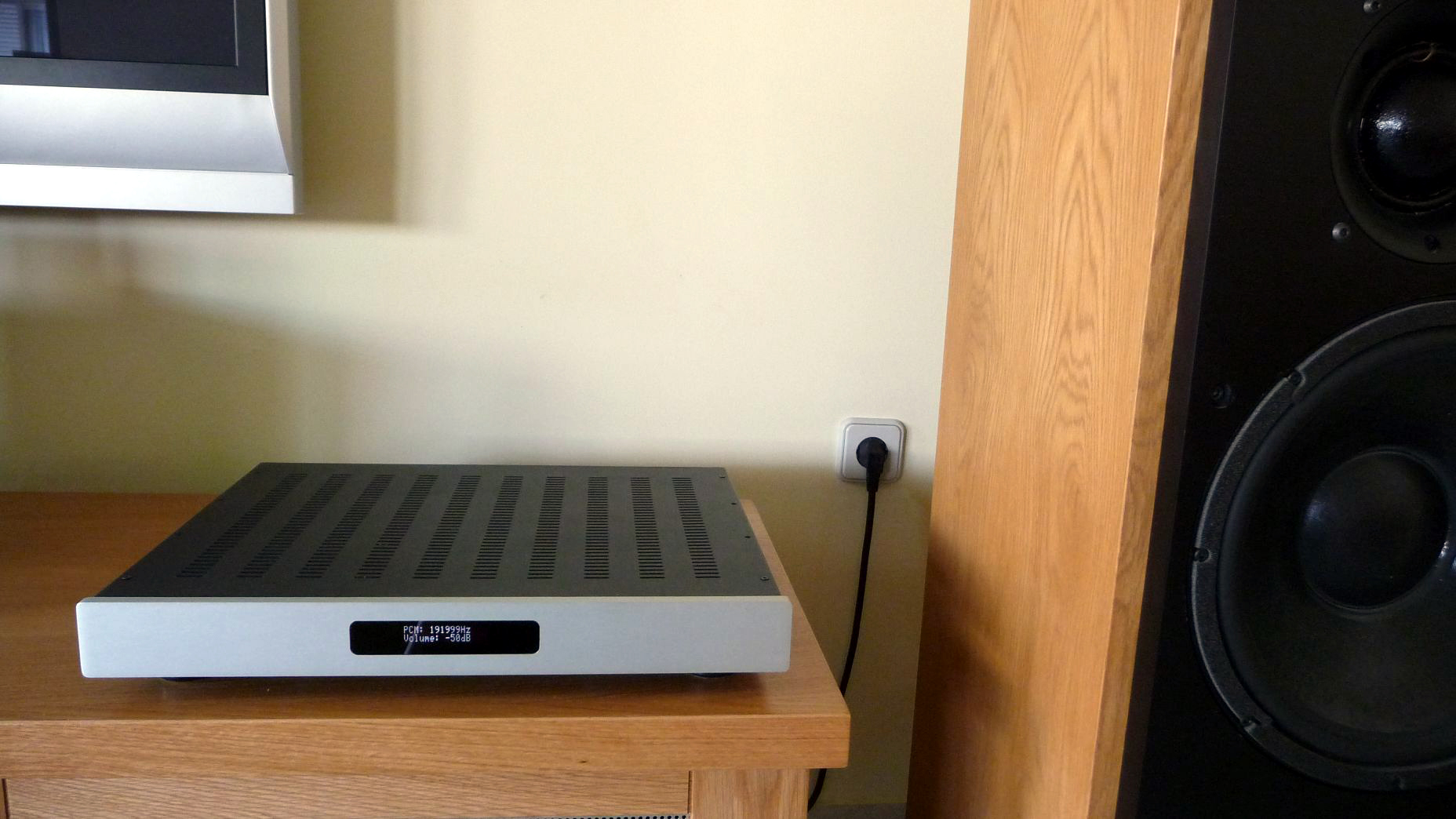

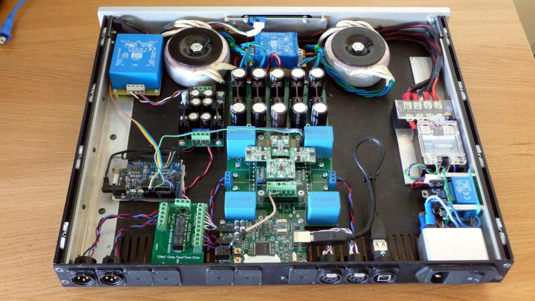

Wow! I am green with envy!
That is by far the cleanest implementation of the NTD1 I've seen to date.
Wanna make me one? 🙂
Mine is still a tangled mess of wires in my media cabinet 🙁
How are the thermals? Does it run at a decent temp?
What is the deal with the output arrangement? I can't quite figure out from looking at it how you hooked it up.
Owen
Owen
After running it for 8 hours the temps seemed acceptable.
The output has a relay that serves as a pass-thru for my surround processor when the DAC is turned off.
