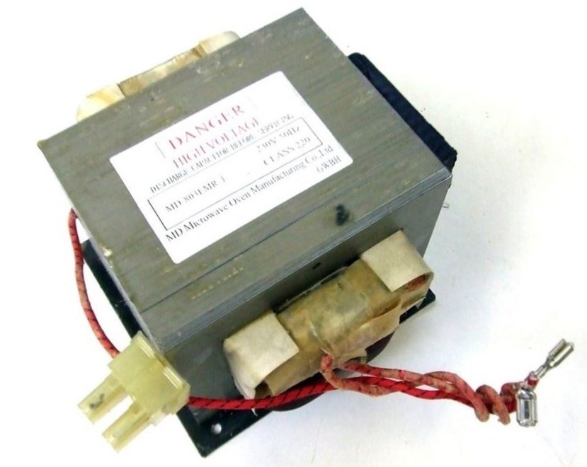

If you want a very nice high current, low distortion choke that can provide the measured data shown a few pages above, do a search on eBay for a MOT part number "MD-803AMR-1". These measure about 67mH and 0.47ohm DCR.
Coming late to this but always on the hunt for a bargain.
In the UK I have found some MOTs reference MD-803EMR-1. I take it that the specifications are unlikely to be significantly different to the US one above and could well suit this project?
Also if I can get hold of 4, would it be safe to assume that a slightly higher supply voltage to offset the additional dc resistance of two of these in series might be beneficial, or is little sonic improvement likely with double the inductance?
I don’t think you need more inductance than 50uH to 100uH - it serves to store energy to give a higher peak-peak outpt than available from the rail voltage.
