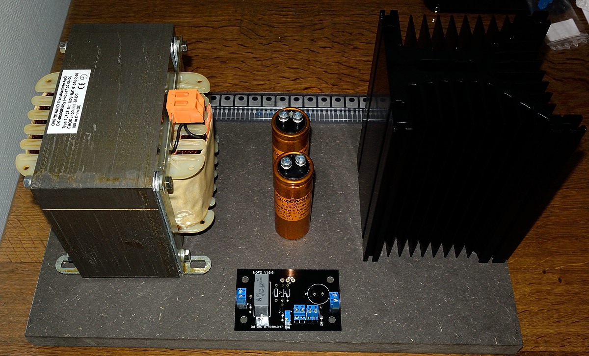

Some pics 🙂

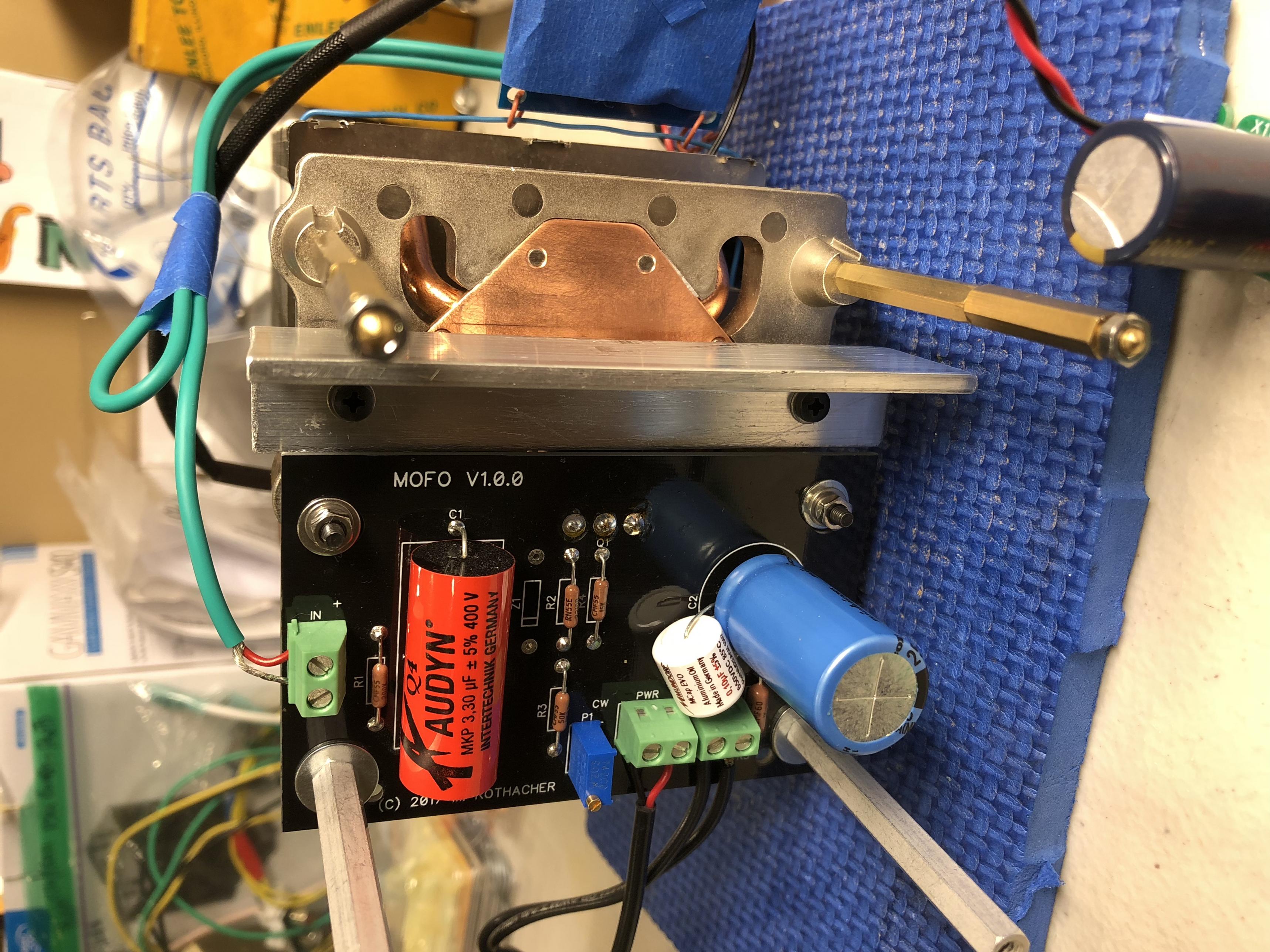

Is it M5 bolts with hex head you use to fasten the MoFo PCB to the heatsink?
Ok......I have ordered some of these. I have same kind of heatsink. I got most components soldered on PCB while watching Tour de France. The acrylic panel to mount connectors may also be my choice. Seems to be 3mm acrylic panels...….they are probably easy to cut.

I can see you use an isolator pad between the mosfet and the heatsink. Strictly it is not necessary to electrical isolate the mosfet from the heatsink when you built without a grounded chassis?
So do you use the isolator just instead of thermal grease? ….and not to also electrical isolate the mosfet from the heatsink?

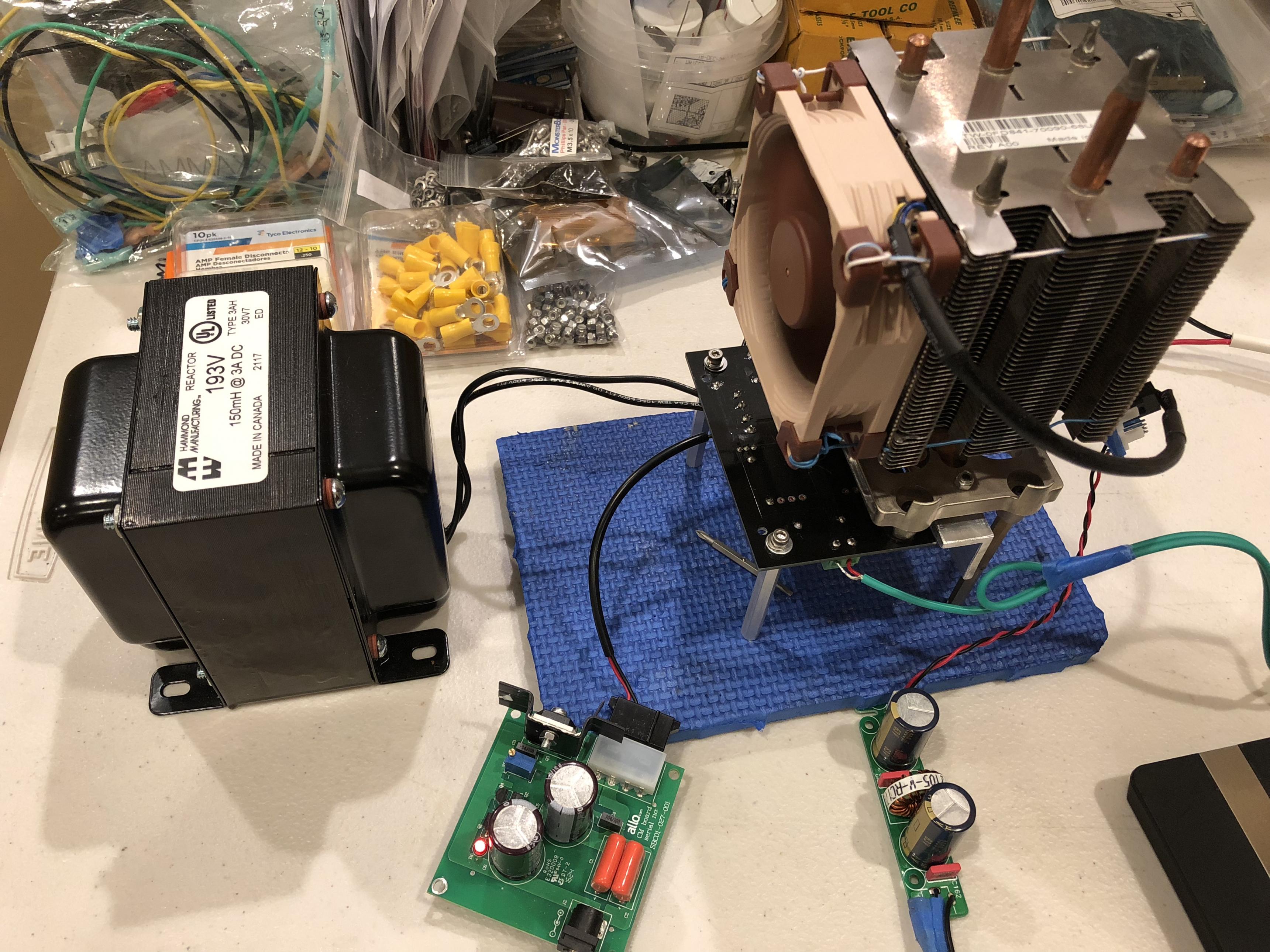

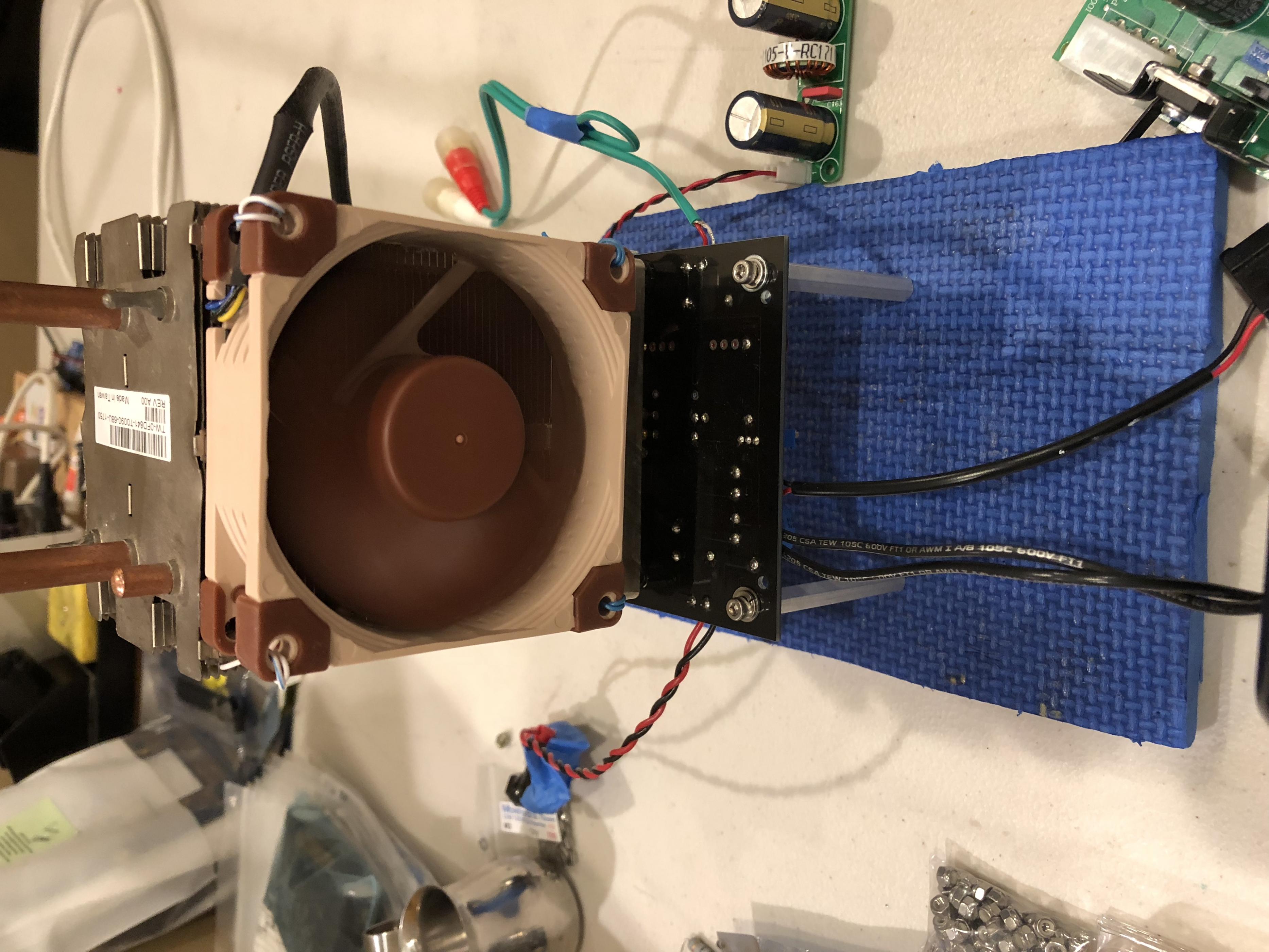

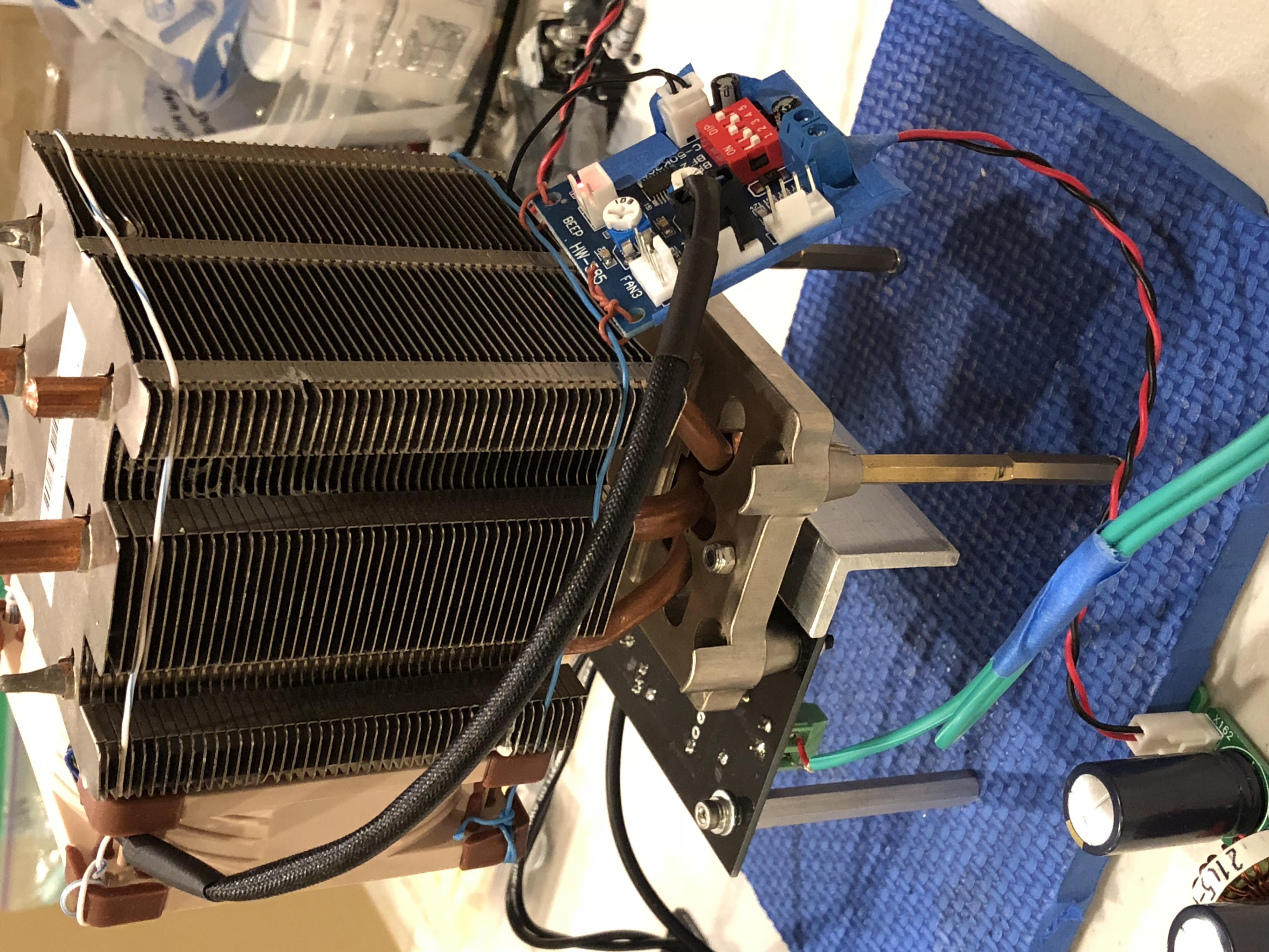

Curiosity got the better of me........
I disassembled a perfectly fine stereo Big MoFo because I had to try the fan/CPU cooler solution that I’ve had good results with in recent builds.
The Big MoFo is another amplifier that can run cpu coolers with very good results! It works so good, I thought the bias was to low because the cooler pipes were barely warm. I checked and It was right at 2.5A. The aluminum angle used to clamp the MOSFET to the copper pad is the hottest part at 42°C. I used a Dell FD841 cooler with a Noctua NF-A8 PWM fan(INCREDIBLY QUIET) and a PWM fan controller sourced from eBay. This cooling system is approximately $25 less than the original 11”x7”x3” aluminum heat sink the MoFo was attached to. And a huge reduction in weight! (This is just one channel)

Ok..... use of an isolation pad is probably more safe. I was thinking that heat transfer was better just using just thermal grease. I have pads left from the ACA project as I got two stereo kits but built it as mono blocks…...so I will use these. I just discovered that also these mosfets for the MoFo are clever made as screw is electrical isolated so no need for a nylon isolator for the screw.
Nice workCuriosity got the better of me........
It seems like you could run both channels on the same heat sink, don't you think?
