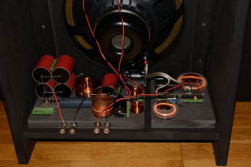

It is a bit strange with this Cap discussion…..because in speaker crossovers many people swear (experienced audio people) that a bipolar E-cap in the signal for middle or tweeter would destroy the sound totally and the bipolar E-caps should only be used for some corrections of impedance. Also in tube amps people pay maybe $1000 for a V-Cap as coupling cap. Do you have the same relaxed relation to only using bipolar E-caps for speaker crossovers? …..the price difference may be 1:100 compared to using expensive film or foil capacitors. I know it is a bit "off topic" but an interesting "off topic" 🙂
Zen way...I have a "relaxed relation" to just about everything. 🙂
The person who designed my speakers don't have same relaxed relation to E-caps in the signal path:
Alumen-Z-Cap
….so I followed his layout for the cross-over. It works…..but I don't know if I could hear the difference if I was more relaxed regarding which caps to use…..hope MoFo likes my speakers...…..and don't burn them…..
Alumen-Z-Cap
