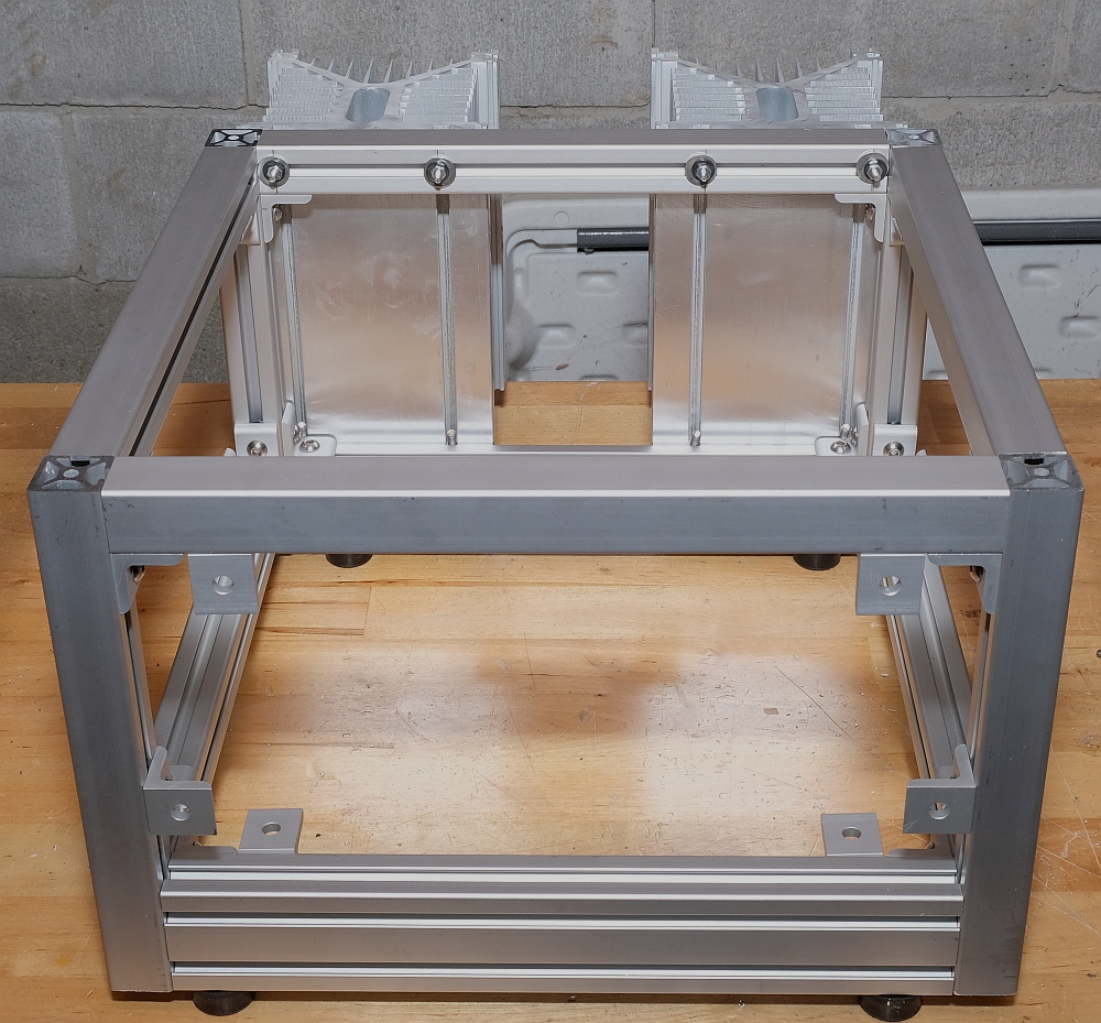

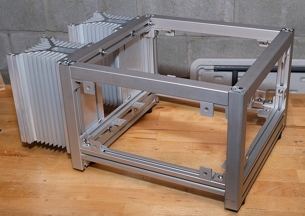

Vunce, here are a couple of chassis photos, I have never gone this route before, usually bought from the Store.

Thanks Vunce. The heatsinks came from China, only 15usd each, the gotcha was the shipping. Total for both was about 100usd. The ones Michael used, I believe are about 65usd plus shipping, so some savings there. All sides will be wood. The bottom is 5/8" ply and the remaining sides will be stained 1/8" (3mm) ply. Per your suggestion of venting in the top, I am going with a brass screen inset from McMaster-Carr.
Eric, that is extruded aluminium stock that you can buy from a number of sources around the world. 8020, T-Slots, Parker, Bosch, FrameWorld, MainFrame, Maytec, T-Nutz.
I have used both 8020 and T-nutz on other projects. 8020 has an Ebay store with items a bit less than their regular prices. T-nutz is even less expensive with fewer choices, but they offer precut pieces.
The frame in my photos is all T-Nutz 12" pieces, except for the four vertical pieces which I cut from some 12" ones. All of the hardware came from T-Nutz and McMaster-Carr.
More photos to follow as move towards completion.
