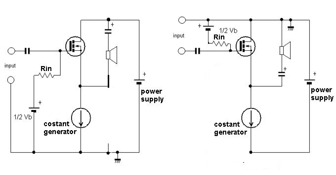

question about the output cap:
in signe rail PP amp the output idle voltage is at 1/2 Vrail so the output cap is always porlarizedi in the same way, an electrolitic can be used
in the MoFo the output voltage is around 1V (very low resistance of the choke)
when it swings with the audio signal, will the polarisation if the output cap be reversed? do we need non polarized electrolitic?
Is-it better to reference the output (and maybe the input too) to the +V as done here
the Power Folllower

input reference - pretty much always ref. to side where source of mosfet is ;
in fact , disregard that sentence ..... it really depends of particular case
and , it's wise to arrange that GND is on same side , just because gnd is usually cleanest rail in system
though .... where to reference load is another issue
looking at left side of pic you posted - "normal design" - input is flawless , speaker return can be moved from gnd to drain of mosfet for some benefits
looking at right side of your pic -"exclusive design" - only speaker is connected in best way ....... input side is very troubled ...... move generator marked as 1/2Vb to gnd side , and everything is suddenly OK
I'm surprised that we can't see anti-parallel resistors there ....... :devilr:

Fine, but PSRR will go down, not up in the case of MoFo. The drain of the MOSFET offers much higher resistance than the inductor. The inductor is not a constant current source.
I have run various choke loaded output stages with BUZ900P , RD16HHFN1 and Semisouth 085 . Subjectively I found the sound a lot brighter with the output connected across the MOSFET each time I tried . I preferred taking the output across the choke . Chokes used were the Thomas Mayer specified LL2733 700mH/175mH
You are right about PSRR . LCLC supplies are the way to go :)
