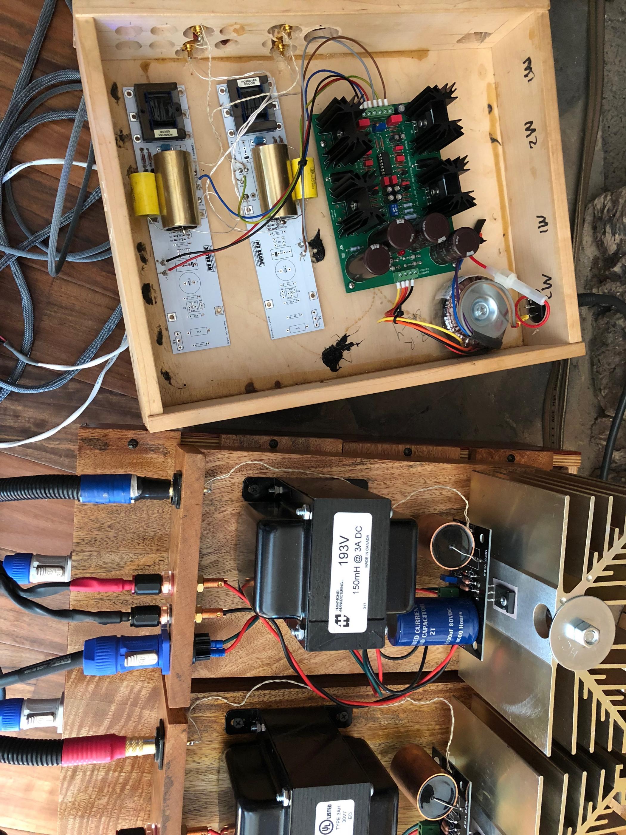

Big MoFo with M2 buffer
I believe ZM suggested that to get additional gain for the MoFo use the FE of the M2.
I inserted a M2 FE between the my XP10 and the Big MoFo. Gives me the gain I need and initial listening makes me want to continue listening (and experimenting)
Thanks all
Best
Bob
ZM - more from my heat sink collection - I like these and will use in my next ( and final ) amp 😉

Very nice Bob!
I am on the same path. Currently using Altec 15095As as autoformers in M2 style in front of my 12 volt MoFo. It is a very nice pairing.
Also, the B1 transformer that NP displayed at BAF is basically the same as the M2 front end.

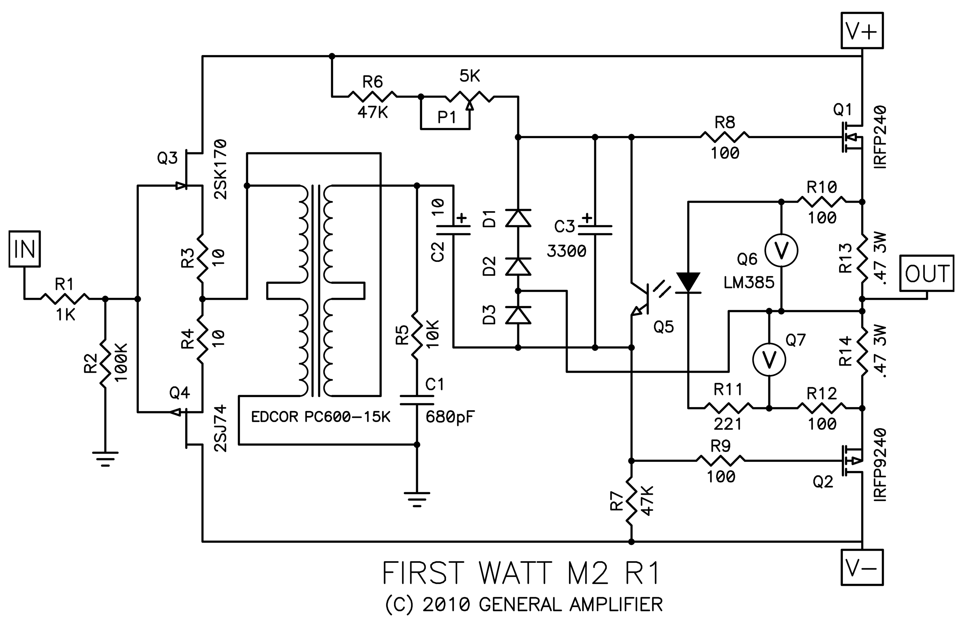

Can you analyze a little bit this for the beginners like us. What is FE of M2 & XP10 ?
I used the attached schematic which was posted by NP in the M2 thread.
I needed a bit more gain than my Pass Labs XP10 provided, The M2 front end has provided this for me. As pointed out this could also be done with B1 XFMR unit
On the Tea Bag M2 board I populated R1-R5, C1 and C2, Q3 and Q4 and the Edcor PC600.
Output was taken after C2
24V regulated was provided by a supply I had available.
Hope this helps
Nice soundstage both in width and depth. Very involving - makes you want to listen - good detail and female vocalists sound great
