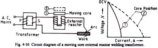

What is it you find improper? Magura's and your very own 25 lbs air core ignite the diy spirit of others into blazing bushfire. It is only a simple visit to his friendly neighborhood winder to see what is available. Hopefully he finds or is able to commission a pair he is happy with. Some old school moving core reactor AC arc welder do have cored chokes with gap adjustable through an external handle. If he is really lucky, he could end up with a pair of monumental audiophile approved, real He-Man chokes good for up to 600A.:p

No Mr. MR sir, you did not say improper. Here in Indonesia, inductors are readily available off the shelf in air core crossover value variety, larger like the cored 50mH 2A for the MoFo need to be imported or specified and commissioned to a winder shop. I suppose inductor availability is pretty similar throughout South East Asia like Malaysia, Singapore and the Philippines. The welding choke bit is intended only to contrast the itty bitty SMPS filter choke he posted in #691.:)
